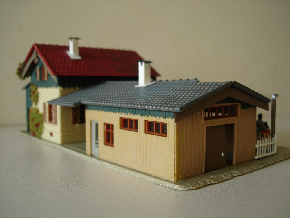

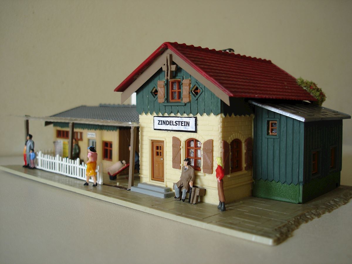

This is Zindelstein Station which I bought for a couple of pounds - no platform canopy, supports and fencing, chimney missing, station sign torn, broken roof snapped at the rear, no eaves, no side door - barely recognisable as a station. First photo shows it. Downloaded a picture of the box on the web which shows what it should look like so I'll post that and some of the packaging materials I used to restore it - and other materials I have used for projects (for glazing, roofing and inner shells). Then a few views of Zindelstein Station (if I can - my first post so hoping for the best). If there's room on the post I'll add some photos of buildings made for my English layout, a chapel and some huts and stores made ENTIRELY from food packaging. The basic ideas may be of interest.
ZINDELSTEIN STATION: -
- The see-through platform canopy was made of sandwich packaging and the supports from split lollipop sticks.
- The fencing - some unused Wills kit I had knocking around.
- The eaves were cut from food packaging and mounted on sections of matchstick glued underneath the roof.
- The broken roof corner was repaired with a piece of chilled food tray, modelling putty applied on top of it, then modelling moss glued to it - dabs of red paint. Additional moss to the wall to simulate a climbing plant.
- The ornamentation for the eaves (the cross) is cut from a piece of disused Hornby plastic sleeper, painted to match the eaves.
- The waiting room side door is simply a piece of plastic packaging glued behind the aperture.
- Removed the existing chimney and split it and used half for the missing chimney on the main building. Added flashing to hide the holes at the bases.
- Created 'ZINDELSTEIN' station sign on the computer - mounted on a small section of food tray.
- Benches - simple affairs made with small pieces of discarded plastic (I save all kinds of throwaway plastic with interesting shapes and mouldings).
- A few little people and Bingo!

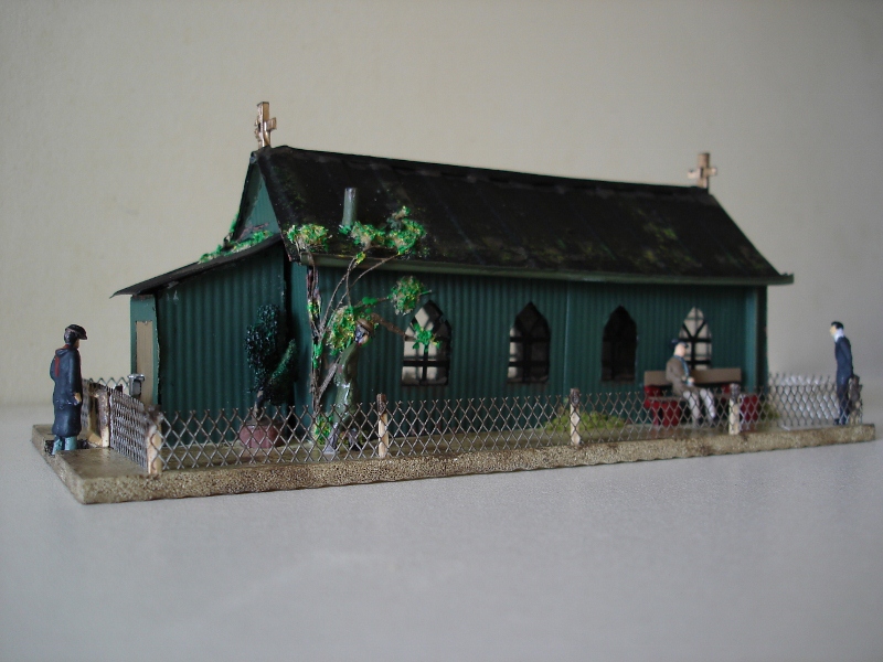

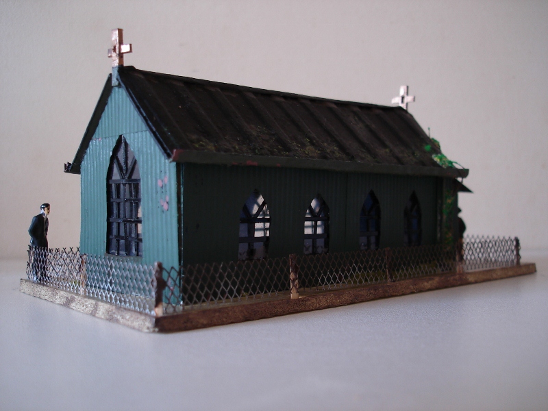

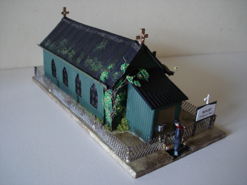

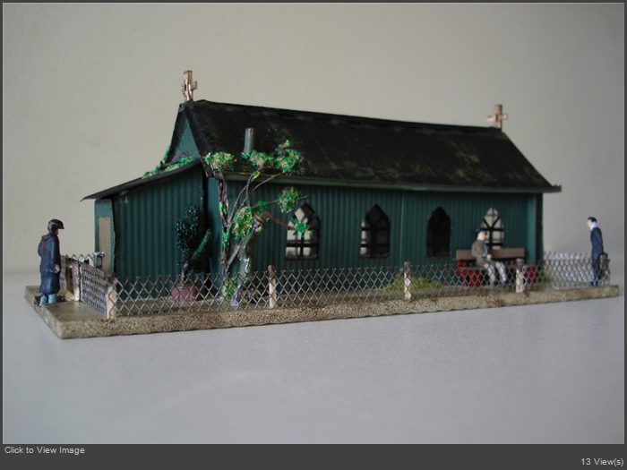

I will experiment and try to download another pick after tampering with it. If it works, this is a scratch built derelict corrugated iron chapel from my English layout. It's constructed entirely from scrap materials and food packaging - namely -
- Corrugated iron - lining plastic inside many boxes of biscuits and cakes - particularly German! Lots around at Christmas (photo above - earlier). Warped it slightly at the edges so I could grow ivy out of it!
- Very thin - so glued onto a shell constructed from a chilled ham tray, window shapes cut out, glazed with chilled cheese container! Tiny strips of thin plastic glued behind the glazing for the window frame and cross members. Frame constructed onto used matchsticks at the corners. A standard matchstick is exactly the height of an HO/OO scale single storey building!
- Roof - a mushroom container. The ridge and guttering - curved edges of a chilled food tray (you can bend these to increase the curve) applied to the roof. You get fantastic mouldings on these food containers - free plastic sheeting as far as I can see.
- Down pipes - piece of old Hornby rail.
- Roof Crosses - cut sections of disused Hornby plastic sleeper - painted gold.
- Fence - old mosquito wire netting (you can buy it - very cheap) - posts - split wicker from an old wicker basket (fabulous stuff to use for model railway - doesn't perish, cross section looks great, paints well - use it for chimneys, log piles, wagon log loads - all sorts of things. Got a dirty clothes basket which is falling to bits and shedding it - will last me into the hereafter!
- Benches - scraps of plastic and strips of food container. I NEVER pay for these!
- Base - built onto a pizza base, cut to shape. These are high density polywotnot - cuts cleanly, strong yet easy to penetrate if needed. Fabulous resource.
Nice thing is that imperfections improve the model and add to the look of dereliction.
So the whole thing was made for the cost of the paint. Thanks again for your help and warm welcome, fellas.
Best. Roger.
