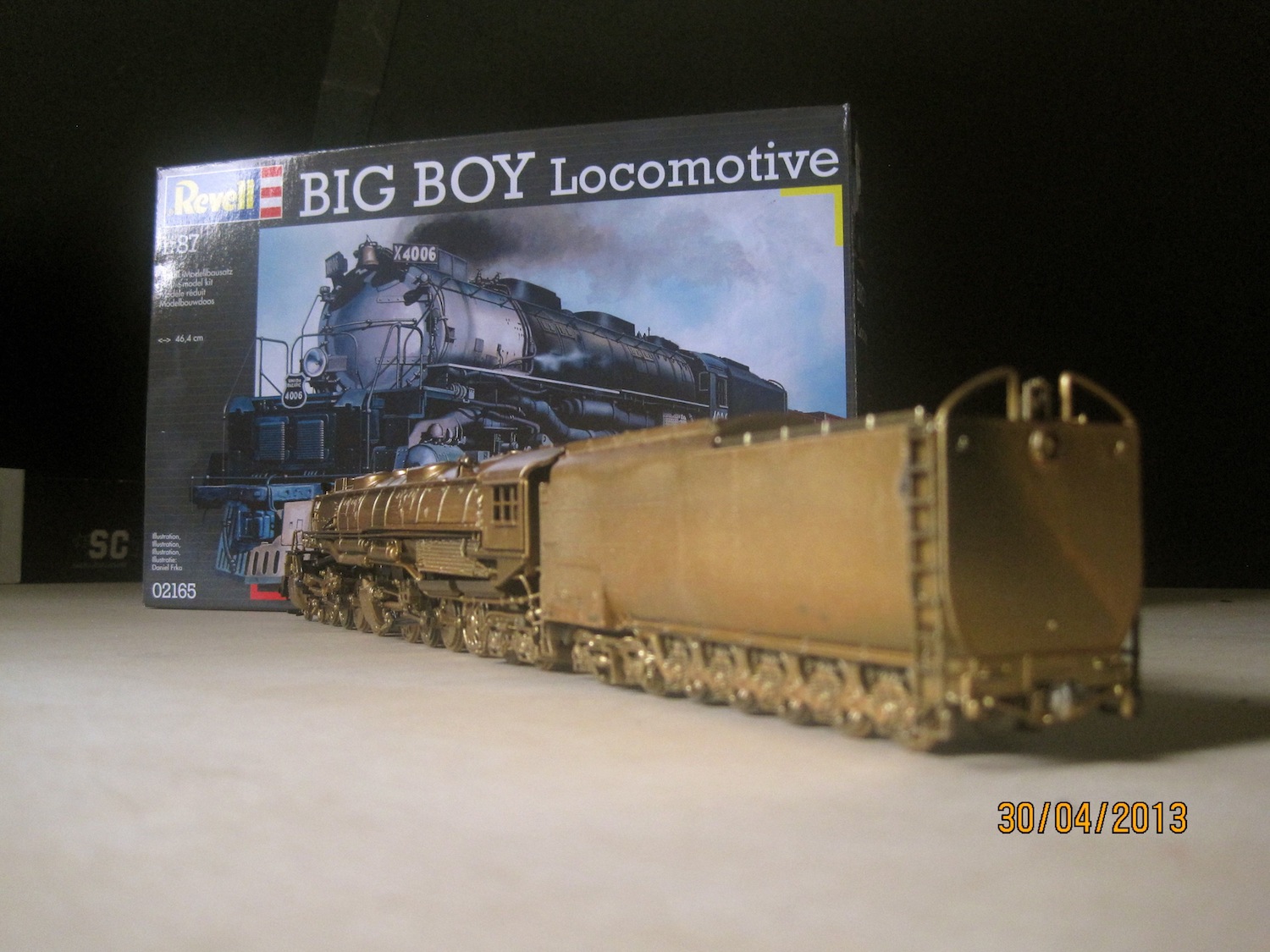

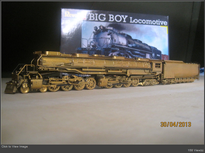

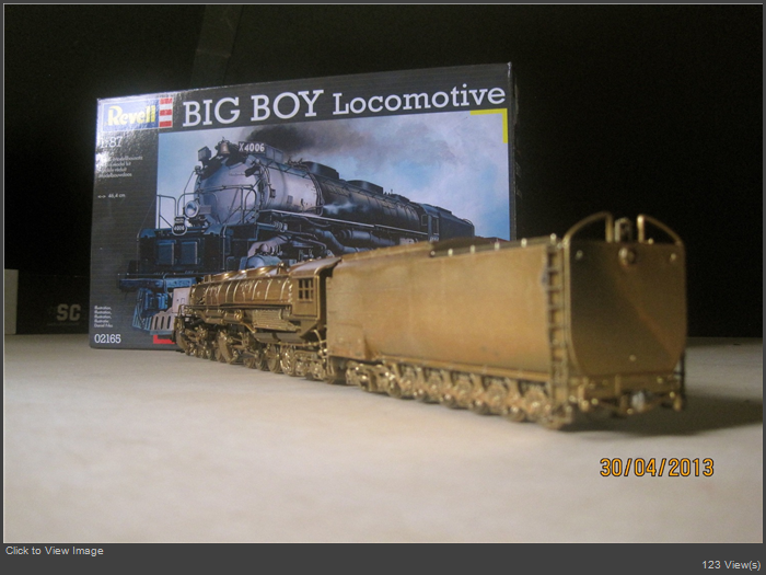

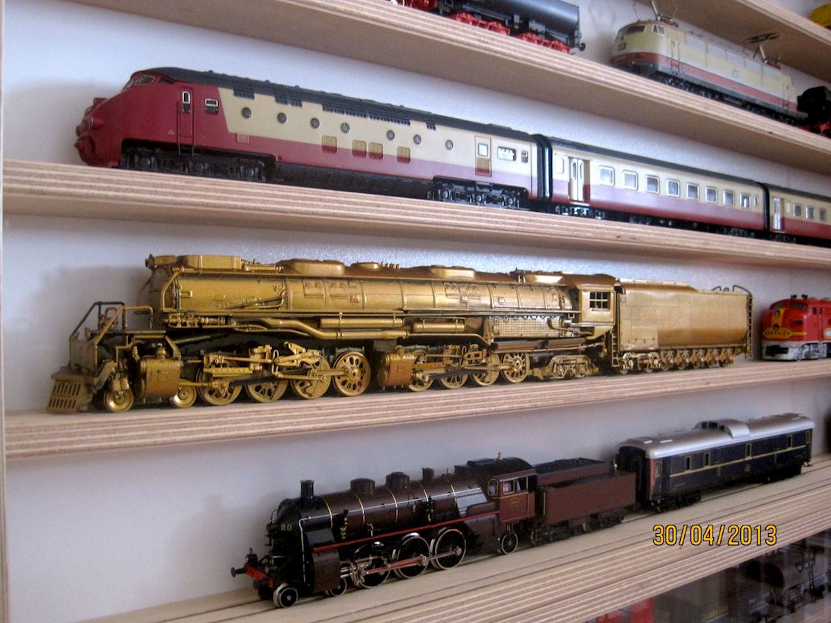

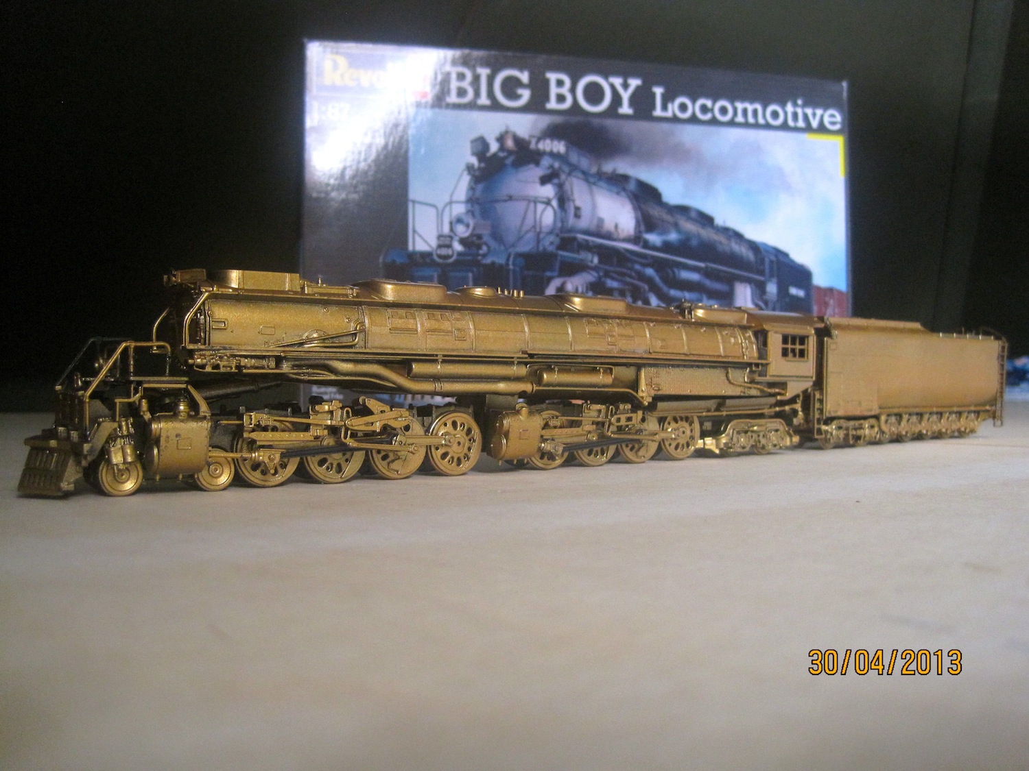

My version of the Revell/Monogram kit of the Big Boy,scale H0.
The Big Boy has few flaws,if there is one it must be that the color black makes it a rather dull model,as goes for most black steamers.
As such i opted for a brass look,using a Humbrol No. 54 spraycan.
I always liked the Japanese brass models of my youth.
This is not an easy kit to build,there are some fragile parts which easily snap.
The building instructions are not entirely correct,the instruction about the tender coupling is wrong,there is no reference to fitting the air compressors on the forward wheelframe.
I found that one Humbrol spraycan for such a big kit is not sufficient,it is perhaps better to spray with light grey first,thence apply a light coat of brass.
I reckon the model in its current state requires another one or two brass spraycoats.
Monogram sold it as a no glue snap together kit,in my opinion it is better to glue and keep it static.
Also,it is difficult to align the wheels on standard Maerklin track,something to consider when pushing the wheel sets together.
All in all it is not a bad model for the money,some Euro's 20.- in Holland.
A Humbrol spray can comes at Euro 6.- each.
Now there is one more thing left:keep saving money for my next Maerklin Big Boy!

#2 Posted : 30 April 2013 20:54:17(UTC)
Posts: 6,775
Hi Paul,
Wow, that is one impressive, very presentable model. I really like the idea.
