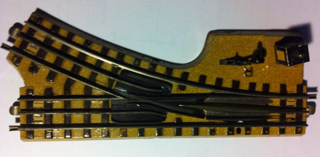

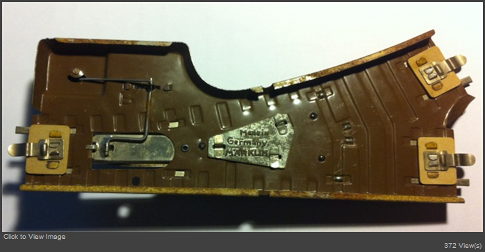

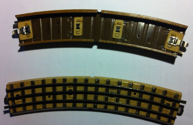

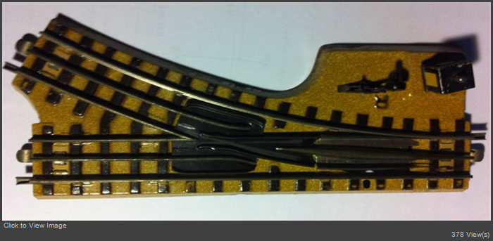

Hi everyone
I am not sure whether I should have started a new topic. Blushing
I have some old Marklin M track and was wondering if anyone on this thread could assist in dating the M track in the pictures below
I picked it up from a rubbish / second hand box at my dealer and am intrigued as to its age. I have looked at the following site but am unable to decide which one of the examples is correct.
The rails are solid brass with a hollow solid centre track of tin. To my mind the colours match the 1936 examples on this site. The colours did not come out all that well in my photos maybe the colour on the underside of the points is closest to the real colour.
http://marklinstop.com/episodes...in-00-ho-track-1935-1950

Hi Mike, I agree that it does look like 1936 series from the colour etc. Good score. I have a bunch of it myself and I think it's neat.
But.... got something suitable to run on it??

Hi Mike,
The track is 1937 to 1939.
The 2 securing holes for the tracks are inside the rails and moved to either end.....1935 and also 1936 have the 2 securing holes in the middle of the track section and also outside the rails.
Also the 1935 and 1936 tracks do not have exit holes in the track beds for cables.
Hope this helps identify the track.
Ian.

Thanks Cookee, Ian and Soest for your assistance. I missed the detail on the track mounting holes as well as the exit holes for wiring.
Looking again I agree with your assessment Ian that the track is probably at earliest 1937-1939. With the quantity of 1936 track that you have Ian I am looking forward to seeing an impressive layout.
As regards rolling stock for that period Cookee I need to find the rolling stock I bought around the same time that I acquired the track (same dealer so probably came as a job lot). I will post some pictures over the weekend. Most of my rolling stock is packed away until my C track layout is complete. When my wife and I start on the scenery I will be able to mount the M track and set up a separate small analog layout. I would like to get some more track as well as a period analog controller and some tin plate stations and other scenery. I already have a turntable and tin-plate loco shed which should go well on a layout I have in mind.

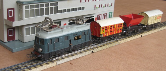

I found the rolling stock to match my old brass track and took some pics with my wife's camera - very much better quality than my cellphone! She told me so Blushing Blushing
I think the RS800 and first wagon are post war but both of the back 2 wagons are pre war. The Gambrinus beer wagon at the back has a KK1 coupling which dates it in Koll's to 1937. The red gravel wagon has a KK3 which dates it to 1938/9. These are the oldest pieces in my collection.
There are a number of different vintages in my track as if you look at the colour of the roadbed it varies with some of the roadbed more yellow than others. The brown on the underside is also a different shade.
I have cropped the top of the clock tower on the station as unfortunately I am missing the roof. I will need to make one when I get around to my analog layout.
The DA800 is for Ian's benefit. There are 2 more in my display cabinet plus a number of other analog steamers and crocodiles. I have not counted my analog locos.
