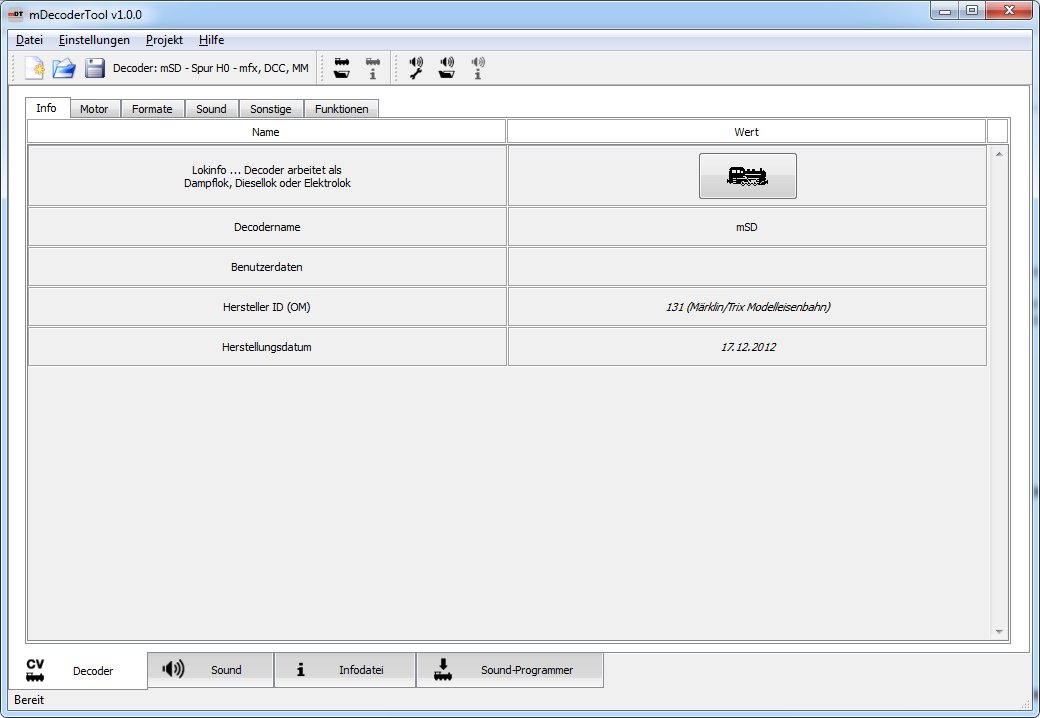

Has anyone try this tool yet ?
mDecoderTool
I am download soundlibrary right now 280MB, will be interesting what's inside Cool

I Have already installed the mDecoderTool-Software from Marklin and it looks very good from my point of view.
But take a look yourself at the pictures i have uploaded :
FrankF attached the following image(s):
CURRENT MARKLIN SOFTWARE/GFP/FIMWARE - UPDATES:
• CS3+ 60216 SW 2.5.2(6) • CS2 60215 SW:4.3.2(4) • MS2 (SW 5.3) • 6011x GLEIS-BOX (GFP1.70) • MS2-WLAN (FW 5.4.0.21) • 60117 WLAN-BOX (FW 0.3.0.2) • MS1 (SW:1.8 AP) • S88 LINK (SW1.1)
• MDT V3.6.0 (HW: 60970/60971/60801) • MLD3/MSD3 (FW 3.3.6.2) • MSD3.5 (FW 3.5.1.1) • 1098 MLD3/MSD3 DECODER-PROJECTS ON M-SERVER • MARKLIN SOUND-BIBLIOTHEK ( 33.744 SOUND-FILES )
• LOK-PROGRAMMER (SW5.2.13) • ESU HW (53451/53900/53901)
thanks 3 users liked this useful post by FrankF

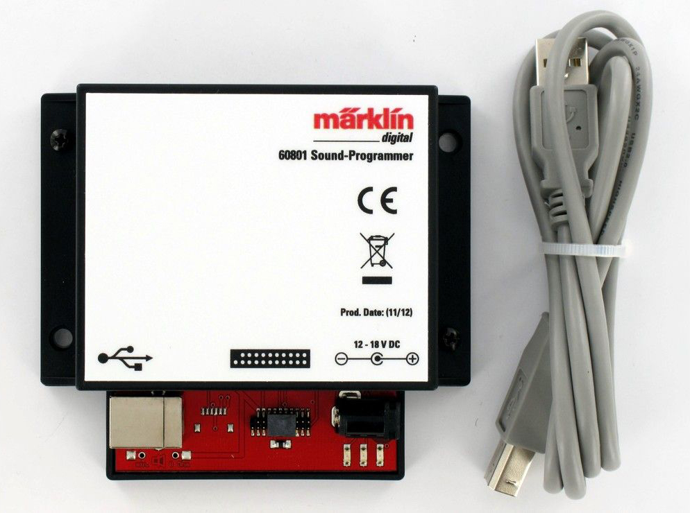

That's for the new 60801 Märklin Programmer (Com1 doesn't sound like USB, sounds like a legacy port).

Anyway, once you have programmed with Marklin sound programmer, I think you can use the ESU test board....
Two wires from a piece of track connected to MS2
IMO, the ESU test board should be compatible with any kind of decoders....Only one thing must be checked : the impedance of the speaker installed on it. (Must be similar to Marklin speakers impedance)
It seems that ESU made it more or less for shops or workshops. As an enthusiast I find it somewhat useless ...we cannot get the same sound as a speaker is mounted into a lok....
Our Loks are the best Test board of the world....Wink

I think that having the direct 21MTC connection will be a big advantage. I'd imagine programming with this must be much quicker than with the CS2. The data rate over rail is very limited.
About programming, electrical contacts must be perfect, that's why programmation track and wheels have to be clean.
Yes, direct MTC connection is advantage over the ESU Lokprogrammer as well. (over many other programmers too)
