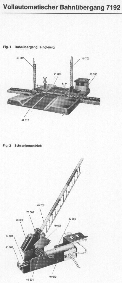

I have one of these 7192 crossings, have tested and it works fine, but I am going to sell it and would like to include a copy of the original leaflet if I can. It's boxed so it would be a nice touch.
A scan emailed or posted here would be fine, and only need the English pages and diagrams. This particular one has a box printing date of 04 63, so if I have a choice, around that period would be perfect.

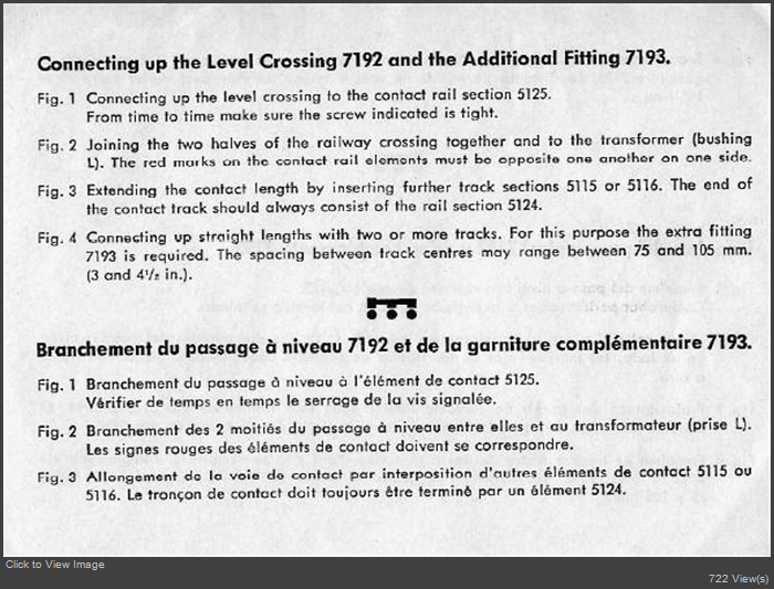

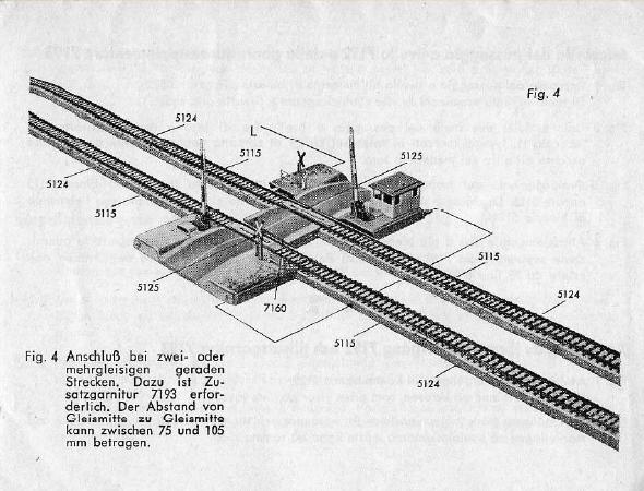

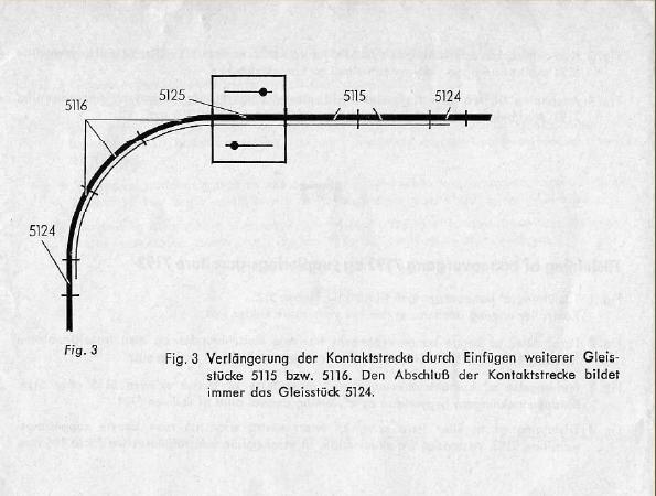

New to the forums, rediscovering the hobby after finding my old train from 30 years ago. Wonder if someone can post specific instructions re. the installation of 7192 crossing and any other pieces needed? 5115 tracks? The set has two short pieces similar to 5146. Not sure how to hook this up without burning it up! Help appreciated. Thank you. Drool
#7 Posted : 20 December 2012 04:36:11(UTC)
Posts: 4,088
Originally Posted by: Philipj Go to Quoted Post
Hello to all..
This is what I was kindly sent after my query (Thanks Markus), pasted in here fyi, english text only.
