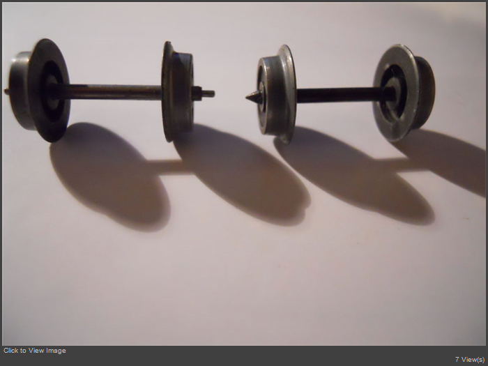

Offline Hoffmann
#14 Posted : 06 December 2012 03:47:08(UTC)
Hoffmann
Joined: 25/11/2004(UTC)
Posts: 1,106
Location: Guelph, Ontario
Hello Mike,
It crossed my mind as well that the Wheels may not be the proper one for this car. However I checked all my Wheels I have in stock and the one from the 27cm car may work but not for long.
See Picture of the two types of Wheels.
Hoffmann attached the following image(s):
marklin-eh
Offline ari1982
#15 Posted : 06 December 2012 17:55:38(UTC)
ari1982
Joined: 23/08/2012(UTC)
Posts: 59
Location: San Francisco
my cars have the wheels on the left. I'll get to sit down and fix them this weekend.
