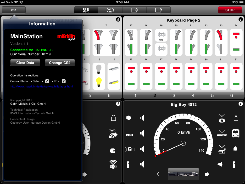

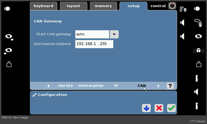

Here's the screenshots from my setup:
It sometimes takes a few moments for the iPad and the CS 2 to start talking to each other.

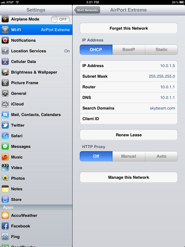

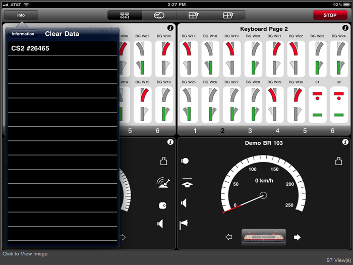

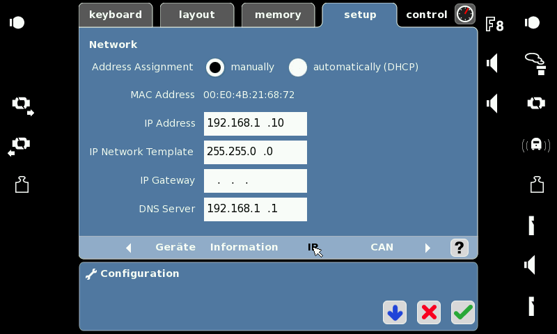

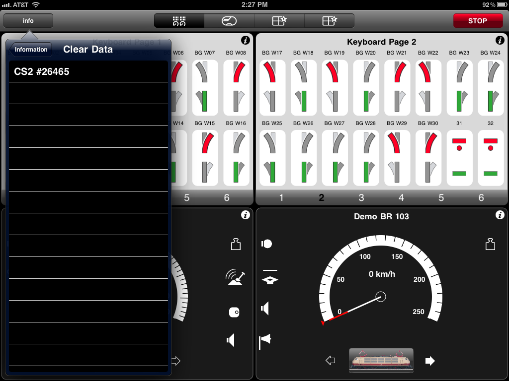

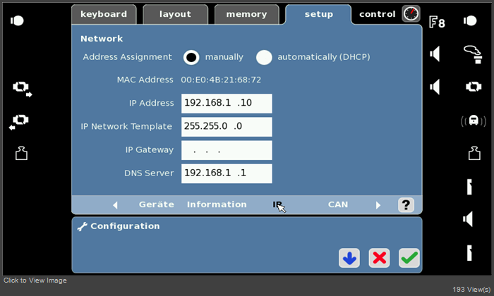

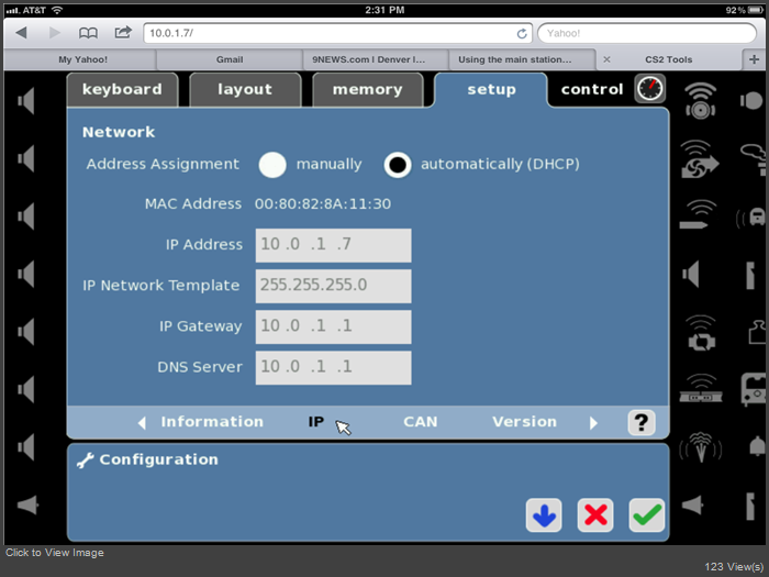

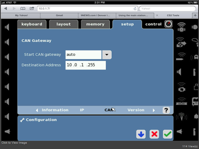

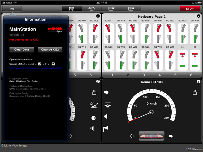

Alright. So here are some screen shots showing my CS2 settings:
Here are the network settings from the iPad:
Here is some stuff on the main station app. As you can see, the app does not connect to the CS2, but it clearly recognizes it, as can be seen in the second picture, as it has the option to delete al the content on the CS2:
Thanks,
-Jonas

A manual IP address is definitely not a stupid thought...
I've used both but the manual seems more reliable and better if you wish to ping it!
I'll try to find someone with an iPad 1 that I could test out myself.
Daniell

Hmmmm... So I got the new iPad, but the Amin station continues to crash, refuse to connect, and all. However, the mobile station app continues to work just fine. Any suggestions?
Thanks,
-Jonas
I have a basic principle at home... Fixed IP:s for stuff that is connected to the LAN, like server, CS1, CS2, desktop computers and other things that may need to be remotely controlled.
DHCP only for wireless clients like iThingies, laptops, phones and such...

Location: colorado
Can anyone help me with the app? I can send you the iPad spec's and all, if that helps. The mobile station app continues to work just fine, but th main station just crashes every time, after about five seconds.
Thanks,
-Jonas

Probably best to contact the developer of the main station app (i.e. Marklin) for that sort of help.

Another idea I can think of is to turn the iPad completely off and restart it, that's usually my first computer troubleshooting tip! If you have no luck with that then remove the Main Station app, restart the iPad and reinstall it...
Also I've found it pays to restart the CS 2 after making any changes to the IP settings.
Daniell
P.S. - Just like Webmaster, I also do the same thing with manual IP addresses at home. It makes using VNC and Remote Desktop so much easier!

Here's something I'm finding interesting. When I'm not on the same network as the CS2, the app works just fine in demo mode, but when it's with the cs2, that's when it starts to crash.

That's interesting to note...
If that's what's happening does it still crash if its set to Flight Mode?
I had a similar experience with the New Zealand Herald app on my iPad. We had a school trip to Wellington by train and usually if it can't connect to the Internet it defaults to offline mode. It was not connected to any WIFI network at the time, however it did have a Austrailian SIM card from a trip to Melbourne. (It had 3GB included for AU$30 that could only work in Austrailia... I wasn't going to pay $0.1/MB to use it at home). It crashed on opening every time until I got connected to my wifi network at home.
Is your iPad a 3G model? If so does it make any difference removing the SIM card?
#40 Posted : 11 November 2012 19:33:06(UTC)
Posts: 11,165
You can of course surf the Internet and such with the iPad via your home network, right?...
Sorry for that stupid question, just want to make sure we have home network connectivity...
If it's an iPad with phone network access too, turn that feature off in the settings... Bluetooth too...
The App may be confused if there are more than one connectivity option available to use for connection...
I know these are obvious things, but I have to ask...

Officially display mirroring on the iPad 1 is not supported, it only enables playing of videos on an external screen.
You'd have to jailbreak your iPad which I wouldn't recommend doing for the fact that it is more likely to create more problems than it solved...
If I can find a friend with an iPad 1 I will test it myself.
Daniell

Originally Posted by: muddmover Go to Quoted Post
Nope. It's just a wifi.
Are you sure about that?
I noticed the iPad screenshots that you posted showed AT&T in the menu bar... That indicates to me that you must have the 3G model or was that the another iPad?
Mine showed either Voda NZ or Telecom NZ, (it changes because I have a Telstra SIM card from Austrailia) If there is no SIM in the 3G model it will say No SIM in the top bar, if its a WIFI only model it shouldn't show anything...
Daniell
