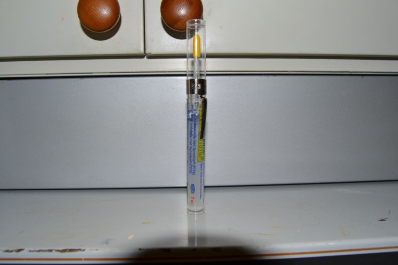

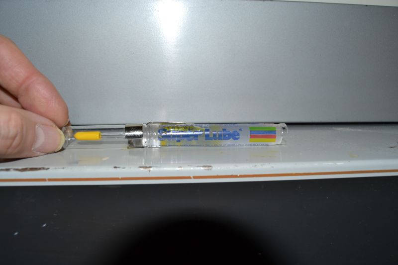

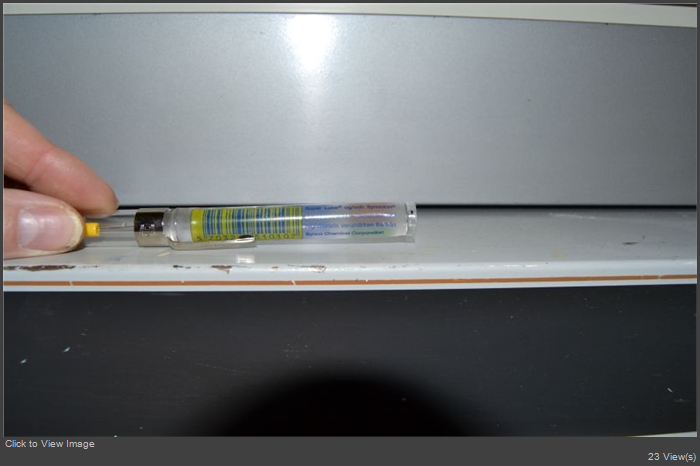

This is what i use to oil locomotivs.

I use a syringe filled with automotive multigrade oil, 20W50 to apply small quantities of oil where ever it is needed, this includes things like the garden wheel barrow, domestic door hindges etc., to Marklin rolling stock and locomotive gears and motors. If it can last up to 15000Km or more in my car's sump then I have no problem using it in my Marklin equipment at any time, which in my opinion is only a very light duty application, have not worn out anything yet in more than 25 years, I only lubricate when the mechanism needs it (becomes noisy) and then only a tiny drop.BigGrin
Hannes

Rolling Stock Lubrication
The secret is not to apply too much oil.
Edited by user 02 January 2025 06:16:37(UTC)  | Reason: Link corrected 02-01-2025
