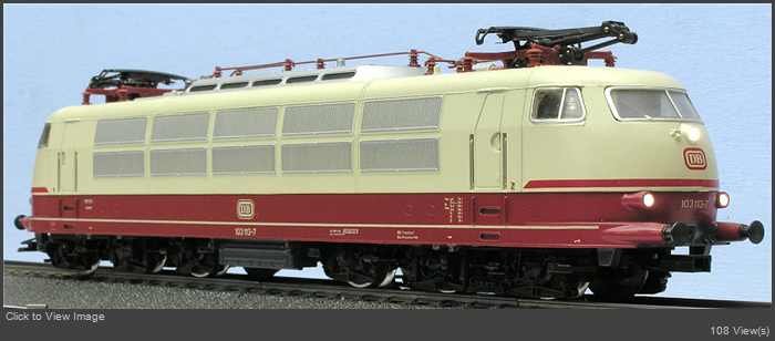

Few months ago I saw some shops advertised Fleischmann 2012 new items, and one of it caught my eyes; #437601 - BR 103.1 which was touted as "125th Anniversary of Fleischmann" item, with list price of 125 euro (DC, 2-rail, without decoder). So I thought; lets try how good the Fleischmann now, and I ordered one.
The locomotive is plastic body with metal chassis. Externally it is as detailed as today's modern MRR items, although most of the details were moulded, probably to save cost, e.g.: the hand-rails are moulded, instead of separately attached, even the lower hand-rails below cab's door were not even painted at all. The wind-screen wipers are silver colored, instead of black as on the prototype. And the lights are still using bulb instead of LEDs.
Upon disassembling the body, I started to feel that the build-quality and design is still not in par with Marklin. It is of cheaper design. For example: the screw go directly into plastic thread, unlike Marklin which put metal thread into the plastic to hold the screw (see photo below).
Fleischmann designed this locomotive to sit on two plastic bogies to hold the weight of its body. Whenever the locomotive make a turn, the plastic will slide against a recess on the metal chassis (photo below).
I do not know how long the plastic will last if the locomotive run on a layout, but as far as I know, Marklin always use metal to hold the weight of locomotive's body (although Marklin also use plastic on the bogies, but it has metal structure behind which hold the weight of the body). And I also notice that Marklin use mainly metal gears to transfer power from the motor to the wheels, but this Fleischmann locomotive mainly use plastic gears.
(Well, as this is a Marklin forum, therefore I hope it is appropriate to compare against Marklin).
This locomotive does not come with digital decoder, but equipped with 6-pin connector (NEM 651). So I decided to install a Marklin 60901 decoder since I have a few of them unused (photo below).
There is hardly any space to install a slider under the bogie, so I configured it to take the power thru catenary. The decoder installation was completed without any glitch, and the locomotive is able to run on AC 3-rail layout, passing R1 curves and switches (K and C tracks) smoothly without any problem with its DC-wheel. The motor (and gear) is not silent, but not too noisy as well, roughly similar to Marklin's Re 460 with high-efficiency motor.
But this locomotive is not suitable to my layout, because I use thin wire (SWG #30) as catenary, while the pantograph of this Fleischmann BR 103 is too stiff, exerting too much upward force into the wire causing it to bend and soon the pantograph will stuck into the pole. This problem may not be applicable to those using thicker wire.
Marklin BR 103.1 (#37577) has a list price of 299 euro, more than double of Fleischmann's BR 103.1, but the Marklin is metal-body, include decoder with sound, LEDs, and better build-quality. The Fleischmann #437601 is just a no-frill low cost alternative.
Photo of the cab section. The bogie is nicely detailed, although a bit marred by the shiny collector plate between the second and third axle.
The roof of the locomotive:
Head view of the locomotive, note the silver-colored wipers and the moulded handle. The wind-screen and windows are tinted, a bit too dark. There is a driver figure inside the cab, but hardly can be seen due to the dark windows.
Letter printing is excellent, crisp and clear.
View of under the chassis, showing two wheels with traction tire, and plastic gear on the driving wheels.
Inside the locomotive; a pcb serving as electrical contact point of the pantograph, and two light bulbs at each end.
The motor and 6-pin connector.

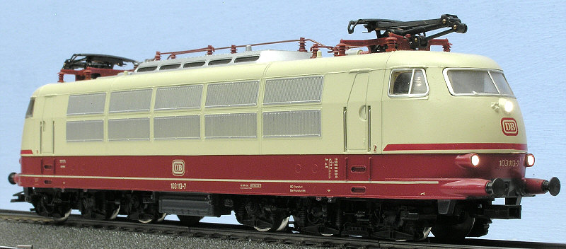

This is a re-run of an old Fleischmann classic - much like Märklin's blue box editions. This is not Fleischmann's state of the art, this is retro design.
Märklin has made models where the screw cuts directly into the plastic cover (the old BR 110.3 comes to mind).
With new locos, Märklin uses plastic trucks, plastics axles, plastic cog wheels. The BR V 80 and BR 185 are examples for that.
Where the Fleischmann 103 has visible collectors, the Märklin 103 has a visible cog wheel.
Märklin's 103 also is an old design (with some recent face lifts).
BTW: Märklin's model of 103 113 also has silver wipers - and with recent editions they still sometimes install the incorrect wind shields.
