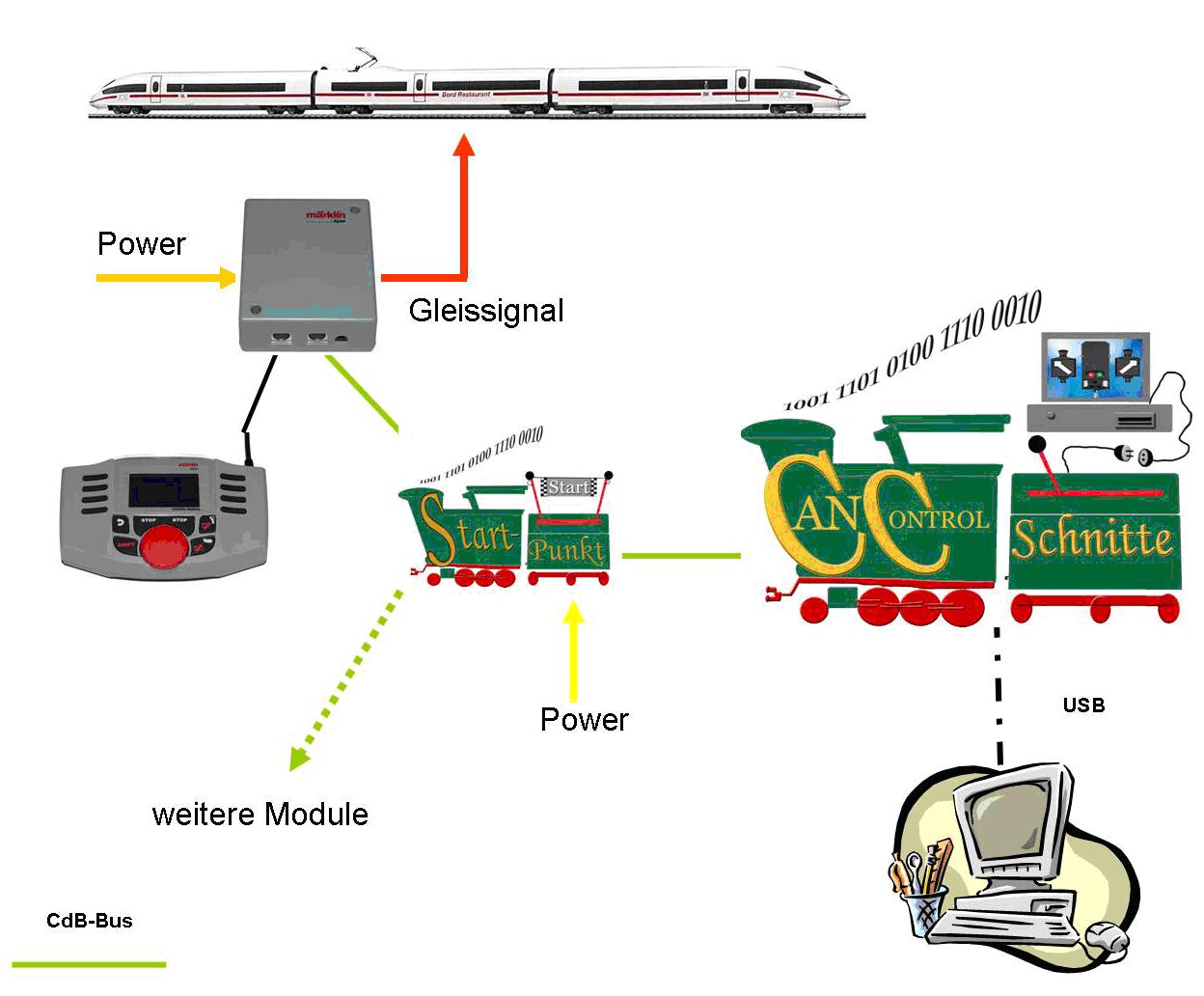

There is an interface called ‚CC-Schnitte 2.0’ which connects the MS2 (plus Gleisbox) to the pc and there are at least three control programs, Win-Digipet, ModellStellwerk and Rocrail which are free of charge as long as the demo-version will be sufficent. The fourth program that would work well with the CAN-modules is iTrain, but here the small version would cost some Euros.
Naturally feedback is possible if you use ‚StromSniffers’ for detection and if you need a booster, then there is the ‚ModulBooster’ available.

Your shuttle (and the whole layout set up) would be programmed with the help of a pc control-program. I would suggest that you first get the demo-versions of the mentioned ones and try if you like them. Rome wasn’t built in a day, so take your time before you make a decision. As there is already a link to Rocrail I have added the other links, too:

thank for the input. It looks like it can be done though. All you need is the Gleisbox (control box) that comes with MS2 or CS2 and 2 pcs of hardware named "CC-Schnitte" and "Startpunkt" which are available here
http://www.can-digital-bahn.com/news.php, finally a usb cable will take you to a pc with proper software (these people have also 2 software packages to go with the set). I have also read that RR and iTrain can work with this setup. Of course this is all theory until w have someone who has actually did this.
I will report if I have any actual confirmation on this or I will try it myself, hi!
Regards Manos

there is no doubt, that the CAN digital Bahn components work. I have only the StartPunkt to be able to connect a third MS2 to the Gleisbox. There is in meantime also an SpielPunkt to connect 4 additional MS2 to the Gleisbox.
Up to now, I don't need the PC connection, but it is the cheapest way to connect the railway to the PC.
Moritz

Ray it seems quite straightforward and they even supply the proper cables. I will give it a try as it is the best choice for computer control and do have many around doing nothing, hi!
Regards Manos SV1IW

As you nay have understand I am an absolute rookie so all I know is by reading and not from actually doing things. I know of one way to detect trains by using sensors (or contact generators) which actually send feedback to s88 decoders (60880 Marklin's today number), The decoder negotiates with the rail in which itis actually connected. All signals then are passed through the canbus (Rail->Gleisbox->start punkt->cc schnitte->pc) to the software to finally manage the trains. -If someone sees an error here, please correct for the benefit of all reading this.-
This is all I can tell for now. I would suggest to have a look ar RockRail program. The tutorial is very informative and it has also a demo set to check your understanding of doing things. Of course there are other software options which I will investigate in due time...Last but not least there may be other ways to detect trains as well. I am still investigating alternative ways frm the s88 decoder.
Regards Manos Sv1IW
