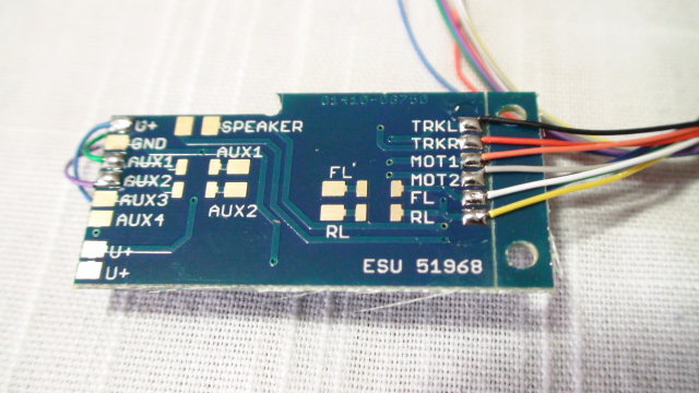

One question about NEM 652 -8 pin- and 21 pin interface (called MTC ). I shall put the decoder (very very possible ESU) in to M locos from the 70`and 80' or some 90'. In other way locos analogic o delta, no much more, not with the 21-pin interface from other older deco.
If I do not want to use the soldier, by this way no to heat or burn the decoder, I could use one NEM 652 female and male?

Yes. If space allows this, I would recommend to go this way.
ESU sells female NEM 652 plugs with cables (#51950). Cut the cables to the appropriate lengths, solder them to the loco, plug the decoder in.
The decoder has an extra cable for AUX2 (the fourth function output, not included in NEM 652).
If space is limited, you can buy the NEM 652 version of the decoder, cut off the plug, shorten cables as needed and solder them to the loco. Soldering takes place far from the decoder at the other end of the cable. No risk of frying the decoder if you don't drop the soldering iron.
MTC boards are a nice way if they fit - and they should fit if the loco has a Märklin mechanical reverse unit.

If you go down the road and purchase ESU deocders another aspect of a 21 mtc pin adapterplate is you can add another 2 functions (Aux3 + Aux 4) otherwise dedicated or programmed to F3 = Shunting = half speed or F 4 = acceleration & braking delay although these functions can be incorporated into your programming schedule any Aux function activated (Aux 3 + 4) will activate F3 + F4 as well or you de activate these functions.
For instance my ÖBB Rh 1020 has markerlights under Aux 4 and also the acceleration and braking delay, the markerlights would only be activated if the loco is solo, so in practice with carriages behind the Aux 4 would be off and your acceleration & braking delay would be therefore activated.
ESU is contemplating another adapterplate with alltogether 8 functions including the 2 light functions which will give you 6 Aux functions.
this would be almost adequate to add all the functions possible with a steam loco, for instance:

As Tom said this adapterplate can be used with any decoder providing it has a 21 mtc pin.

If I can understand right I should be soldier the wire from the motor, lights, etc to this adapterplate and then put de deco connected in to 21 pin.

This is correct, although the adapterplate has an instruction leaflet inclosed, there are also names on the adapterplate itself indicating which wire goes where

Dear John. Thanks by the photo and explain it so clearly. Mini: Thanks for let me show the right wait...to ESU. I appreciated so much!
