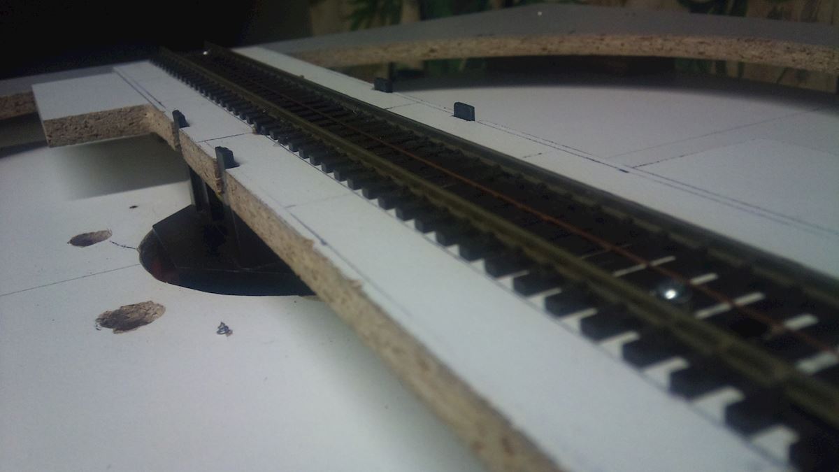

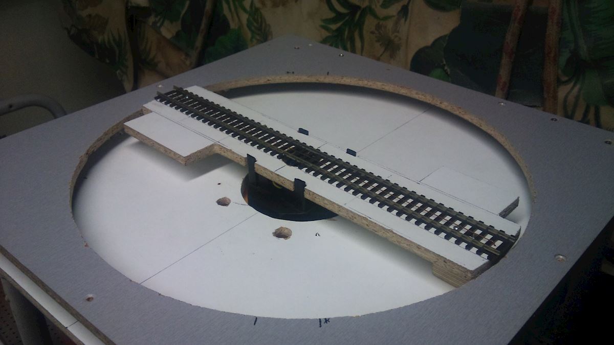

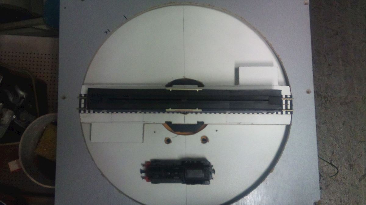

After a full day at my workshop, I am proud to show you the work I've done.
it's about a turntable. I'll add extra info as soon as possible.

Very good George. Is it motorised?

Nice turntable. It looks very solid. Are you going to paint it as well?

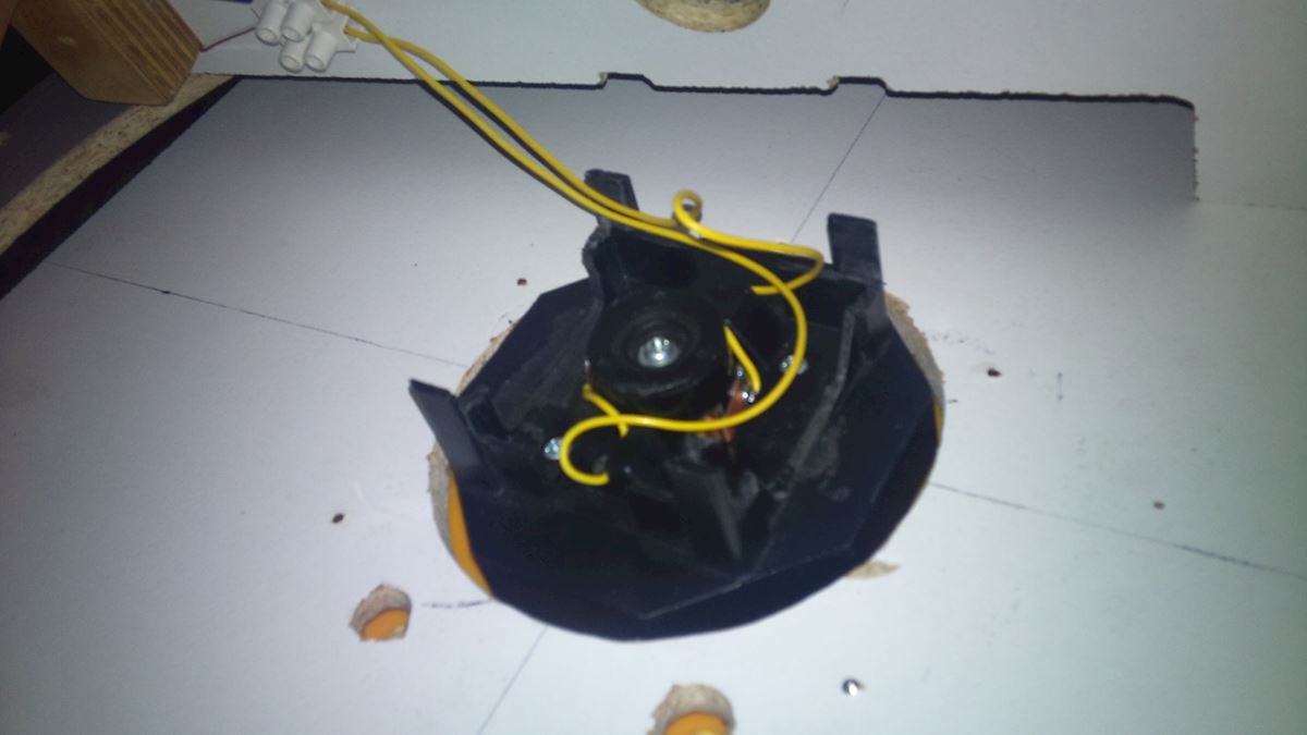

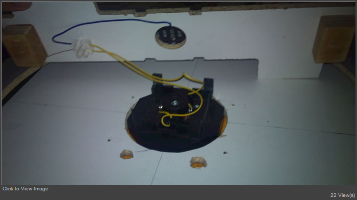

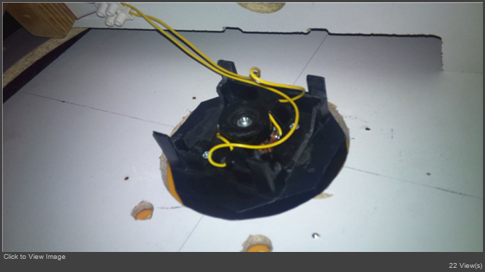

I have used the turnable mount of a game crane, that needs 1,5 volt to run at a scale speed,and also there are brush contacts to pass the electricity ,at the line of the turntable.

Looks great!How are going to index it?

well, "targeting" is going to be analog.

So i have to align reed switches at the end tracks, and use two magnets on the sides of the turntable in order to "read" the right position... so i can turn it manually until i get close to the one i want, and then i release it, but it will continue until it gets on the right posiition... very smart and simple , thanks :)
Or, I could possibly use some tamber swiches instead of reeds, for more accurancy...

1. You only need one magnet on the turntable. (The reed switches are shown in a straight line but would actually be wrapped in an arc).
Each track position needs a detent notch on the turntable to mate with a single roller mounted somwhere on the fixed side. That will
hold it in track alignment when stopped regardless of the turntable approach direction. There isn't anything to be read but by using a second or
a SPDT switch instead of SPST, that could then be used to say turn on a lamp on a panel board to indicate which track your at.
2. That's correct about the general theory of operation.
3. The switches with rollers would work, but by coupling both the mechanical position and the electrical motor stop into one might actually make it more fiddly to
adjust. With more rollers there would also be more stiction and friction to overcome on the mechanism.
4. For the reed design there would be one roller on the fixed side and a detent notch for each track. The detents to roller have to be made accurately
to position the track but can be mounted anywhere. Then a reed switch can be accurately mounted in front of the magnet to denergize the motor. It doesn't have to be on the face of the turntable, it could be underneath and the switches looking up, for example. Track spacing is not a factor it can be whereever you want it to be.
As the reed switches are a small glass tube and have to face the magnet they would need a clever mounting method (you have to be sure of proper operation before the epoxy putty dries :)
Let me know if anything is unclear.

I don't see why you couldn't use a single N.O. tamber? roller switch mounted on the fixed side and have the
detents for it on the moving wheel. The trade off is that the detent wheel has to be made perfect as it would be
a pain to make adjustable detents. In that regard it may be easier to use a N.C. reed switch as it's somewhat easier to
relocate a magnet.
I would probably recommend using a simple test rig to test things out,
then you can work out the best way to incorporate it on the real turntable.
One objective is to try to get enough detent force to reliably hold the track position without overloading the motor when moving.
If the switch alone doesn't hold the turntable stiff enough you could always add a second friction roller somewhere.

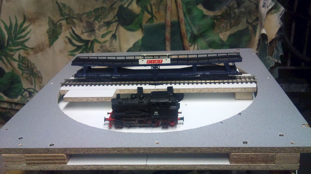

I think it is not easy to do, but one way of have enough force to keep the bridge inline with the exit tracks, is to have a hole below each exit track and have something like a turnout motor sending a small iron into the hole. The hole could be a little conical on the bridge side and cylindrical just after as this would facilitate the entering of the small iron into the hole.
An alternative to reed switches maybe for example an optical sensor under each track and have a LED (or some other liht source) under the bridge.
One thing that impresses me on your turntable is the bridge weight. I don't what it is, but it really seems heavy. With 3 pieces (at least) of plywood it could be lighter (depends on the plywood thickness, off course): One for the track bed and 2 horizontal below, one on each side. Probably you need some reinforcement in the middle...
