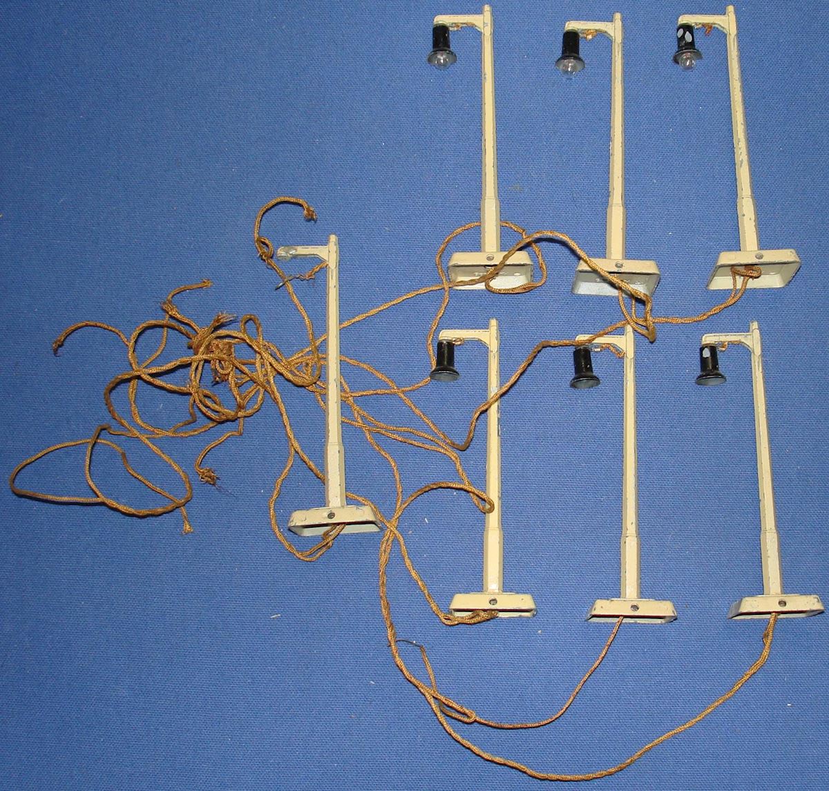

Hi Guys.
With all these new screw type bulbs available from china & the far east which bulbs are best for me to use on a vintage 1950's layout ?
For use in 418 station / 448 lamps / 424B canopy station ?
Thanks Neil (UK)
Huh
20-VOLT-AC attached the following image(s):
1950's Marklin Fan .

Hi Neil,
These bulbs are still available from Märklin:
E600100 - Glühlampe hell,19V- E5,5 10 pieces
15,00 € Recommended retail price(VPE: 10)
Markus

but the bulbs Markus mentioned are not the original ones for lamp 448, the bulbs are different in size.
The old bulbs (Märklin No 499 ) were 5mm in diameter ( screwing part, E 5) , the new bulbs are 5,5 mm (E 5,5).
This very small difference is the reason, that the new bulbs don't fit with many old sockets.
Wolf

I don't remember that I ever had such difficulties, but I mostly bought the bulbs from the BRAWA- assortment, they are cheaper at my dealer.
Marksu

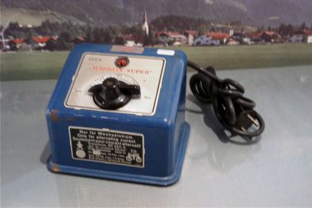

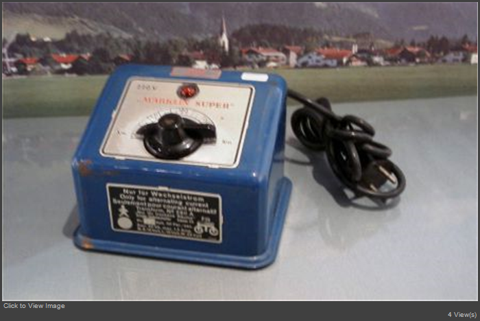

Hi Guy's.
Thanks for the knowledge on bulbs, how many standard bulbs can i run off one Marklin 30 VA transformer ?
I was thinking of having one transformer for lighting and power for electric points and another transformer for just running the LOKS.
Neil (UK)

Hello Neil,
I count 1 VA for each bulb ( also suggested by Märklin), thus 30 bulbs for one transformer 30 VA.
A loco needs - on average - 10 VA, therefor take one transformer for lightning and switching points / signals.
Wolf

One type of bulb is sometimes difficult to purchase: the white color.
It was used until mid 1950.
Unlike transparent bulb its glass is not glossy but with a matte finish.
They are easy to make yourself by using fine abrasive paper on the bulbe itself. It becomes white.
