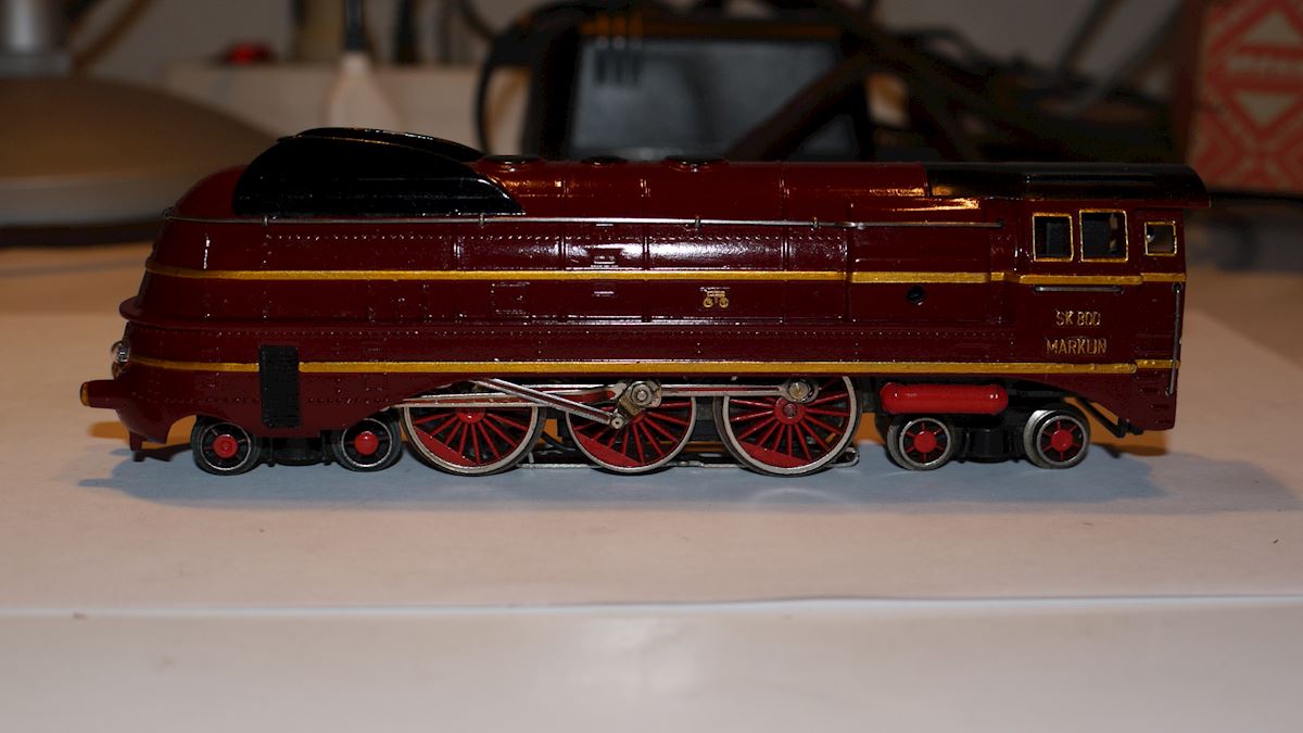

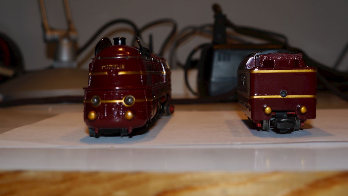

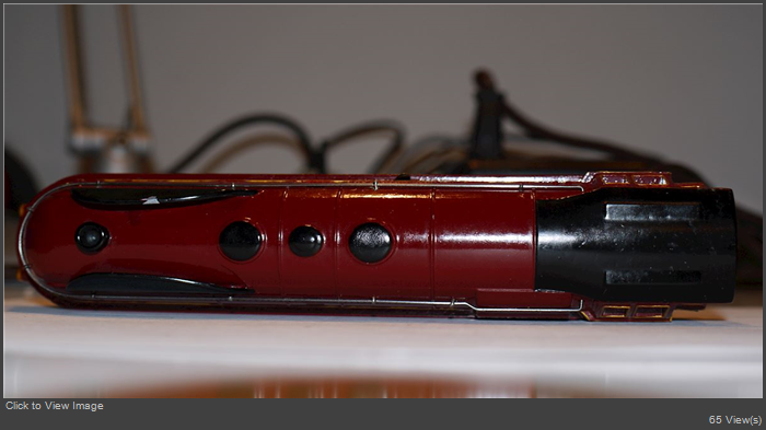

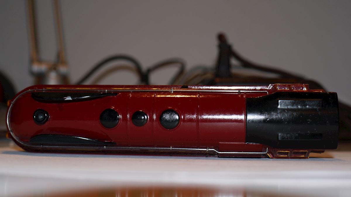

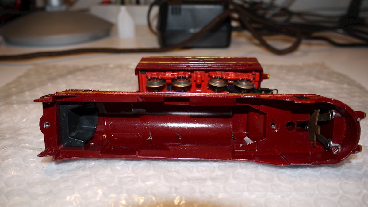

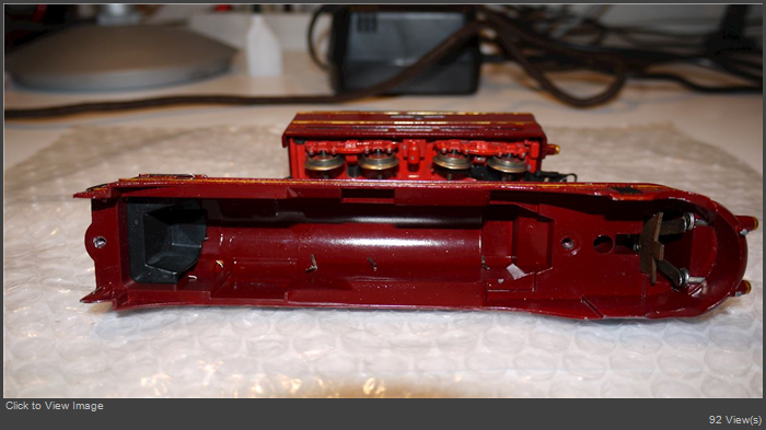

The photos

Offline LMS800
#6 Posted : 09 May 2012 10:41:49(UTC)
LMS800
Joined: 02/05/2012(UTC)
Posts: 162
Originally Posted by: smurfillo Go to Quoted Post
The photos
Hello Javier,

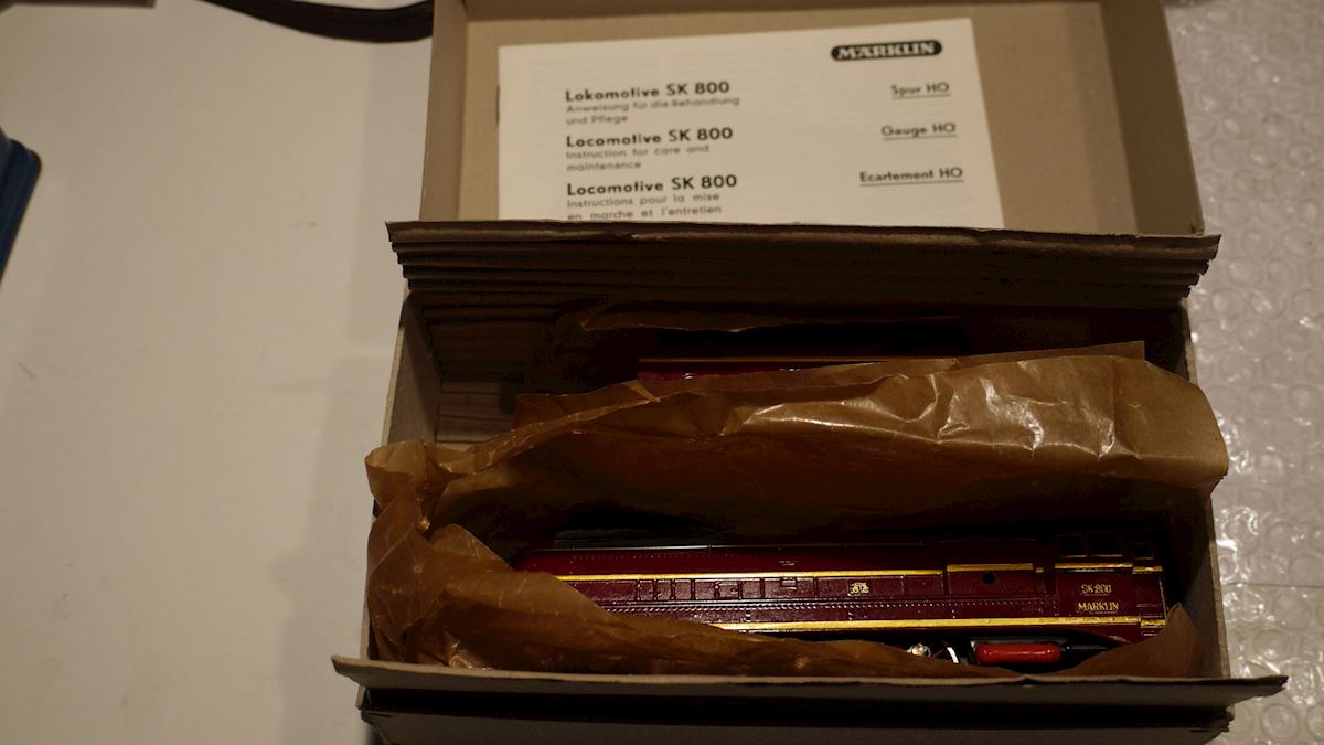

the loco looks very nice, but I am sorry to say , the loco is a "re-painted" one, original a black Koll-version 16 or 17. To distinguish between version 16 or 17 I have to see the wheels.
The box is an italian replica box, all boxes with an date like the one I have marked with a yellow circle are replica ones.
Wolf
Offline Iamnotthecrazyone
#7 Posted : 09 May 2012 10:49:45(UTC)
Iamnotthecrazyone
Joined: 22/01/2012(UTC)
Posts: 1,048
Interesting, there are a couple of things I don't like from it to be an original. Just to mention a couple of things. Most of the engines from that time that had a glossy colour paint they tend to have a bubbly appearance. The golden lines and for instance the round black domes against the red paint looks too perfect. It may be just me, I am sure there people with much more experience in that era.

Offline CCS800KrokHunter3
#11 Posted : 09 May 2012 16:24:43(UTC)
CCS800KrokHunter3
Joined: 03/04/2007(UTC)
Posts: 1,605
I agree with Wolf the model is certainly 100% repainted and box, instruction sheets, etc. are Italian replicas. It is very well done though and quite a nice piece nonetheless ThumpUp
