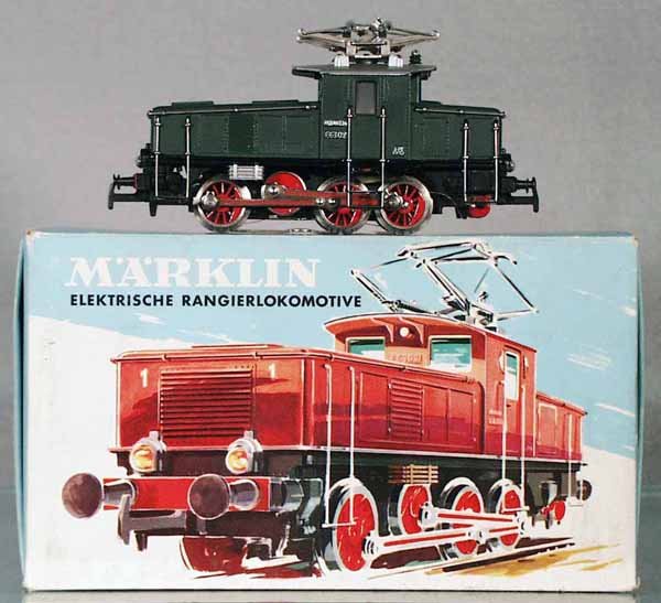

Offline elig99
#8 Posted : 31 January 2013 21:46:19(UTC)
elig99
Israel
Joined: 10/03/2012(UTC)
Posts: 12
Location: Tel Aviv
Originally Posted by: elig99 Go to Quoted Post
Update:
Why not pop up a photo so we can identify just in case it's something worth some effort?
R
Oops, sorry… didn't realize this was blasphemy :)
Actually I have just noticed that ftp.marklin.com site has a service manual in its public directory and I am in the middle of a tedious saving process of each individual jpg file.
(tried to access the site from a DOS ftp command line so I could get all files at one shot, but login failed due to wrong user/password data. Any help here?)
I also started downloading the stuff from your link; lots of reading to do this coming weekend…
Here is a picture of my locomotive. It is part number 3001. Thanks!!

"Red"??? - looks pretty green to me, presume you were referring to the image on the box Laugh
Ok, those are an awesome loco, very popular, and quite collectible, I have a couple myself and love them.
Are you aware that there is a small switch on the side to select pickup shoe or overhead?
I'm just wondering if you may have inadvertantly pushed it into the up position for overhead while handling it (very easy to do)
Worth checking because that will stop it in its tracks for sure.
PS - it looks in very good condition - very common for those to have the paint start peeling off the body, I think there was a fault during painting where they did not prep the plastic body properly first but be aware of this, try to avoid too much handling around the paint work. Can I suggest an old soft cloth or a cotton hanky, something like that placed into the box and lift the loco out by lifting the cloth - that will avoid handling the body too much and also makes them easier to get out of some boxes. Yours is either all cardboard, or 'may' have a polystyrene insert, I think cardboard to be more likely.
I only just (last week) sold one of those to our club, and took the time to scan the original leaflet for it hence the attached page at my fingertips. I was very reluctant to sell it but I'm on a tight budget and could only keep a few of the things from a recent purchase, and as I already have a couple of 3001's this one had to go. So I'm loving yours by proxy!!
Steve

Hello Steve,
You guessed correctly regarding the position of the pickup shoe/catenary switch, but that was just the beginning of the problem.
After having removed the plastic cover I discovered that lever and switched it back to the down position. At this stage the loco stopped acting 100% dead and instead stood still and hummed.
Couldn't tell what was wrong by examining the loco visually. Following an instinct I pushed forcefully the loco forward while pressing it down to the tracks to assure that the mechanism starts revolving. After a few pushes the loco started running smoothly, lights glowing and everything. Very rarely will it stop and hum again and then I will give it a taste of the same medicine. But this happens very rarely indeed.
Thanks for the diagram. What is the other lever for – the one on the right?
I am wondering whether I should/could lubricate the wheels as shown in the diagram. All I have is a WD-40 spray can, with a thin plastic nozzle attached.
And yes, my 3001 is red!!! The attached "photo" is actually a picture I have downloaded from the net. But the box in the picture looks exactly like my box. and the condition of my 3001 is just as depicted by the black/greenish locomotive.
Regards, Eli

Hi Eli,
Ok, well glad you made some progress. The other lever if you read the text on that page (now hi-lited), is the manual reversing lever. You don't need to remove the body to operate either of them.
The random stopping and humming may suggest a reverse unit out of adjustment and to check that properly, you do want the body removed so you can observe it in operation.
Once you have the service manaual downloaded, the adjustment procedure and how to check is explained very well in that publication.
It does sound however as if lubrication would also be very adviseable, but I strongly suggest NOT WD40. It's fine for what it's designed for, but not really for lubing your loco.
Assuming you have a car, in the mid-late 60's, Märklin suggested lubricating with normal everyday winter-grade motor car engine oil and is what would have been in the oil bottle 7199.
If you change the oil in your own car, and use a good quality oil, the fews drops left in a container after topping up your car would probably do for your loco's for years BigGrin - you only need the smallest drop.
Failing that, Sewing machine oil is also good, you are bound to have a sewing shop not too far away?, or, failing that...., a hardware store and you want a medium grade general machine oil, even 3-in-1 is better than nothing, but nothing is better than WD-40!
Just keep a note of what oil you use, it may not be a good idea to mix organic and synthetic oils but I'm no expert in this area.
Finally, the 3001 in Red is more rare than the Green one, and quite sought-after. There's also a Brown version, numbered 3002, and number 3002 was also used for a Primex version in the 80's.
Good luck
Steve
