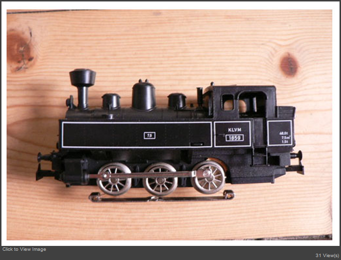

I recently purchased this locomotive little dampflok from ebay.de for 14,50 Euro.
Is this Primex maybe?

This is from starter set 29156, 29157, 29158. Produced 2005, 2006

Location: Montreal, Canada
Thanks so much Ray!
Is this digital then? Surely not for that price.

Yes, it has a simple digital decoder, similar to the 60760.
BTW, in case you didn't know, KLVM stands for "Kleine Lok Von Maerklin". Its a totally freelance design, but it has similarities to some Austrian branch line locos.

You can tell from the serial number that it was made in 2005 and has digital high-efficiency propulsion.
See here:
https://www.marklin-user...ive-s-serial-number.aspx
KLVM stands for "Kleine Lok von Märklin" (small loco from Märklin).

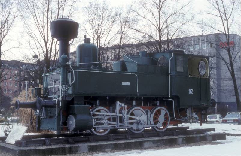

It seems to be based on these locos:
RayF attached the following image(s):

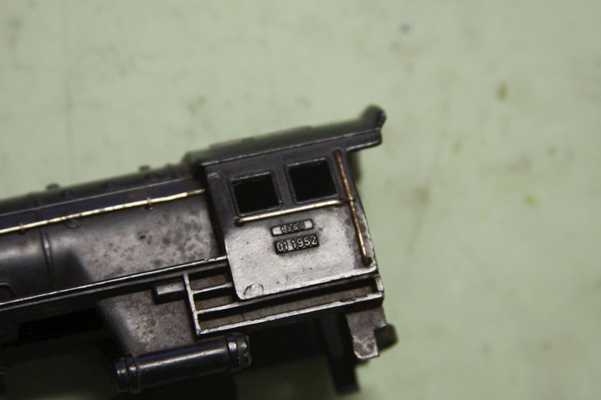

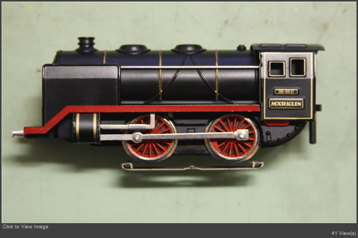

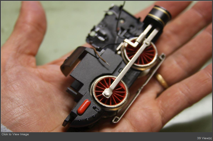

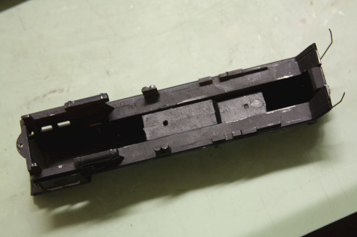

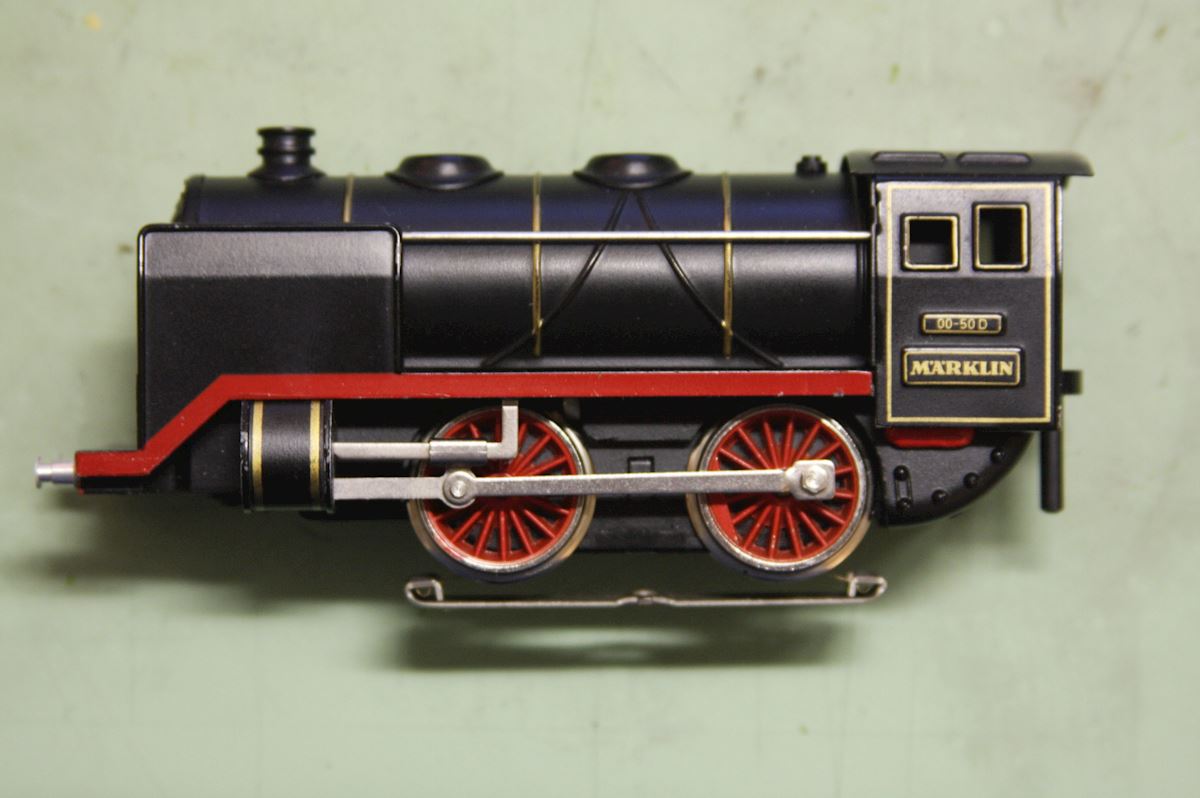

Ok, here are a couple more ... one I think, cannot be Marklin, since it doesn't seem to have room enough in the body for a reversal unit.
The other which is obviously Marklin, is something I have never seen before, and being only familiar with the insides of analog loks, I have no idea what kind of motor would sit in this thing.
Any help is welcome. Would love to know the history.
Would not be surprised if this Marklin lok comes from a kit and is a "freelance" model as well.
The set 0050 came 1985 to celebrate 50 years of H0 (or 00 rather).
It contained two analogue locos with DC motors (from Bühler), flywheels and wormdrive.

The locomotive-shell comes from a FLEISCHMANN Pacific ref. 1365 like this one:
http://www.flickr.com/photos/36032475@N07/3697803469/
Markus

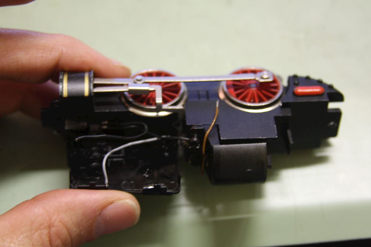

The Marklin loco is from the 0050 set, as Tom pointed out. It is a replica of the old R700 loco. This is what it's supposed to look like inside:
The set came with another replica loco and two trains:
... I have no idea what kind of motor would sit in this thing.
So that is a flywheel on there, eh? That's pretty impressive looking. Is that standard with DC motors?

So what should I do with the shell??Glare

And how do they work on an AC set if they are DC?
The electronic reversing unit converts AC to DC.
