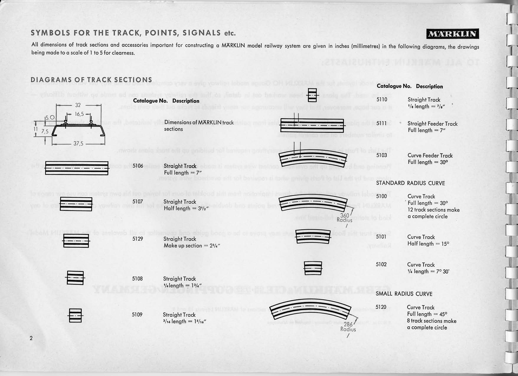

Blink I AM LOOKING FOR THE DIMENSION OF THE HO TRACK - A SECTION VIEWBlink
PLEASE ADVICE WHERE CAN I GET IT

Hi David,
Welcome to the forum ... maybe you could present yourself first before firing off questions ...
In the meantime, maybe this is what you are looking for :
Yum ThumpUp
#3 Posted : 04 January 2012 21:16:36(UTC)
Posts: 31,705
Hi and Welcome to the forum, David.
Trackplan booklet (Curved Dimension table on page 7). in German found on (PDF 16MB) http://lctm.atarrabi.org...teca/Libros/pdf/0390.pdf

Hi i am looking for the track dimenssion of marklin ho C track. You have given the M track section view. Can i get the same for C track.

No, the cross section of M track and C Track is slightly different. The C Track bed is 2mm wider than the M Track bed. and they use totally different electrical connections. The width difference causes big problems when you try to use older bridge sections from various vendors (Including Marklin) with C Track; the track slot is too narrow for C track to fit, and there is NO easy fix. Make sure any bridge you obtain specifically states it will fit C Track or ALL track styles! M Track will fit into C Track bridges, but will be be a slightly loose. Just shim it a bit. Also there is sometimes an issue with some pre-made passenger station platform sets, but that can usually be tweaked. To use C Track with a narrow platform (between parallel tracks), make sure the platform is the newer 38mm wide, and not the older 40mm wide.
