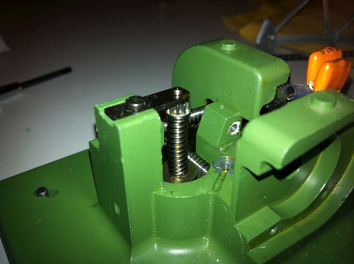

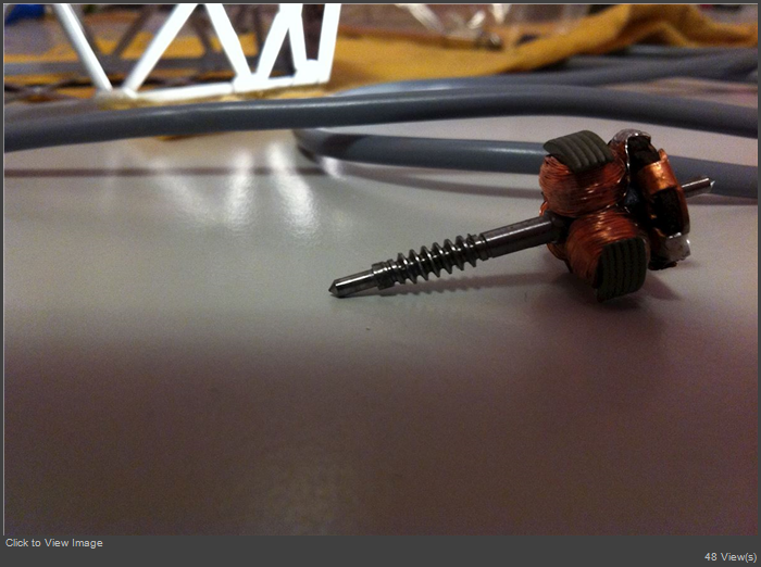

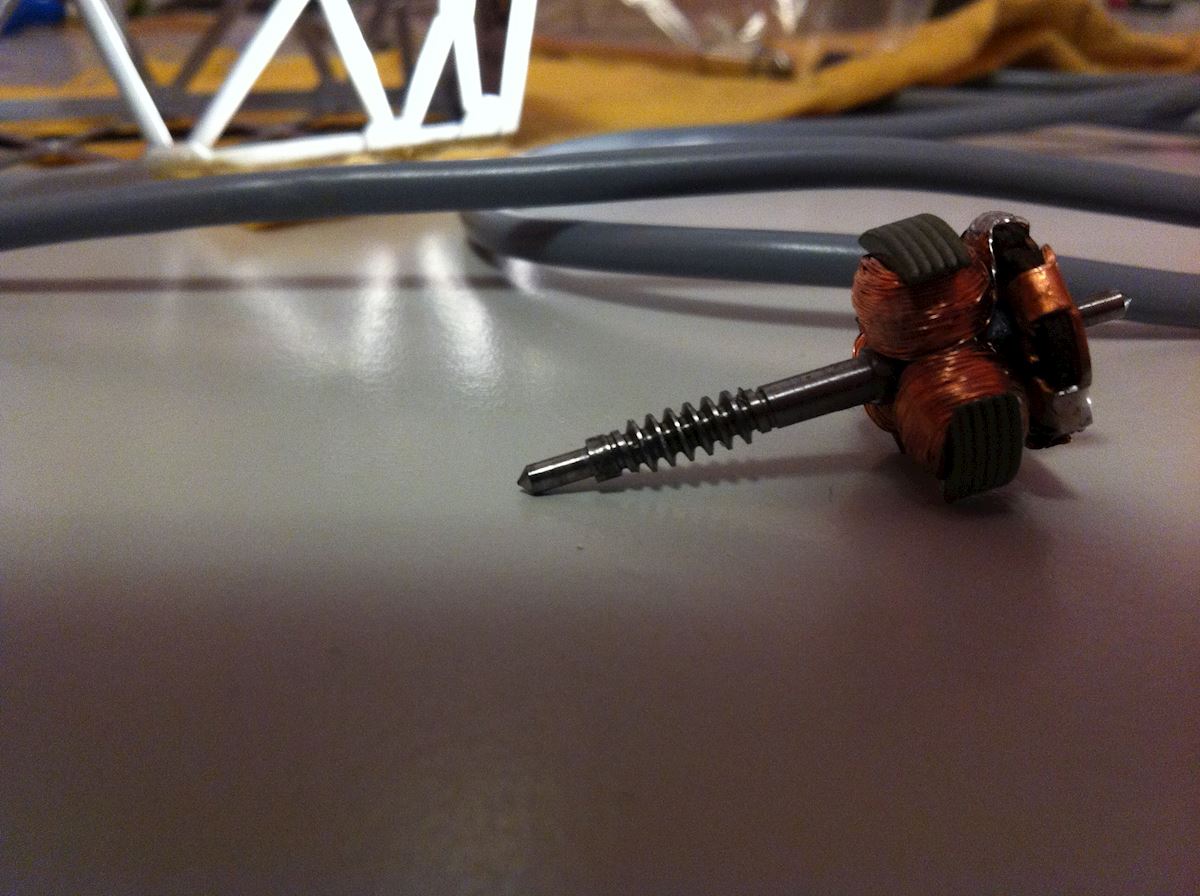

Here are the images of where the shaft was seized. I wanted to share for anyone else having a problem. You can see the hole on green base where the drive shaft (attached to the armature) would go in has a white crust around it, probably dried up lube from years ago. It of course is now clean and moving freely.
Marklin 7051 base
Marklin 7051 Armeture/Shaft
Regarding the reversing, I will have to look into it. I actually just got one on Ebay last week as I suspected I may have damaged one of the armatures trying to get it un-seized. I will try and swap the armature from the 100% working motor to the motor that moves only in one direction to see if that helps. I also am running it as a test with the gearing removed, so there is nothing to cause any resistance against the motor. I'll report back once I get a chance to do this test.
