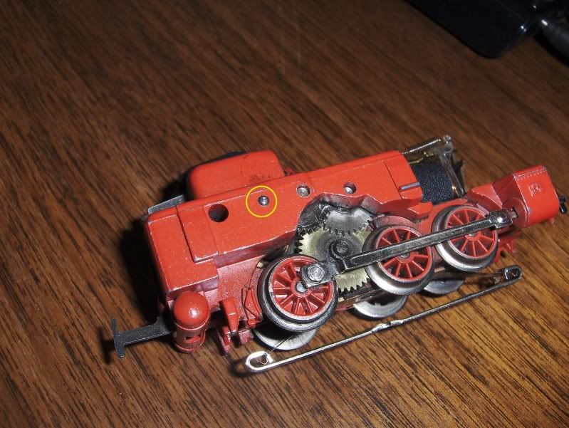

[img=UserPostedImage]3029[/img]So I pulled out the train from the moving boxes because I want it around the Christmas tree. It's a 3029 from an old S started set. For some reason, it's not working. There's a small pin that sticks out above the rear wheel; it's circled in the attached picture. When I push in on the pin, electricity seems to flow and the train pulls away. When I let go, it stops. Any ideas?
I believe that pin is the axle of the rotor of the motor and when you press it you will press the whole rotor towards the brushes and thereby create contact. You may have to change the brushes or make the spring holding the brushes press harder.
Offline Oliver SBB-CFF-FFS
#3 Posted : 22 November 2011 21:38:41(UTC)
Oliver SBB-CFF-FFS
Joined: 22/06/2011(UTC)
Posts: 544
Just a guess but I think that the pin you are referring to is could the motor axle. Since you say it works when you push it in it might mean that the motor shield is not properly attached (screws that have come loose?). This in turn results in that the brushes do not make contact, thus not allowing electricity to flow. Just a guess, but I have encountered this problem on an old 3000 loco and screwing the motor shield into place after cleaning the other motor parts solved it. I also had to replace the brushes.

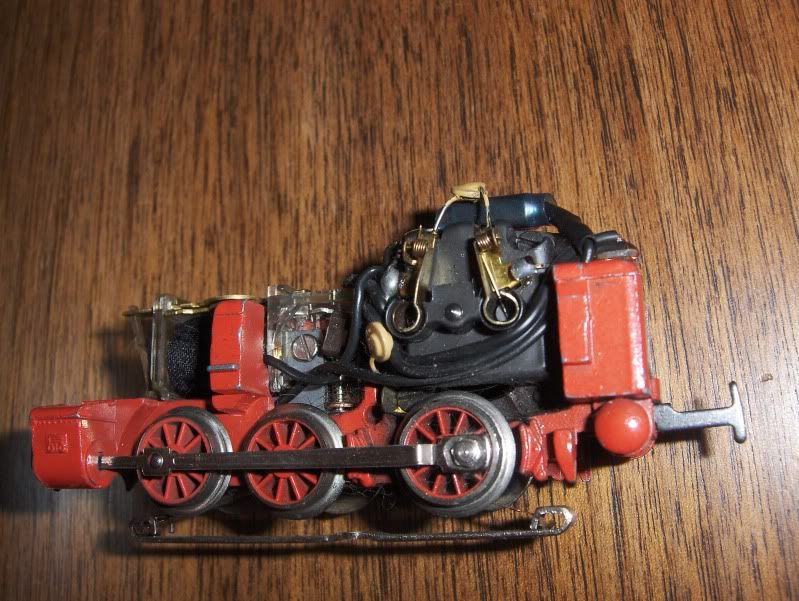

Could you provide us with a picture from the other side where we can see the black brush plate/motor shield & brushes?

Thanks so much for the replies; here's the other side. The other end of the part I had circled can be seen sticking out like a cone between the circular metal pieces above the rear wheel. I don't know much about the parts and names of parts on the train. I've read posts referring to brushes and other things, but I don't know exactly what they are. Is there some sort of diagram that labels the parts on these trains?
#6 Posted : 22 November 2011 22:35:48(UTC)
Posts: 11,165
This image gives the obvious cause of the problem. You need a new pair of brushes...
It's those round things held in place by spring levers, one piece of rolled copper mesh and one piece of round graphite.
The spare part number for a set of new brushes is 600030. This is a cheap spare part.
It looks like the graphite piece is badly worn, and the copper brush seems to be almost non-existent. With a set of new brushes she will run great again... Smile

Offline emanlooc
#8 Posted : 22 November 2011 22:47:39(UTC)
emanlooc
Joined: 09/12/2007(UTC)
Posts: 34
Location: Louisville, Kentucky
I've just done a little research online for the part number, and I think I see what you mean. Ideally, will the brushes fill those round guides, or will they be shoved way in almost like what I have?

#10 Posted : 22 November 2011 22:55:27(UTC)
Posts: 11,165
What you have to do is to lift the springed arms to the side, replace the stuff that is in the round holes with the new 600030 parts, and then lift the springed arms back onto the new parts again so they apply pressure onto the new parts so the motor can work.
Usually the arms have 2 different shapes, one is plain straight and one has a small hook at the end. The one with the hook holds the copper roll at center and the straight one holds the graphite piece in the groove at the top of the graphite piece...
