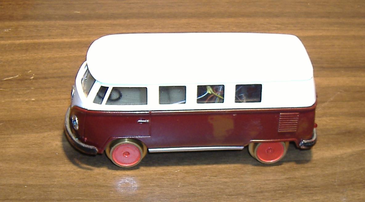

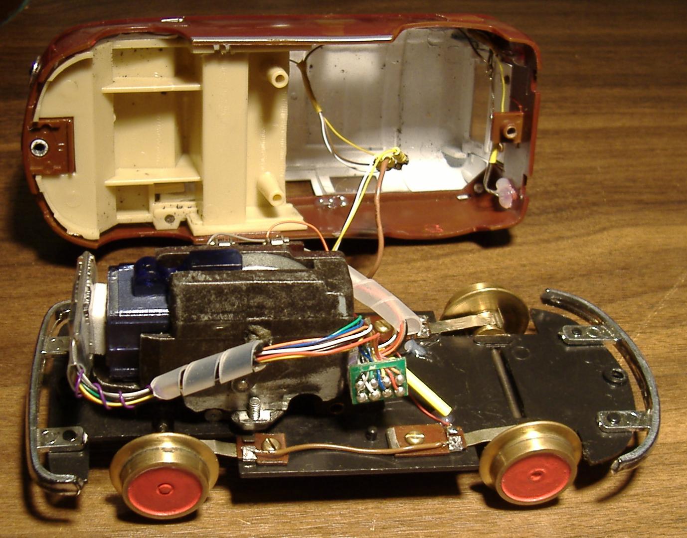

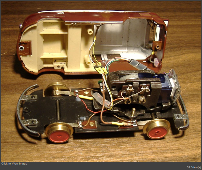

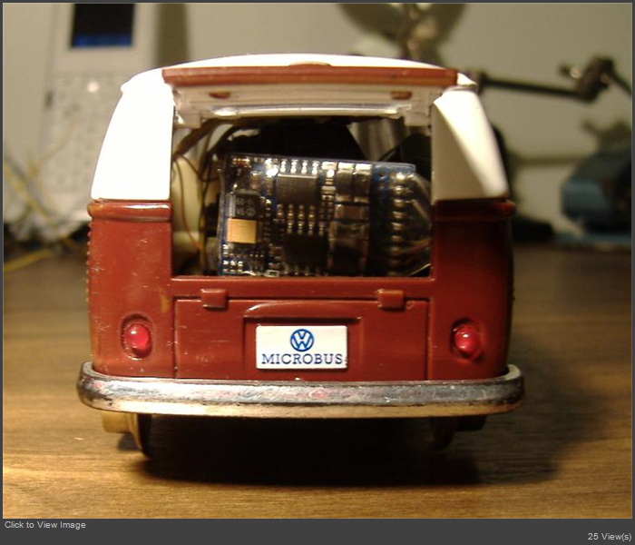

I thought it was a good time to take some photo's of my little bit of fun for others to ponder.

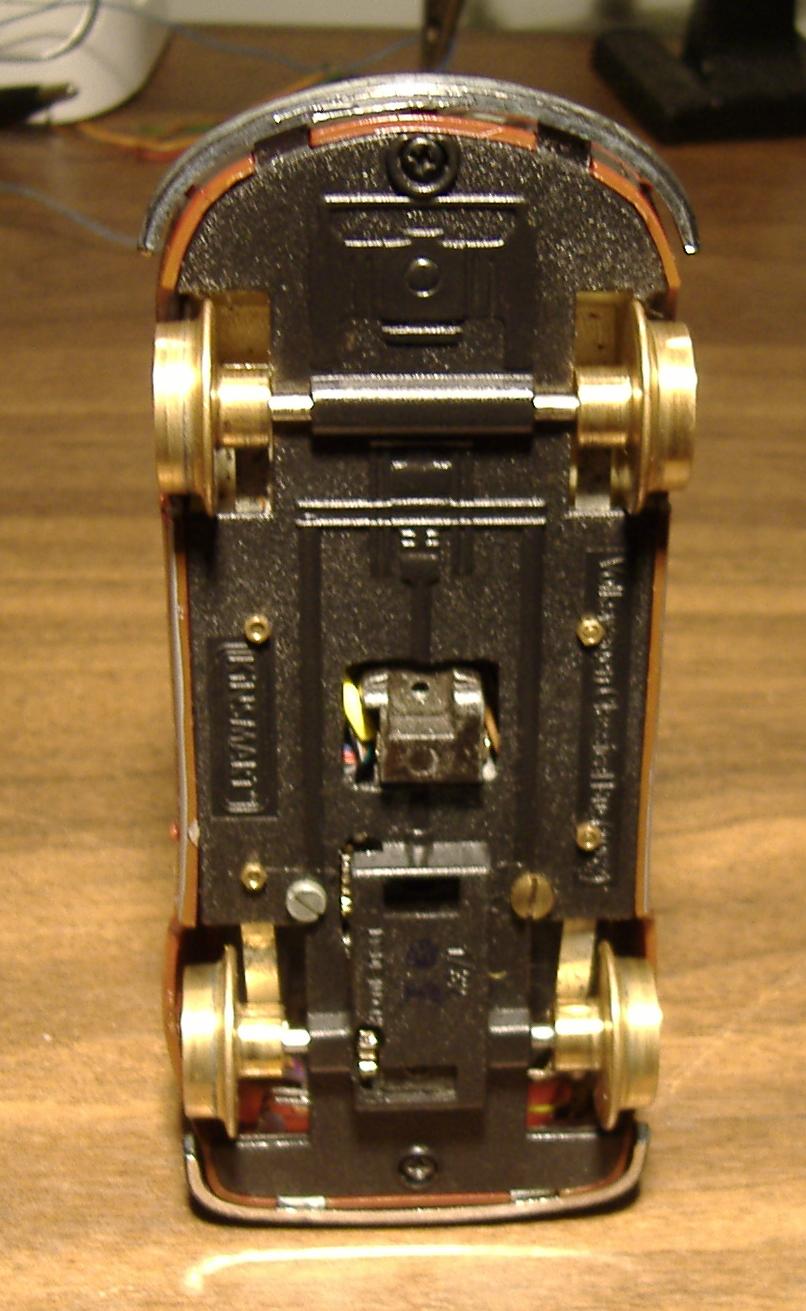

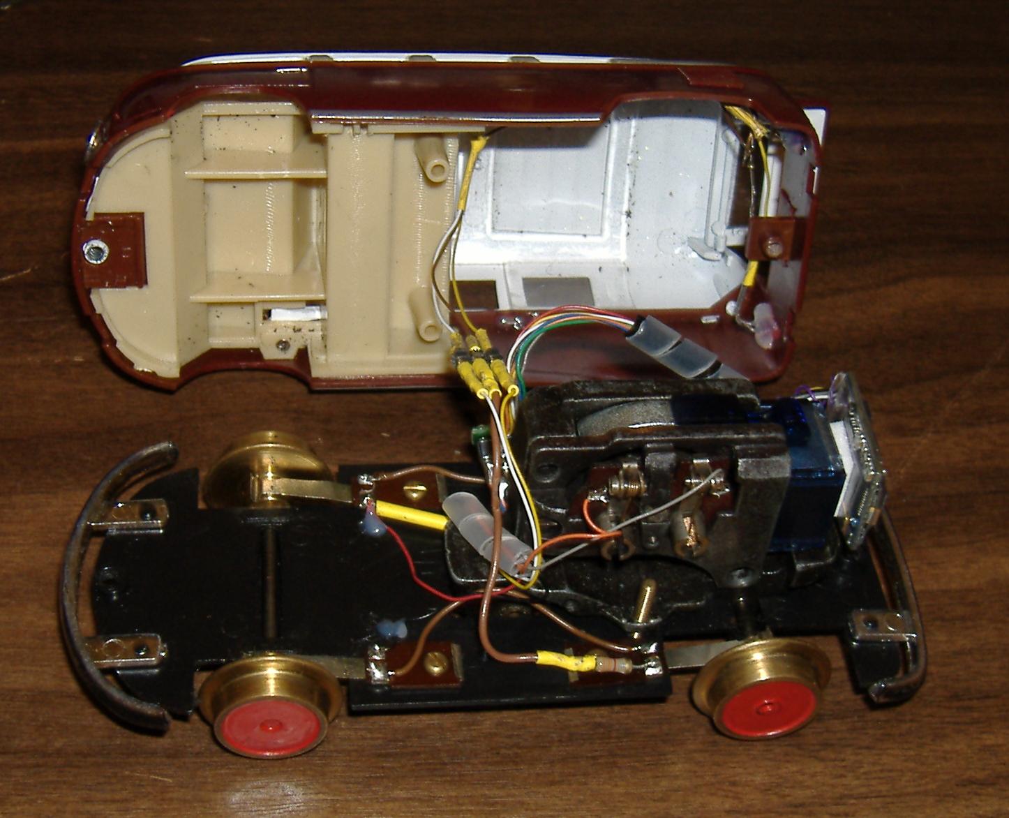

The whole idea was inspired by the never-released VW Beetle Track Car 54312 from 1998/99. I had purchased some "Kinsmart' models of the VW Car and Bus, these are really cheap models, but they have two huge advantages - one is they are cheap, anywhere from $5 - $10, I think I paid $9.00 on average.
Secondly, they are 1/32 and very well presented models.
I also happened to have an old 3021 motor lying around so one day I just started trying things out and figured that I could do this mod with little effort. Actually the hardest part was getting the flanged wheels done - well it wasn't hard, just not something I could do so I turned to my friend and fellow MMRC modeler Kevin Stevens who is an engineer by trade, he was able to knock them up from Brass in no time. They would have been relatively easy for him, because he has the skill and the tools. I am very grateful for his assistance. I won't say much more except that a picture paints a thousand words.
Comments and feedback welcome.

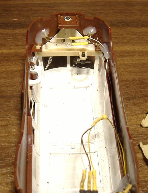

I try always to make do with what I have, the pickup from the wheels is two canabilised HO center-rail pickups, just the leaf-spring portion. Some very fine screws and nuts to hold them on. LED's for the lights, an ESU decoder (I used a 6081 originally).
The 'chassis' (if you can call it that) is very flimsy, it's only when screwed to the upper body that it becomes rigid.

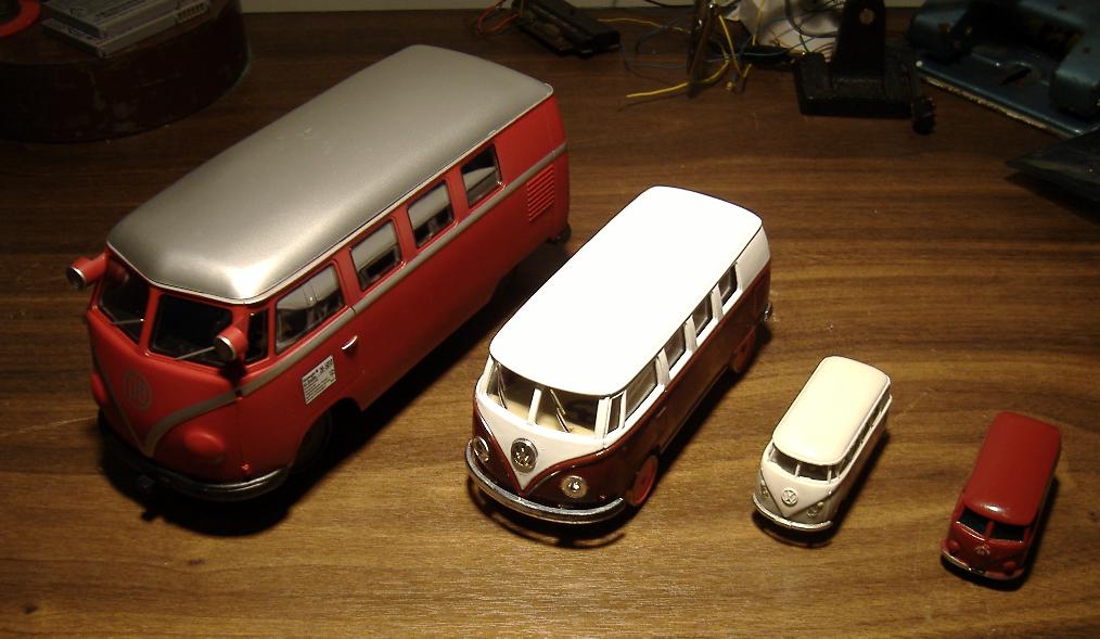

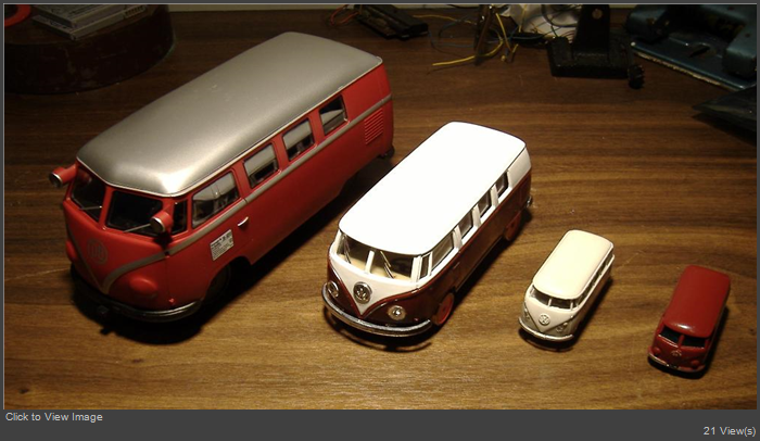

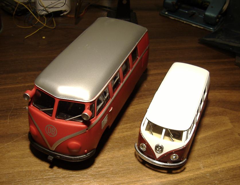

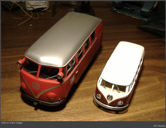

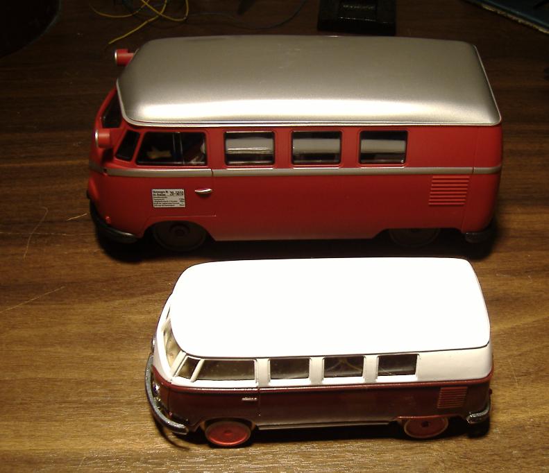

I also included some comparison pictures against my Brekina Klv20 which is G scale that you realise how big the difference is. And then I've also put it against a Faller AMS VW Bus (HO) and an old Eheim HO Railbus to give some reali perspective.
