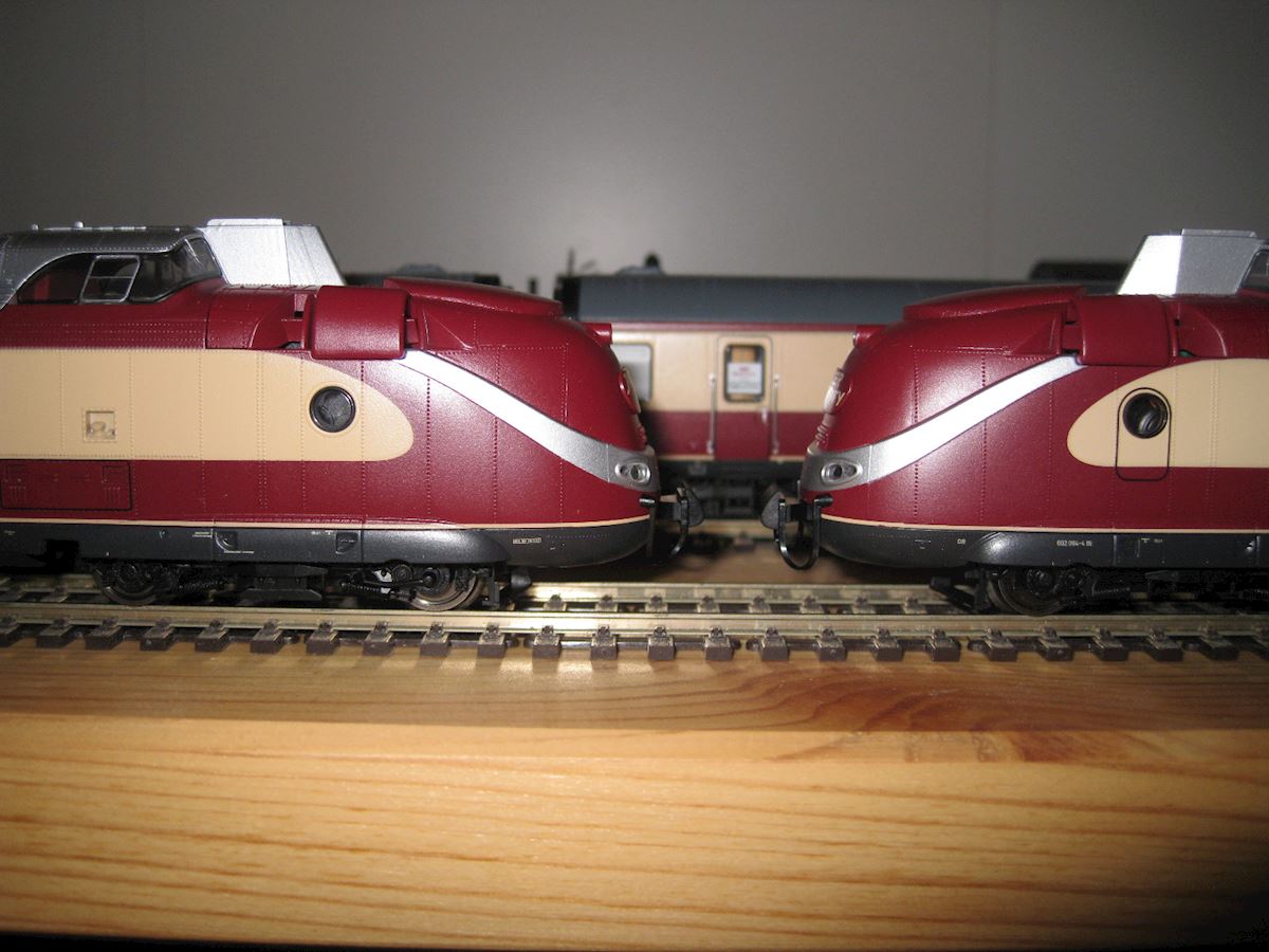

A good friend of mine has a Digitrax DCC system.
Because I don't have a layout myself I am letting my trains run on his layout now and then.
Now I just got a very nice (and expensive) sound equipped TRIX Gasturbine art # 22202, consisting of TWO (real) locomotives with motors but I think only one may have a decoder (probably SelecTrix ??).
The two locomotives have always to be coupled together with the cars in between them.
It looks like it has been programmed on address 3 (or 003).
Unfortunately it does not do anything on his layout, it won't run an inch Confused.
I also have a sound equipped TRIX BigBoy (22599) and also a TRIX SVT137 (22010) and they run perfectly on his layout.
However it runs very good on the analog DC system of my club with front and taillights and lights lit in all 5 coaches albeit without sound BigGrin
I still haven't tried the 22202 on a different DCC system.
I don't have a clue myself about what to do and what not to do.
Is it possible than this TRIX 22202 is simply NOT compatible with DigiTrax DCC or could anyone give me any other suggestions ?
Thanks, Jan
