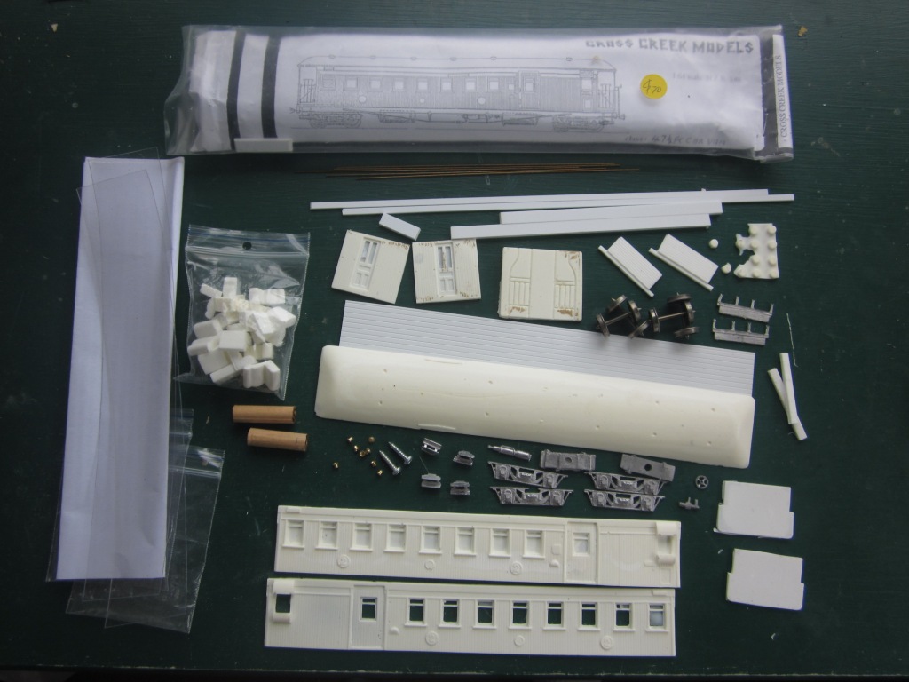

Now the kit. The first one I will do is a lowsider, classified as an M-2. this type was first built in 1891. The kit is made by Cross Creek Models.
For the princely sum of NZ$ 45 you get a one-piece resin body
Did anyone mention Swiss cheese?
And a collection of whitemetal and other bits.
Quality is not as good as other kits I have built, but that doesn't mean that it won't finish up being a nice model.
Instructions were in the form of a NZR general arrangement, probably one drawn in the 1930's by Cedric Green. These drawings are very popular with modellers heer as they happen to be drawn in 1:64 scale. The rest of the single A-4 sheet is filled with some handwritten notes and an exploded diagram. not exactly much, but fortunately the New Zealand Rolling Stock Register contains a lot of good photos of these and other wagons, which saves me a lot of searching.

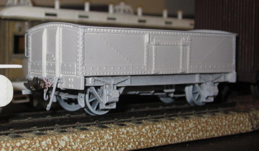

First up I deburred the frame pieces. These are two sturdy whitemetal castings with a lot of flash. This was cleaned up with a file. Chalk is smeared onto the file to prevent the soft whiremetal clogging up the file.
The next item to do is soldering the bearings in. The usual method for whitmetal is followed, with plenty of flux and a little low-melt solder. In the photo my fingers are holding the solder, my second hand is holding the camera and my third hand is holding the soldering ironBigGrin
The frames are supplied way too long, so you can cut them to exact length to fit the resin body. A sensible thing to do, as resin will shrink during production, but production methods mean that not each body will e exactly the same length.
Here they are marked for cutting with a fine toothed saw. the mark in the middle is for centering.
After being cut oversize and brought down to the correct length with a file the frame bits were marked for their respective sides(their lengths did not turn out to be equal) the defects in the casting were fixed with styrene and filler.

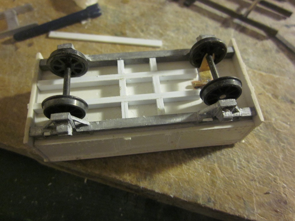

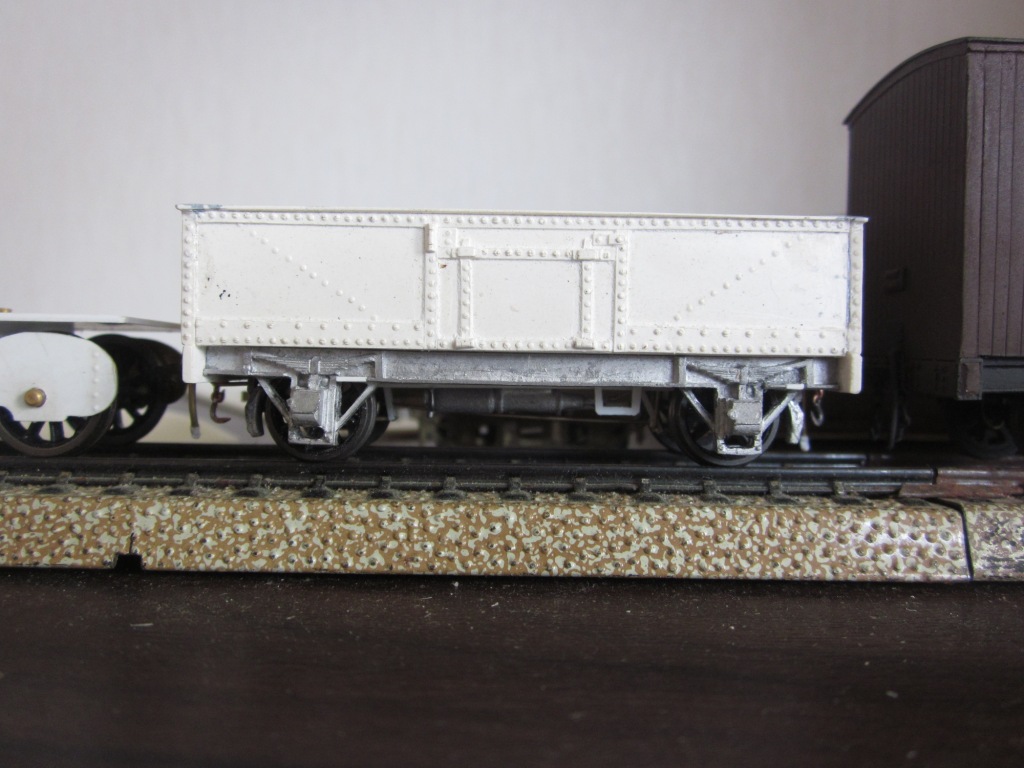

The obligatory test fit
Once ready, the frames were superglued to the body, with the wheels being inserted as well, as I don't think I am able to remove them later on without damage.

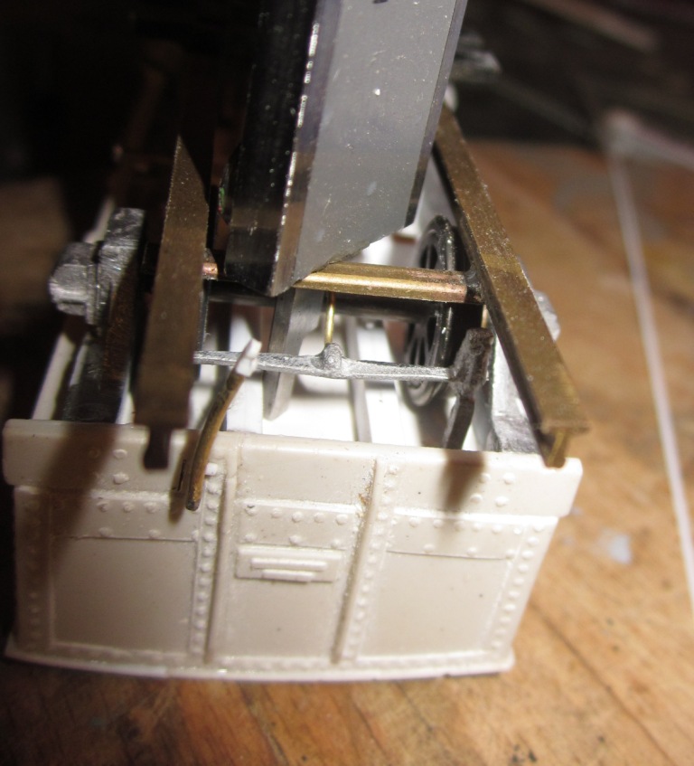

Time for undergubbins, aka underframe details.
The kit supplies materials for the handbrake, brake blocks and a Westinghouse brake(WHB) cylinder.
As this is a little bigger than my usual scale, I wanted something more. Again, looking at photos I discovered the real arrangement of brake blocks on these wagons. Crawling under real four wheeled wagons with a camera revealed the rest, so a good shot at detailing could be done.
The WHB was done first. The brake works one one pair of brake blocks. Linkages were built from bits of styrene and brass, and attached to the whitemetal castings
The handbrake was next. Period photos and current ones again provided the required info. Because I was not satisfie with some castings, these were butchered for useful bits and other castings that were not needed were left in the box. The brass strip came with the kit, this was bent in place and the rest of the linkages were again built from scratch. All measuring was done with the Mk I eyeball

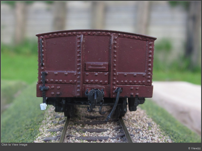

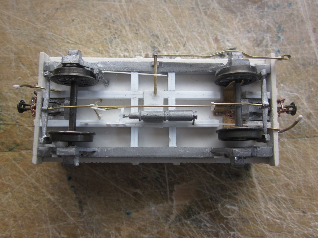

Work has continued on the little wagon. More details have been added, including air hoses and piping, guard irons and handrails.
The casting is meant to contain a lot of boltheads on both ends. However, in my kit almost all were ruined by air bubblesThumbDown. Because filler is not an option, I drilled out all the holes formed by the bubbles wit a 0.5mm drill. I then spent a quiet evening stuffing 0.5mm round styrene rod in the holes to imitate bolt heads. While I was at it, I added bolt heads to the sides as well, where they would have been in real life.
Here is the result
And from underneath

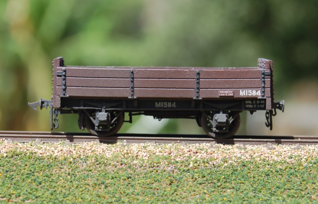

The real thing - preserved at Steam Incorporated in Paekakariki.
M1647

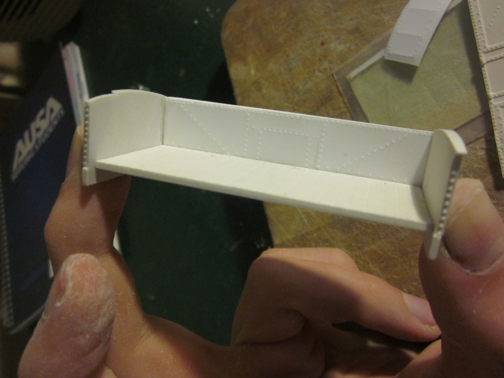

The end walls have been tackled today. These cars have a fair bit of half round beading attached to their walls to make these cars look more interesting. However, half round styrene is not available for the size I need. Fully round styrene is, fortunately, and by using a bit of cunning and care the round styrene can be made to look like half round beading.
The basic idea is that you leave a gap equal to the diameter of the round styrene. then it's a matter of glueing the round styrene in the gap so that half is proud of the surface.
Here is the result, applied to the end walls of the carriage:

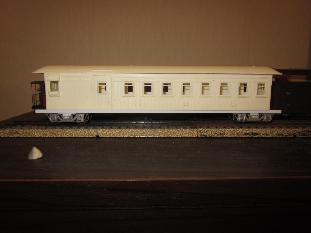

With the lower half of the body pretty much done, I could'nt put off doing the windows any more. The upper half is pretty much all windows, so I had to use the clear styrene to strengthen the body, instead of attaching it after painting. the framing was attached with Krystal Klear, as normal glue will damage the clear styrene.
The top set of windows show the inside, the bottom show the outside.
The whole assembly was then glued to the body.
These carriages were all wood, and the windows meant that these carriages were not very strong. The bodies had a tendency to twist along their length in crashes(much like some model carriagesBigGrin ) In order to combat that, on many carriages windows were removed in order to install bracing, just like the six-wheeler in the photo.

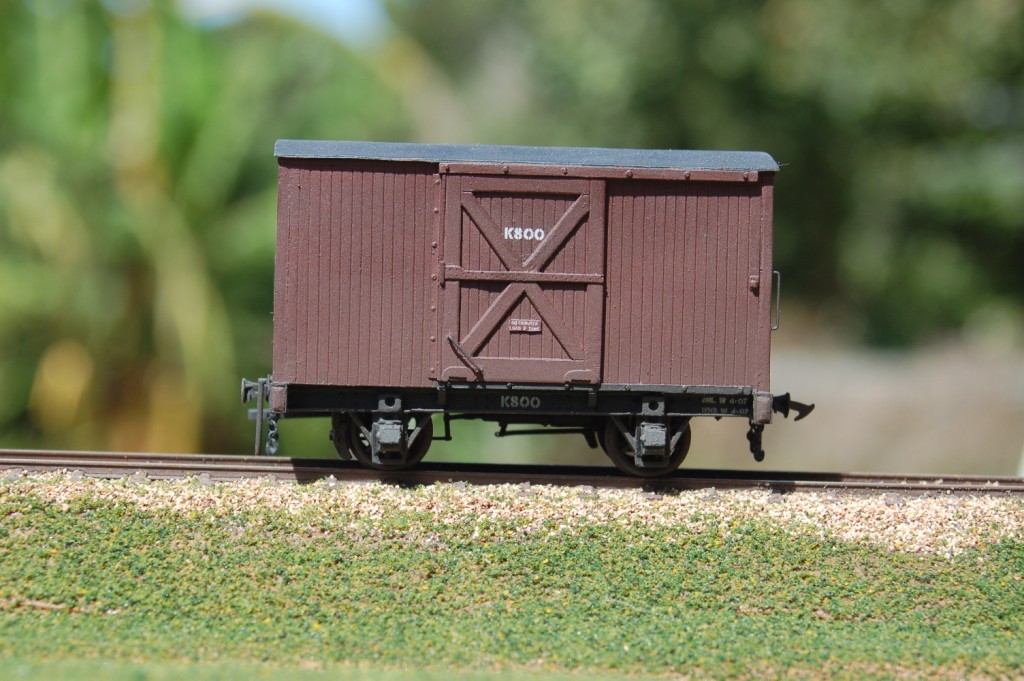

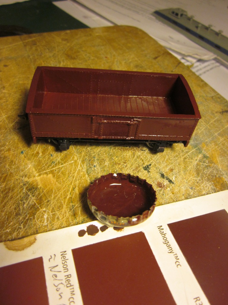

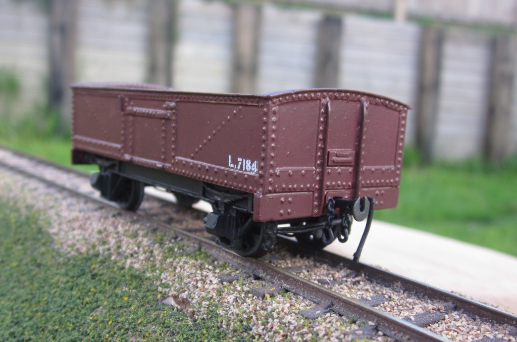

Together with the BR 23, I had the chance to finish painting the M-2. As I mentioned a couple of posts back, the black underframe was done first, after the obligatory coat of primer.
The top coat could then be done. The question was, what colour to paint it? Macca's picture shows the wagon as it was at the end of it's days, painted in the standard red oxide livery. However, this colour was not used in the 1900's. It took a fair bit of research to find out that the most likely colour was Haematite, with "the Nelson company being preferred". In a thread on the nz_railchat group on Yahoo, I found a link to a Resene colour that apparently was close to the "Nelson Haematite" I was after, although the colour was based on dubious research. Colours in the early days were nowhere near as consistent as now, not even taking into account weathering, so I decided to go with the Resene colour. After a trip to the local Resene shop,I mixed up the colour myself from a swatch using some Humbrol paints. After I had figured out the right combinaton, I mixed plenty for the wagon, and set to airbrushing it.
This is the result:
happened to have a NZ Model Railway Journal lying in the workshop for modelling the axleboxes on A 300, so I used that as a background.
And another pic, because it looks so goodCool
While I cannot vouch for the colour being 100% accurate, It could be quite likely that a wagon looked like this one a century ago, which is fine by me.

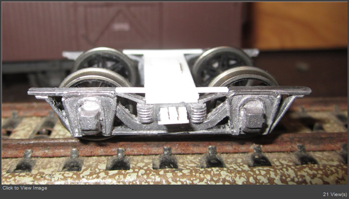

I could then not put off the bogies off any longer. The main frame is made from 0.5x1mm styrene, suprisingly enough exactly to scale and still strong enough(though I only found out they were to scale days later...) The rest is styrene of various sizes and coil springs made from copper telephone cable.
This is the trial sideframe
And three evenings later the car was on it's BP 508 bogies

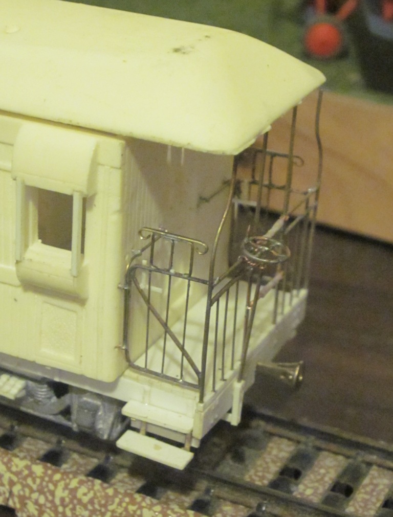

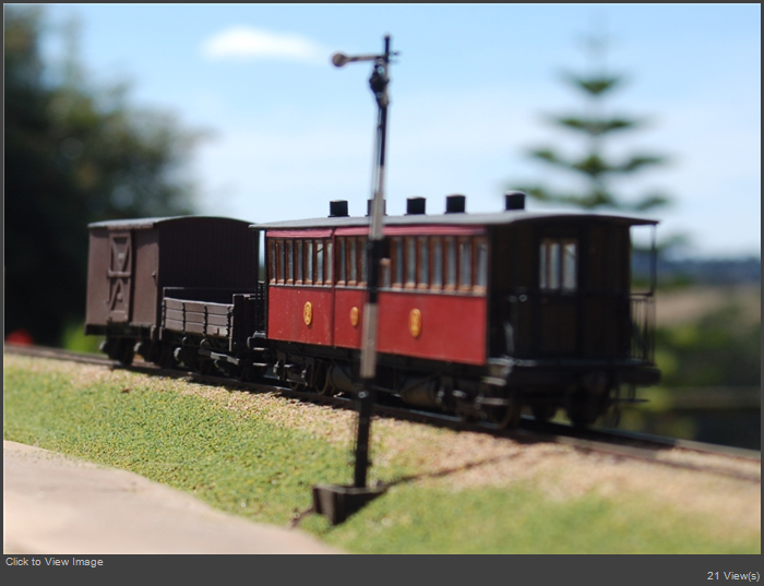

To stop passengers stepping off the end of the carriage, handrails and fencing are fitted. To model this, I soldered up various bits of brass wire in a jig. A handbrake was also fitted to one end. The wheel was made by soldering bent copper wire inside a copper ring. The iron was then turned down to a lower temperature, and a pin and the axle was soldered using low-melt solder. This way I didn't have to worry about the spokes coming loose. The whole assembly was low-melt soldered to the handrail To finish off, handbrake rigging was made up from styrene. To finish off this round of building airhoses were fitted.
Then the whole car was taken outside for a photo shootCool
Side view:
The handbrake end. Don't worry about the gap between the headstock and the body, that will disappear when the boody is attached properly.
Underside of the "No. 1 end" showing handbrake details
To finish off, my NZR fleet so far.

To finish off the safety features located on the carriage's balcony I had to make some gates. In real life they are easonably sturdy iron things, but in S scale they are a right old pain in the butt, but I eventually managed to get them to look reasonably simular.

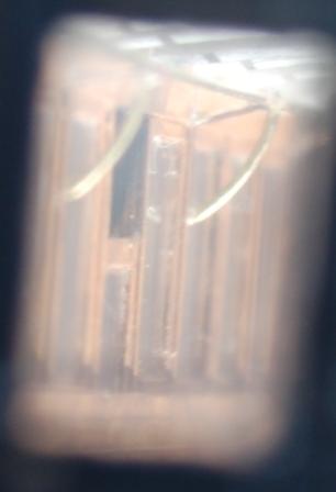

The inside of the roof was then given a coat of white, followed by some varnish. I could then fit the gas lights. The pretty solid glass bowls(I should know, I hit my head on oneBigGrin) were mimicked by heating some clear vacuform plastic with a paint stripper, and using a piece of turned styrene as a punch to get the characteristic shape. Before they were fitted I painted a brass ring on the base, followed by a bit of Krystal Kleer to secure the glass bowls.
The roof then recieved exhaust pots for the gas lights, followed by a coat of paint. The roofs were canvas painted with white lead, but in service the sulfur in loco exhausts reacted to turn roofs grey, and soot didn't help either.

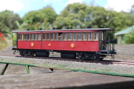

The roof was then glued on. When a 1:64 scale passenger loks up inside the carriage, he will find this:
Drool
And this is how it looks on the outside:
Note how the roof pots are not evenly spaced along the length of the car, another trace of it's previous life. Brownie points awarded to the person that correctly guesses where the old body ends and the new one starts.

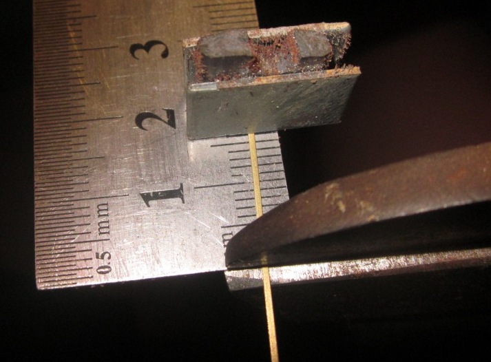

Some time ago I got some couplers from VCC models , which I recieved within a week of orderingThumpUp The couplers themselves are cast brass, and work just like the real thing. Some hardware is also provided to mount the couplers, in the shape of whitemetal draft boxes and some centring springs. To fit them to the M-2 and A 300, a slot was filed into the headstocks into which the coupler shank could move. The draft boxes were filed to fit each item of rolling stock. In the case of A 300 this involved a good deal of butchering, but a bit of filing was enough in the case of the lowsider. The couplers were then assembled and fitted.
Besides couplers, rolling stock is also fitted with safety chains. To save the effort of ordering and waiting for ready made hooks, I decided to make them myself. The chains and hooks are made from two sizes of copper electrical wire, which is easy to shape and it happened to be the the right size. To get the point on the hook, a bit of wire was fitted in the chuck of my drill, and with the drill going, I shaped the wire with a file. The wire was then bent around bits of other wire, and the oval links were made by wrapping the wire around two bits of wire side by side. The nice thing about soft copper wire is that you can cut it with a sharp knife, giving you a straight cut without any filing. The hooks were soldered together, and attached to the chain and then to the wagon and carriage.

I still had the other NZR kitset kicking around. With the model show that was in Devonport this weekend I usually give a modelling demo. This year I decided to make a start with building the K-6 goods van. The van is a little younger than the M-2, but the underframes were nearly identical, making research easy.
This is how the kit looked on saturday morning
And this is how it looked saturday evening
What has been done;
-body assembled
-new floor and underframe
-solebars and wheels assembled
-air brake rigging assembled
-Couplers assembled
I discarded a few parts, because they were just plain awful, and I've replaced them with scratchbuilt parts.
The solebars required a fair bit of remedial work, which included reconstructing part of the web of the channel section of the solebar, as well as adjusting the holes for the bearings.
I didn't spend the whole day modelling, I also spent some time annoying puristsBigGrin
Surprisingly, There were not many moaners, and unsurprisingly, the carriage didn't like R1 curvesGlare
Unfortunately I had other commitments today, so I could not do any "live modelling". I did get some stuff done at home though.
The handbrake rigging, which is identical to The M-2 was made. Following that I cut some ribs to support the roof.
The provided roof was an absolute joke, and looked more like something cut out of packaging that a model roof. I therefore made a new one from 0.4mm thick styrene, measuring off the body for the right shape.
There are just a few details left, which is the nice thing about these kits; you can finish one in less that a week's worth of eveningsCool

I have finally managed to get some decals printed, so one by one my almost finished models will be finished. I hope.
The decals were drawn up in Inkscape(a free vector drawing program) based on photos I took of the real thing. The stencilling is a special font I found especially made for modelling NZR stencilling.
The class and number plate decals were stuck on a disc punched from 0.25mm styrene painted yellow. With the decals on the plates were stuck on the sides of the car using Krystal Klear. The underframes were decalled, after which a clear coat was used to seal the decals and make them blend in. After that, a coat of dirt was added to give the car a lived-in look and the axleboxes got some "oil"(gross varnish) leaking out from their covers.
The result was photographed while the sun was out yesterday:
A close up showing the bogies and car plates
The whole car
And looking through the window in the end door
Rick

With the decals in, it was time to get some stuff finished.
Both the M-2 and the K-6 had a rigid chassis of slightly dubious quality, leading to frequnt derailments. Part of the cause of this was that the wheels were not aligned well. Unlike an etched chassis, you cannot really trust a poorly cast whitemetal chassis to alighn the axles properly. To solve this, I ripped out the axle and fitted a means of compensating the axle. This consists of a bit of brass sheet sitting in a groove turned in the middle of the axle. Two guides near the wheels keep the axle from moving around too much and keeps it with the wagon when it is picked up. Below is the result, which runs a lot better. The key to this is giving the guides enough play to let the axle move around freely.
kariosls37 attached the following image(s):

Time for another kitset. This time an L class highsider, built around the turn of the turn of the last century and one of the first to be built in iron. The kit is another modestly priced model made by Cross Creek Models.
It's the usual story again, straighten the bits, sand to size and start assembling. Because just building the kit is too easy, I fitted a lining to the inside so the wagon has rivets inside and out.
The underframe is of the usual whitemetal kind, and to guarantee good running I fitted my standard compensating mech to one wheelset. The handbrake was fitted and redetailed to suit the prototype and my tastes as well.
I then used my handy little floor height measuring jig, a piece of old track with a bit of brass soldered to the top of the rail making measuring the height off the rails easy. Once I knew what the height was, the coupler box was adjusted and chopped up to suit. The headstocks were also drilled and filed out to fit the couplers. Once the couplers were in some chains were made up and fitted.
More will follow soon
Rick

With the handbrake done, the air brakes were tackled. Fortuately I was able to photograph a similar wagon's underframe a while back, so I had some reference photos to work off, resulting in a pretty good idea of what the air brake setup looks like, which can then be modelled using the provided brake blocks and brake cylinder plus styrene and wire extra's.
The air hoses were also modelled, being made up of wire and some styrene bits. Again I got lucky because I happened to have photograped an old Westinghouse spares book with many handy drawings.
After that it was just a matter of bending up a handrail from 0.35mm wire, and the wagon's ready for painting, after only half an afternoon and three evenings build time. Not bad considering my scratchbuilt cars have taken the better part of half a year(in between other things)
Now off to the paint shop.Cool
Rick

With the primer dry, a suitable colour was mixed up from the usual Humbrols. For reference, a colour that is apparently close to the origional haematite colour used on the wagonswas used, which can be seen in the bottom of the pic. The difference in gloss makes the colour looks more different than it is in real life. However, as the real paint varied quite a bit I'm not fussed by some differences in colour. Because I don't have my airbrush handy I just painted the wagon with a brush.
That leaves the underframe to do, which I will airbrush together with a couple of other things, hopefully this weekend.
Rick

It's been lingering around in it's painted state for a while now, and last week I got around to taking some pictures.
This is the state it will linger in for some time, because I need more decals. When I get more made the wagon will probably recieve the same treatment as the other wagons; a light weathering and possibly a load.
For now, here are some photos

Together with the L, I also picked up a car van. The kit models one of a reasonably common 47 1/2' car van. I have picked Af 804 to model. It was built as a plain carriage in 1903, and converted to a car van in 1943. In 1970 it was bought by the Glenbrook Vintage Railway and has served there ever since. The GVR named the car Tainui, after one of the migration waka(canoes) that the indigenous Maori people used to settle NZ. As a volunteer at the GVR, I see it quite a lot and I have no shortage of detail photos of itCool
The kit is a typical Cross Creek kit, with resin sides, ends and roof, whitemetal bogies and detail parts plus some styrene bits for the floor and underframe.
It took quite a bit of sanding to get the sides to the right thickness, but once they were down to size they were glued togther. I was not too happy with some of the detail on the bogies, so I chopped out the unsuitable bits and replaced them with my own styrene stuff. The bolster(the bit that goes between the bogie sides) was also replaced by styrene for ease of use.
Constructing the underframe followed, with the provided styrene being cut and filed to shape. With a little glue and patience and I have something that looks familiar.
That was the easy bit, next up is the detailing.
Rick

I slowly continue to detail the car van.
I haven't done much to the interior except for adding interior walls. In the first pic you can see the toilet top left, with below that the passenger compartment. Further down is the guard's compartment, complete with an alcove for a little potbelly stove.
More work has gone into the outside. Truss rod queenposts were chopped up to suit my prototype, and details were made up to suit from styrene. The provided headstocks were discarded, with new ones to the right shape made up from two layers of styrene. The outer layer is thin annd contains the embossed rivets, while the rest is thicker stuff. Outside floors are also styrene replacements to get nicer detail. The steps are also replacements. Unlike A 300, the steps are a combination of brass strip and styrene. A 300's all styrene steps kept breaking, so I've gone for something more solid this time. The couplers are also on, although the height still needs to be tweaked a little.
Next up are the handrails, which are going to be an interesting soldering job.

Slowly the car van has progressed. The next thing I did was the underframe, with all it's brake rigging and equipment. Because I happen to have pretty complete pictures of the underside, thanks to the car being parked over the inspection pit when I was carrying a camera, I made a complete model of the underside. Just because. Gas tanks for the lighting will be added later.
The end rails and gates were soldered up from brass strip and wire. It took some time, but it looks the part in the end. Because I couldn't be stuffed looking for my low-temp solder, I soldered everything together using the same solder. This means you have to be a bit cunning to stop other bits from falling apart as you solder bits on. Pleny of flux and a little patience works wonders here.
To aid cutting a number of bits to a consistent length, a high tech cutting jig was used, which you can see in the second pic.
After everything was soldered together styrene catches were stuck on the gates ad the whole lot was glued to the car into pre-drilled holes.
