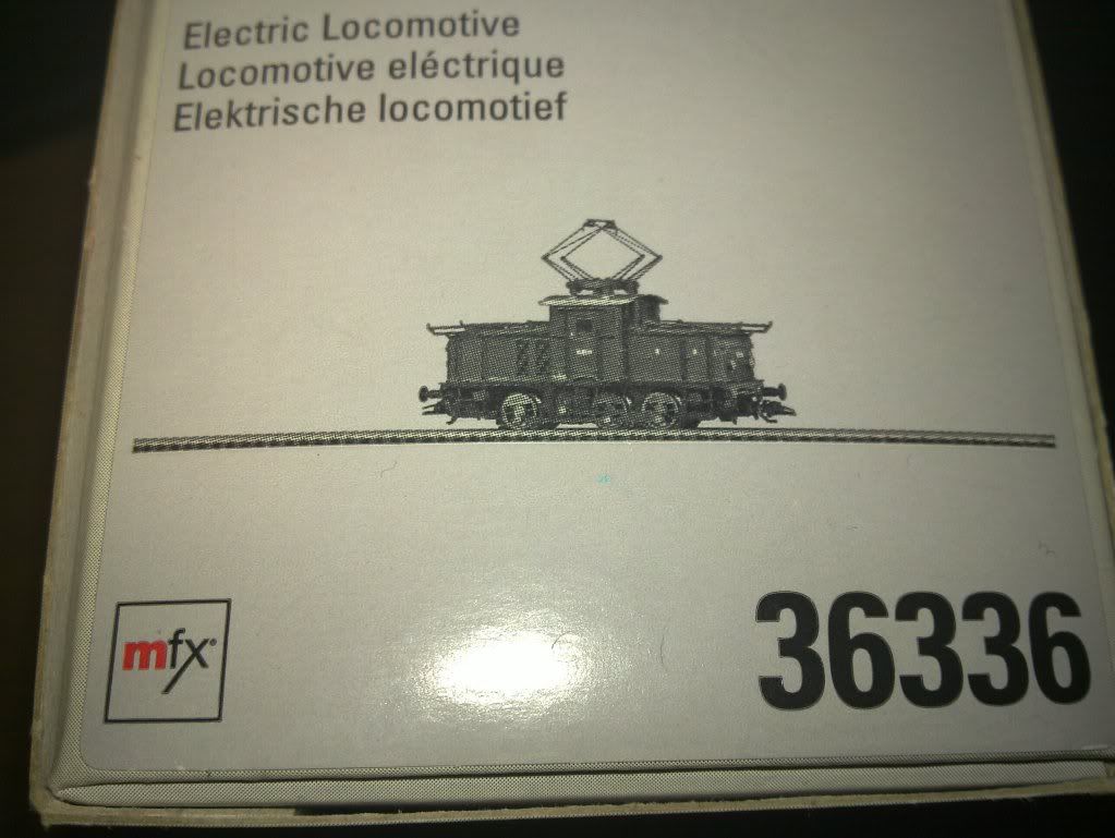

No one has added a MFX decoder for on this, it was bought brand new. and the box says that it has MFX so i belive the box
no it does not has dip switches.
I have also tried added it from the database more then one time but still no luck with getting it running.

Here you go, here is a shot of the box Smile
