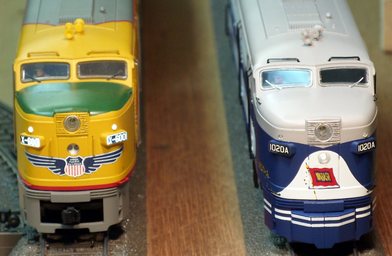

Here comes a very fast review of the Blue Bird as I´m busy this weekend. I don´t have time to post pictures right now, but they will come. I´ve also made a video which I´ll post.
26490 Reisezug “Blue Bird”
Length - 1760 mm.

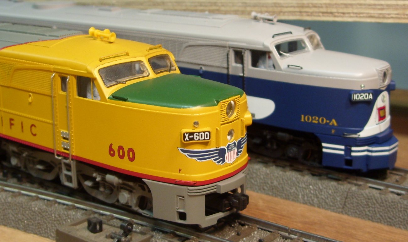

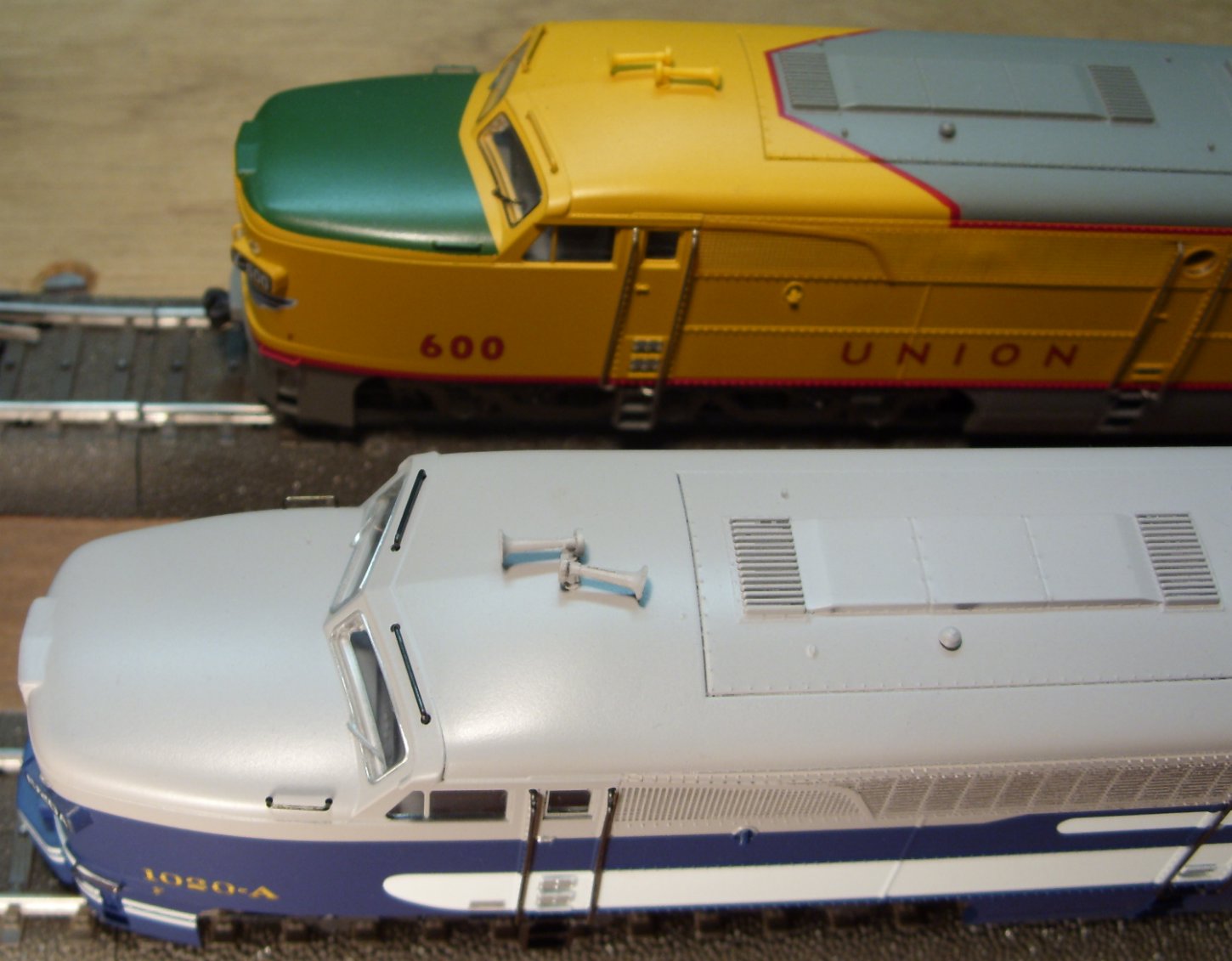

Comparison with the 37610. Note the white LED and also note the upper headlight is turned off, which is the marslight.

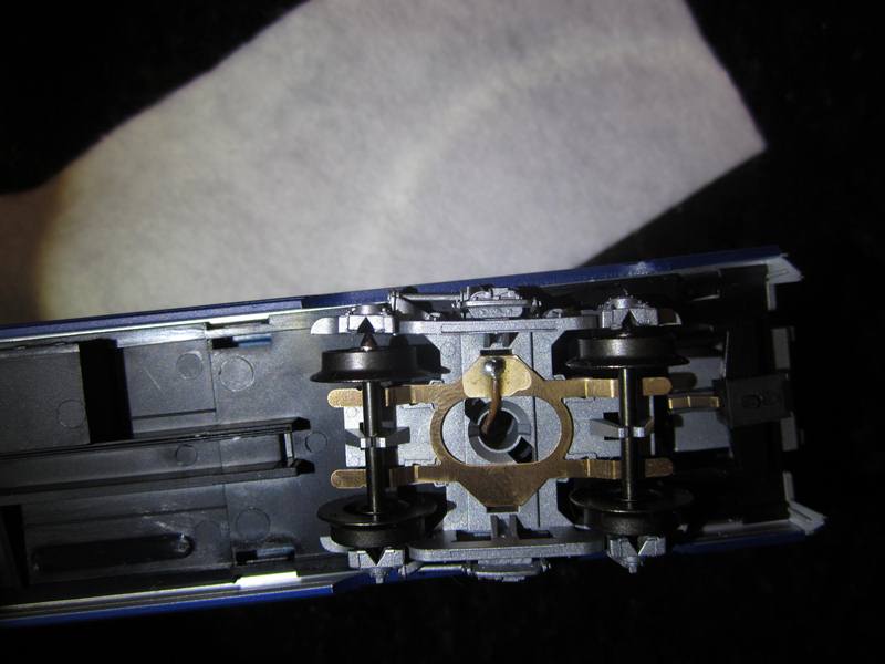

And here is one of the 3 signs that are really badly assembled. Note how it´s sticking out.

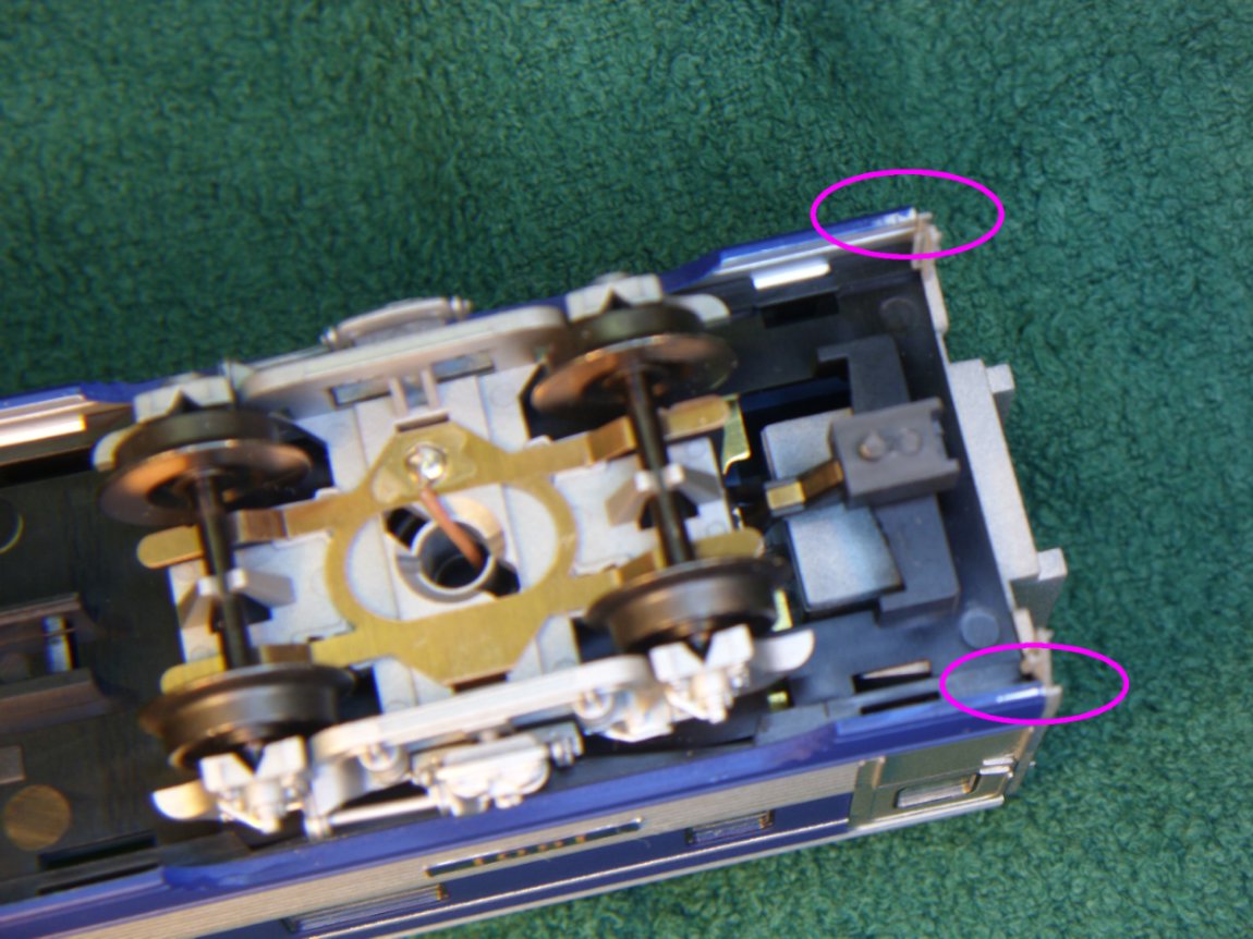

BTW I´ve found one more flaw... on the end coach. There are dots on it where there´s missing some blue paint!! This isn´t supposed to be like that on this hich value collector´s item. I´ve just emailed Märklin.
....are they "visible" dots, "very visible" dots ,situated on the top, side...or on the bottom,....big, small,...?...it seems that all is on the same coach.....so , if you choose to return it , you can mention a lack of external finish on your end coach....(?)

It´s not that obvious. I think the paint has been chipped away during one of the installation processes. There are 3 places where there´s missing some of the blue paint (to the left of the boogie and one right above the boogie). Also note the white threads which were on almost every 2nd sign. Unfortunately the signs are glued badly on 3 different coaches... If this hadn´t been this limited release, nor that expensive I wouldn´t bother.
Edit: Correction. Not 3 cars, but 2 cars have the sign problem.

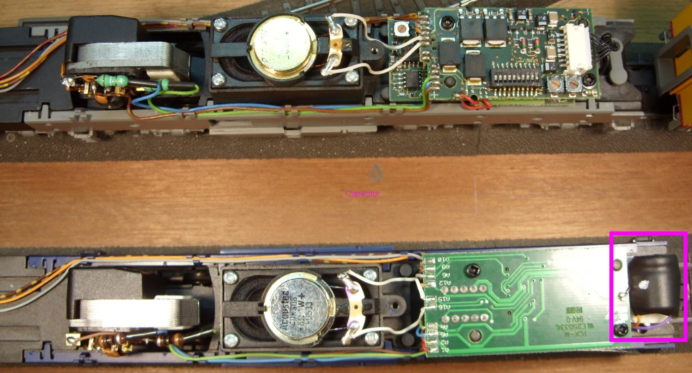

I decided to do a brief comparison between Blue Bird locomotive and my UP version of the PA1. Externally there is no difference other than the colour scheme and the misaligned horn. Underneath the drive gear is identical, same metal gears and 4 traction tires.
Internally the motor is fitted with only one capacitor, the decoder is different and there is one humungous capacitor fitted near the circuit board / decoder. The loudspeaker is the same Acoustec product as before.
Once on the track i noticed two differences. The Blue Bird crawls very well at very low speeds and the sound effects improved. It crawls at 1km (the lowest selectable speed on my controller) without any jerking / stuttering at all. The UP version starts jerking at 3km. The additional sound effects are good, the compressor blow off, brake squeal and diesel engine shut down is really convincing.
And the surprise; the amount of current drawn by the coach lights, ± 700 mA (all coaches connected). Any other members who have checked the current consumption on the coach lighting? I assume the lights inside the coaches are incandescent globes.
The mechanical sound levels generated by the locos are very similar. The weight of the locos is the same at 774 g.
The settings which i changed are: The maximum speed setting
The acceleration delay
The deceleration delay
The sound track volume
The speed table (to a more linear response)

Marius, thanks for the internal pictures. I agree with your observations. It´s very similar to my 37610 as well but many improvements.

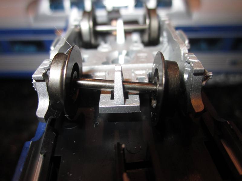

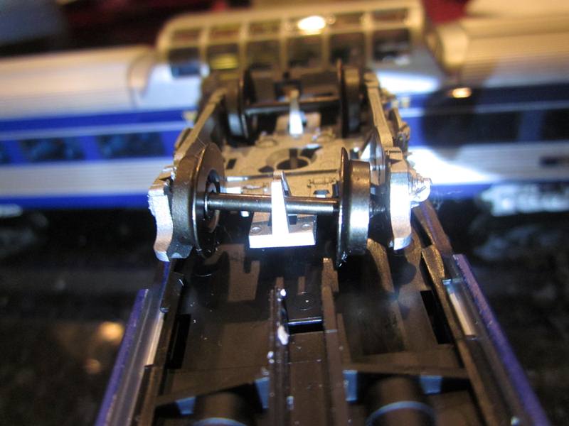

I just recieved my Blue Bird yesterday and my initial impression was WOW!.
However I did notice a couple of the signs lifting off as mentioned in other posts. That is easily fixable.
However 2 coachs have one of their wheel sets pushed in too far to widen the frames so that the cone bearing on the wheel set will slide past.
These cars will not run on the track. This has happened to me before on a hobby set where the packaging was too tight.
For an expensive exclusive set, I am not impressed. I had more fun and satisfaction from a basic start set.
Will discuss this with my dealer and Märklin.
Have attached images but not in the order that makes sense. First time for everyting.
201 Truck End and 201 Truck Top show one of the 2 bent trucks Bad Truck 201 shows the other truck.
An example of the Glue Fuss is also included but it was easy to wipe all off with a clean microfiber cloth.
The Bullet Lighting and the Scenic Lighting images are a good example of the only lighting variance I have with this set.
The bullet car seems to have weaker lighting on the opposite end of the bullet. The rest of the train has great lighting but I would perhaps tone down the dining car lighting.

The Bullet car(Park car for Canadians) is slightly dimmer, probably due to the LEDs drawing a little Voltage.
I did add a piece of black construction paper to block out as much as the LED lights that spilled out to the passenger car. The LED is used for the marker lights.
I also moved the dining car a car length away from the Bullet car so that the dimness is not as noticiable.
Now I need people inside!
