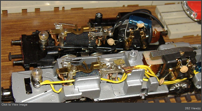

I've received a blown up BR140 (3156) and after some cleaning and care it runs very smoothly now. Only problem with it is that reverse unit works, but it works "too much". When I turn the controller knob to change direction, even if I keep knob pushed for a very short time, the reverse unit changes direction 3 or 4 times very fastly. If I keep the knob pushed, the reverse unit does not stop "reversing". It's like the reverse unit was shooting.
It is the only reverse unit I've seen working this way, and I assume it's faulty. But I don't know if it's an internal problem (and therefore solutions is somewhat difficult) or a wiring problem (and therefore easier to solve).
Any ideas?

Are you able to post up a photo or two of the internals so we can see the actual reverse unit and wiring?

I'm attaching a couple pictures of the reverse unit and a video which shows what the problem is.
So far, I can not see anything wrong in the pictures (the reverse unit is wired like other reverse units which work just fine).
But check out the video and you'll see what I mean. The problem does not seem to come from the spring.
Thanks for your ideas.

Just from the picture I reckon you've got the wrong spring on there - the adjustment arm is quite a long way back and the spring just does not look 'right'.
If the spring is wrong, you'll certainly get the symptoms you are describing because the magnet field is trying to overcome well beyond what it is designed for.
I need to recharge the batteries in my camera but I'll take a photo of my unit so you can see the difference.
That's my interim diagnosis anyway. Do you have a good working loco that you can swap the spring from to test? - you'll need to adjust the spring adjusting arm as well though.

Looking at the picture you've provided, it is clear the that the hook the spring is attached to is too far to the right.
Try and bent it slowly to the left and see what happens. (neutral position)
The spring itself its to hard to establish if it is the wrong spring or not.

Attached is a photo of two loks side by side, a 3000 and a 3016 - I am now not so sure that your spring is wrong, but the adjustment certainly is and you should start with that.
You place the blade of a small screwdriver right into the corner where the extension comes out from the main part on whichever side you want to move the arm away FROM, then you VERY gently twist the screwdriver to make the adjustment.
So looking at your image, the arm is clearly stretching the spring too far which will mean the magnetic field is not strong enough to activate it properly.
CAUTION - Adjust it gently and in small steps - the metal is deliberately soft but is easy to break if forced too far. The idea is to move in small increments and test, then adjust further if needed.
Give it a crack and see how you go, I've also attached an image from a service sheet which shows perfectly what I'm talking about. You can view the full leaflet here....
That's the first thing I thought when I saw the picture of the reverse unit.

Many thanks Cokee,
Unfortunately, as I wrote in a previous message, from the symptoms shown by the reverse unit it was unlikely that the problem had something to do with the spring, as:
If spring resistance is "too strong", the reverse unit will just not "reverse", or the reverse will be delayed so, before reversing, the locomotive's "jump" will be more noticeable.
If spring resistance is "too soft". locomotive will reverse at half throttle.
In any case, the reverse unit will not "shoot" like in the video attached.
"just in case", I removed the spring and tried with some other springs, softer and stiffer, just to check if there was some noticeable improvement. As expected, nothing improved, and the reverse unit continued "shooting" no matter how the spring was attached, or which spring was used.
This morning I've been checking the unit and I've noticed that if the reverse unit was hold from the coil, the problem disappeared.
Further experiments have shown that a little pressure on the coil side (the place where the black cable gets into the coil) makes the unit work properly.
So it seems that the problem is that the contact between the black cable and the coil is somewhat "random". I have solved it (at least for now) by using a little strap around the coil, making it a bit tight. Now it works fine with the original spring.

Well done, certainly sounds like you've nailed it down - the black wire (fly lead) is soldered to the very fine copper wire from the reverse unit winding so a poor connection there could give you problems for sure. A purist would probably want to resolder the join, but at the risk of making it no longer work at all.
You have found a simple solution which may well last for some time - "if it ain't broke, don't fix it"
Certainly not what I would have picked as the problem, although the hints about checking the wiring were at least on the right track as the symptoms seemed to imply insufficient energy to the winding to reliably activate the armature.
