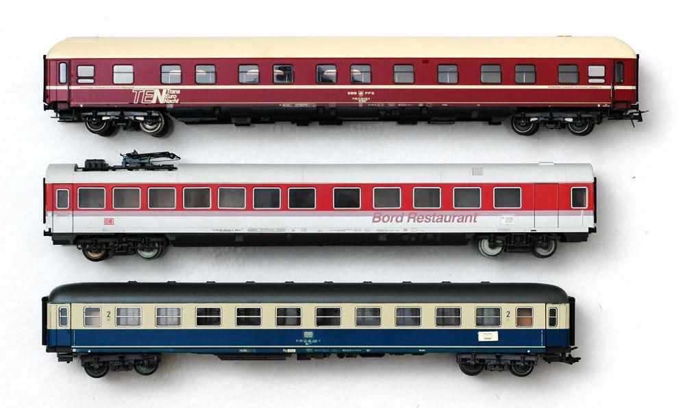

Below is the picture I took to compare the length of different scale.
upper; Roco 1:87
middle; Fleischmann 1:93
lower; Marklin 1:100
Length comparison

I'm comparing Marklin's 1:100 coach to Roco's 1:87 on the same coach type (the DB intercity passenger coach). On Marklin coach, sometimes I have to cut the figure near waist level, otherwise the head will be higher than the window.
On modern coaches with large windows (such as the double-decker), I can easily see those amputated legs. Therefore I stopped buying Marklin's 1:100 coaches

The interior details are all produced in the same scales as the exterior body of the coaches, except for compromises required by the design of the undercarriage, which may be thicker than that of a real coach, resulting in a little less space inside the coach. In order to properly position the seats vis a vis the windows, some manufacturers have reduced or almost removed the space under the bench, requiring that figurines be modified to suitably fit inside the coach.
hi Mike,
you're right to certain extend. But you have to remember that by reducing the length of the coach, they have to reduce the leg-room between seat to maintain the same number of seat. This is approximately around 15% reduction. So the 1:100 is indeed has different room size than the 1:87 even if everything else is the same.
Combined with Marklin's outdated 1960's interior details, we end up with a very compact room.
(But now I'm willing to try the new Marklin's 1:93 Silberling since they said it was developed using "new tooling")
The choice of which "Silberlinge" coaches you end up buying is up to you. You may even decide to go with the 24cm metal ones if you can find them. They may not be the best looking, but they have a nice look and that classic Maerklin sound.
Personally I prefer passenger coach with well detailed interior. I will try the new Marklin Silberling. If its interior is still not much different than their old coaches, then I will replace them with Roco.
