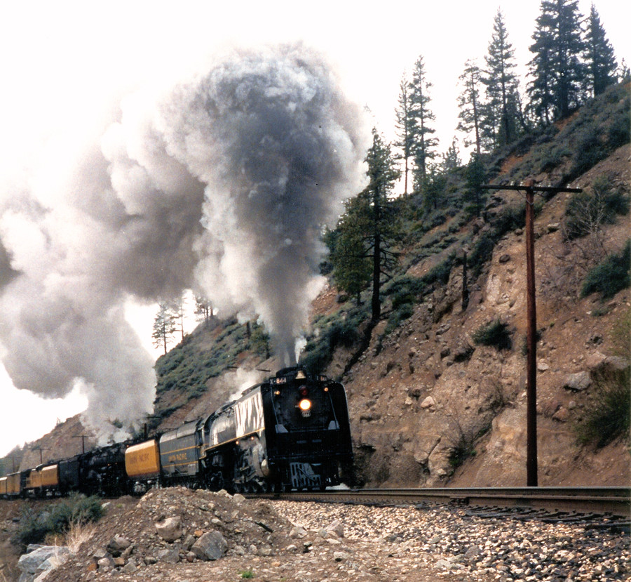

#19 Posted : 22 March 2011 18:10:27(UTC)
Originally Posted by: RayPayas Go to Quoted Post
Tom, if you read the wiki article it actually says that only Compounds were refered to as Mallets originally, but the term came to be used for simple expansion locos as well.
That's what the English wiki article says. So when you speak English, you can say Mallet to any articulated loco.
The German article (sorry, the link doesn't work) doesn't say anything about a widened meaning of the term Mallet.
"Periodically, I hear the Big Boy referred to as a "Mallet". Technically, this is not true. Anatole Mallet designed his steam locomotive that 1) was articulated, and 2) used compound expansion (high and low pressure cylinders). The Big Boys, as well as many other articulated steam locomotives, used simple expansion, and thus, are not true mallets."
http://www.steamlocomotive.com/bigboy/
Not true mallets? Untrue mallets? Mock mallets?
"What's the difference between ignorance and indifference?"
"I don't know and I don't care ..."
HI All,
Interesting exchange..a long standing conversation object these articulated , Mallet or not!
Maybe this should be discussed further in the prototype question, but there is a very significant difference between Mallet (compound locos like e.G the BR 96) and the 4 cylinder single expansion ones (like e.g the Big Boy, the hypothetical BR53,etc..)
The Mallet had an inherent flaw in its design!
Running forward, under heavy load, the front chassis of of both tytpes would have a tendency to lift, and starting to slip.
But the Mallet, having their rear HP cylinders' exhaust feeding the front LP ones, the slippage of the front wheels causes suddenly a much bigger steam consumption.
This would immediately create a big drop in pressure at the exhaust of the HP cylinders.
Since the power a cylinder can develop is proportional to the pressure difference between intake and exhaust, there would be also a sudden increase of tractive effort on the rear HP chassis, with the danger that these "shocks" could in turn induce slippage of the rear wheels!
Soon you have a loco that slips from all its driven axles...although the design was supposed to avoid that phenomenon!Bored Blink
So driving a true "Mallet" requires quite a good feel and quick reflexes to cut the throttle as soon as slippage of the front is detected!(Usually, from the vibrations and a sudden change in exhaust rythm,!)
I experienced it myself when I was for a brief moment at the throttle of the little Mallet operated by the Blonay Chamby RR Museum in Switzerland.Scared
On the other hand, the Big Boy and Challengers incorporated a couple of design improvements, aimed at reducing this tendency.
First of all the chassis, albeit articulated, was designed with reinforced pivots and large horizontal sliding surfaces to prevent any vertical movement.
This way, it was much harder for the front chassis to start slipping, having the weight of the whole length of the lok to push it down..ThumpUp
Second, the steam machines being fed independently, slippage in one set, doesn't automatically induce slippage of the other.ThumpUp ThumpUp
Again, having had a chance, for a short while, to be at the throttle of UP #3985 on the Feather River route in California, on the 1991 Shippers' Special, I witnessed that 3985 was easy to control and able to restart the whole consist on its own...without the slightest hint of slippage. ( I gotta exhume the pictures of that event, and share it with you guys, but here is a little preview to give you a feel (The Challenger is the second loco in this picture of a simulated restart with wide open throtles and oil burners!!Woot Woot Wub )
http://www.fotocommunity.../542493/display/19788876
Hope this helps...excite your imagination when you run one of these on your layout!! Laugh

#21 Posted : 22 March 2011 22:21:19(UTC)
Originally Posted by: GSRR Go to Quoted Post
Well I certainly learned something today, thank you all.
Jacques, most interesting story, on the lookout for more. Can you check the photo link, goes somewhere else for me?
r/Thomas
Here's the uploaded directly here (note this is a scanned from print analog picture from 1991, forgive me for the poor sharpness)
