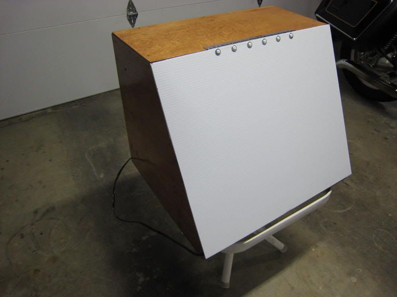

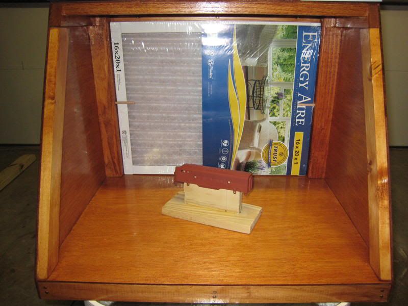

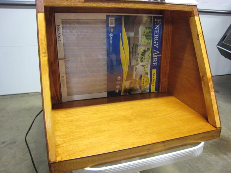

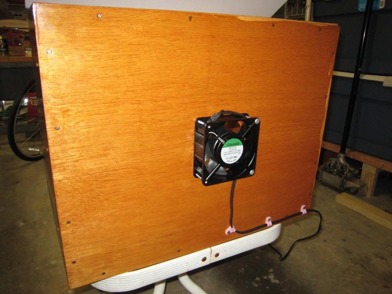

Using this web site as a guide I went ahead and built my own modified version. The computer fan is 110v. I added a framed base to it not shown on the illustration, reinforced luan paneling for sides and shelf, and my cover is the corrugated plastic sign variety. I mulled over what to paint it but had so much stain and poly on hand I had to use it. This will help in controlling the dust. The filter isn't unwrapped in the photos but it will stick to the plenum frame without the use of the dowels by the suction force of the fan so I'm sure it will be sufficient once in use. The only material I can't find readily is the plastic dryer tubing I'd like to vent the exhaust with out of the garage. I think everyone has the metalized tubing now because of the fire risks with clothes dryers but I'll find it or a good substitute. I may use plastic downspout tubing in that I can configure it easily to fit. The cost of material was under $50 so far. The labor? That's another figure but I had some free days and some cold beer to get done with so good enough. Please don't judge my workmanship. If I made it from cardboard, as I saw elsewhere, I'd have an excuse. But I had a jigsaw and straight enough wooden board clamped to a wood bench as a guide and ripped it all with that. I was going to hide the corners with trim but that is almost as expensive per foot as the lumber present and, after all, it is a paint booth. I hope it will last me a few years and I'll be happy with it. After the pollen season I'll get started on the long procrastinated projects. Thanks to you all for your time and suggestions.
Roman[img]null[/img]Paint Booth 1Paint Booth 2Paint Booth 3Paint Booth 4

Looks really good. The dust cover/door is a good idea so your work can dry without dust settling on it. The have you tried the fan to see how much air it moves? Will it be enough or will you need to add another?

I think one will be enough. I tested it only with the filter, that is still covered in the packaging, and it sucked it into place with enough force IMO. I just finished it and haven't given it a test drive so to speak. I'll get the ducting done this next weekend and give it a good test with a spray can.

The booth looks really good. It's almost a shame to ruin the insde of it with paint.
My advice would be: fit some useful gadgets like an airbrush holder and paint/thinner jar holders. I would really reccomend the former. Airbrush needles cost $20 if you bend them, and an airbrush is useless without it's needle. I know this from experienceCursing A bright light and paint stirrer holders are also very useful.

Computer fans:do they have enough air flow rate?Some paint solvents will cause them to fail.
Dr D
I tend to not to want to spend money on items that I will hardly use. If I was painting for a living and used it every day I can see spending several hundred on something built to last and would protect my self form dangerous toxins.
I find it hard to imagine how long it would take to have paint fumes eat the coating off the motor coil.
A charcoal filter in front of the fan would handle most of the vapor and the motor is mostly out of the air stream.
I know there are some high volume computer fans out there designed for game boxes so I would think that you could use 5 or more to create enough pressure to flow through filters and still draw the paint away just depends on how big of an area you need to work in. It might take some experimenting to get it right.
Another item that would work is an electric fan off of a cars radiator, a used one might be found cheep and it would have enough volume, all though you might suck all the paint away form what your painting.
I like Darren's ideal of the vent-a-hood, I wish now I hadn't through the one away that was at the old house.
Uh huh, now another little postive to add to the balance sheet of installing a whole new kitchen, instead of building my dream layout room,Blushing I can make good use of the old range hood, shame I threw out the carbon filters a while back Cursing
I wonder what the Kitchen designer will think about my idea to have a paint booth right where the current cook top is Confused LOL
