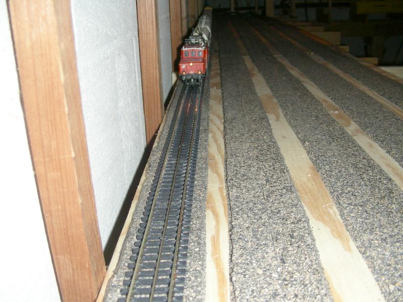

I also used Atlas flex track. It is relatively cheap and looks good. I used code100, just because that is what my K track is. Incidentally, I also used this track in the hidden sections of my expansion to save a lot of money. I bought code55 rail from an N-gauge supplier to power it and hot glued the code55 in the middle. works great.
Here is how it looks:
By the way, here is my display case:
I got it from Custom Display Cases in Dallas PA (near York)
-Ron

A picture of my display, dating from the moment when I build it.
The bottom shelf is the frame of display. Here I have track in ballast.
The shelfs are 6 mm glas.
For a test I have placed K-track. Notice the ugly shadows of the slepers on the middle shelf on the picture.
The top shelf on the picture has track profile directly glued on the glas.
This is done by double sided sellotape.
Power to the rail profiles via metal strips in the grove that supports the shelf.
My display is in use now over 25 years.
The sellotape last extremely long. Sofar I have renewed some small parts on a few shelves.
A benefit of having only rail profiles is that the underside of coaches and engines is visible.
When you want to know more, do not hesitate to ask.
