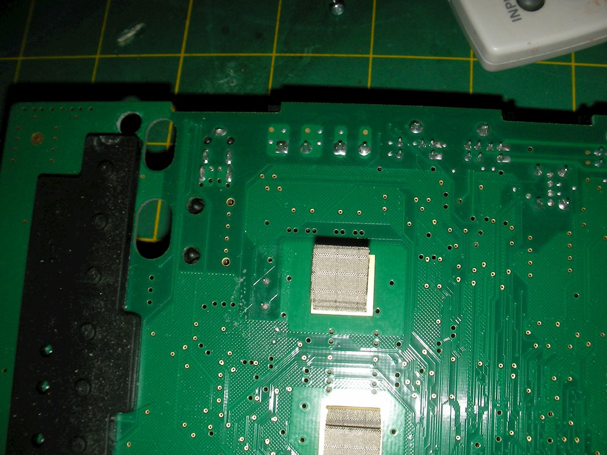

here is a couple pictures of the inside of the 60213 circut board and the bridge rectifier.
http://www.irf.com/produ...sheets/data/50wq06fn.pdf and the data sheet for the Schottky rectifier thats used.
darryl123 attached the following image(s):
thanks 1 user liked this useful post by darryl123
Darryl123
Was this a repair, or just opened it up to see inside?
Offline darryl123
#49 Posted : 20 December 2011 02:13:26(UTC)
darryl123
Joined: 17/05/2011(UTC)
Posts: 20
Location: boston
hi
i had opened it to try to find what polarity the connectors are to use a dc power supply. i couldnt follow any of the traces it has a multy layer pc board. i did take lots of pictures so if any are needed i have them. i ended up using a switching power supply on the ac inputs and its working great. with only .5 volt drop from input voltage.

Originally Posted by: GSRR Go to Quoted Post
So would the following be correct? With the older 6001/2/3 or 60052/55 supplying 16 volt AC output voltage to the top two pins and the newer 60061 supplying 19 volt DC output voltage to the bottom two pins?
r/Thomas
hi
Darryl123
Is the above graphic correct in terms of which pin inputs for AC and DC connections?
What type or brand SWP are you using?
r/Thomas
