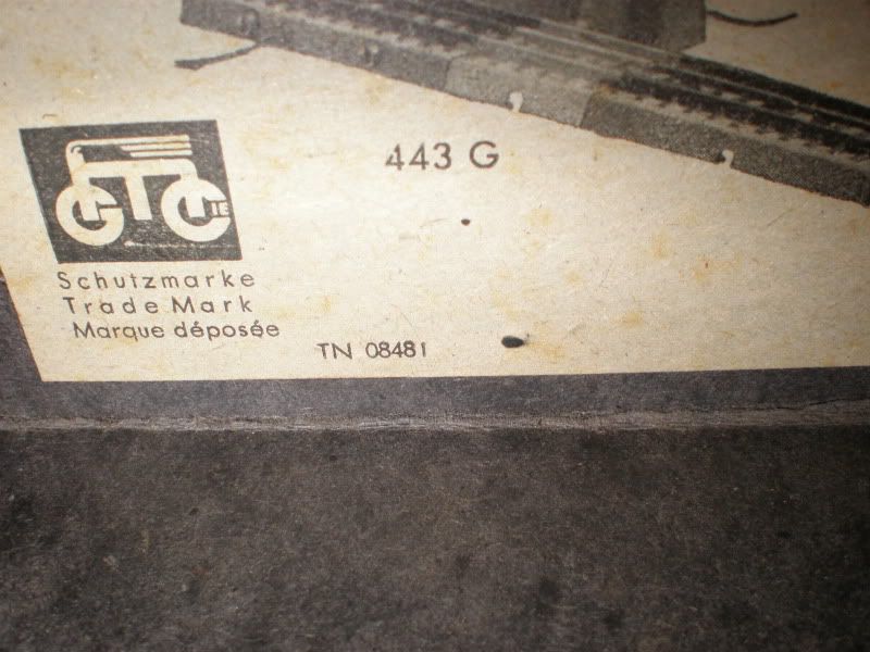

Another thing. You can see when your set was made by looking in the bottom left corner of the paper on the backside of the cover:
Mine is from August 1948.

Nevertheless, in the box are figures that gave the date of the production "TN 08481" which seem to say that date is 08.1948 (August 1948)
