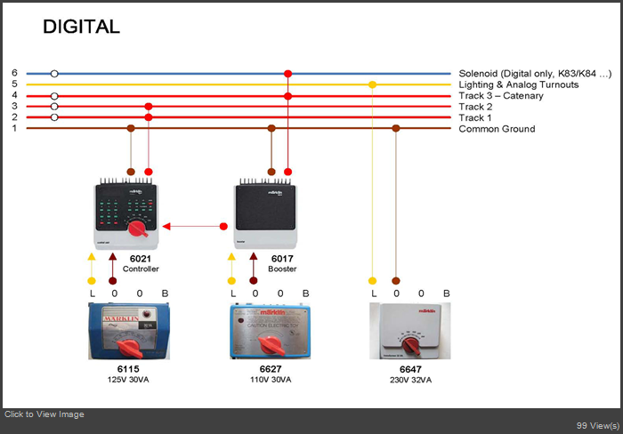

#25 Posted : 19 November 2009 11:02:09(UTC)
Ian, you can't, unless you buy the 60111 connector box.
To use the ugly box, plug the MS and transformer into it. Take the red and brown wires off from underneath the track of the ugly box and connect to your M track feeder piece in the normal way.

#27 Posted : 19 November 2009 11:55:41(UTC)
You need to connect the ugly box to the M track. As I say, take the brown and red wires from the terminals underneath the ugly box rails, and connect those to your M track feeder piece.

Concerning general "bus" wiring for a 3 track M-track layout planned in anticipation to go from analog to digital while recycling old transformers, here is one solution (which I'm still testing ...), proposed by Tim Eckert : see pics below ...
Any feedback on this from one and all would certainly be helpful ... ^^
