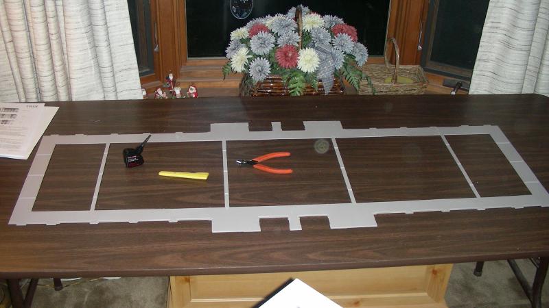

And here is the base plate all glued together:

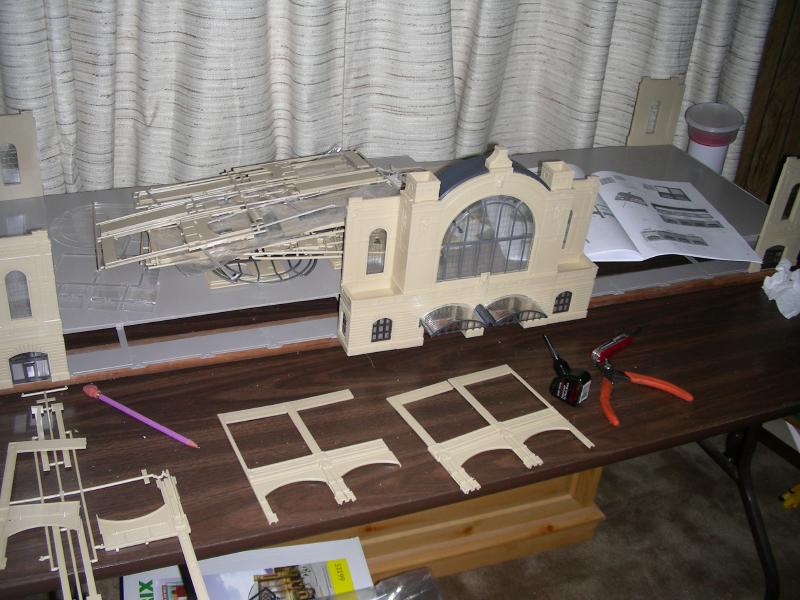

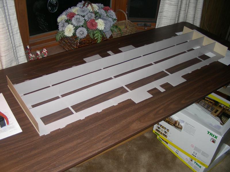

Back to my project, last night I got the end walls and the support structure for the station level done.:
Edited by user 15 January 2010 23:26:55(UTC)  | Reason: Not specified

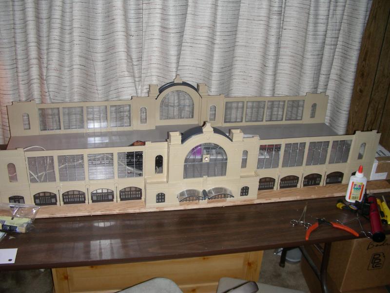

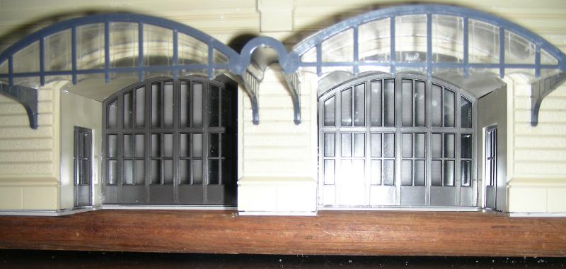

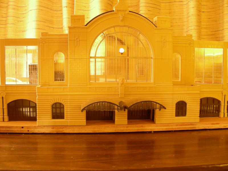

Got one of the nain entryways done. This is moving slowly but I am taking my time.
The detail is very nice on this kit:
One problem I found is that the station is so long, any curvature at all on the table affects the way it fits. The table I am using has a slight curvature and I had to put a couple of very straight boards under it to make everything fit right.
Edited by user 15 January 2010 23:27:23(UTC)  | Reason: Not specified

Some people who have build this station have used reinforcement beams for the walls.

Ron: Since this is so big and sensitive to a level foundation, have you thought about how you will safely move it? You probably have to move it at least once? If you are permanently going to mount it to the 3/4" plywood, then I guess that is the answer.--MM

Michael: Yes, that is my thought. The plywood will be it's permanent base

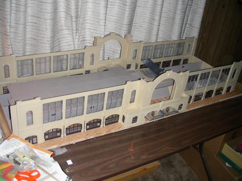

Just a quick update: Here is the current status of the project. As I said, I have been busy on other things for several weeks, but can now get back to this. I had to remove the station floor, one end of the structure, and some of the floor support ribbing to get the walls to fit. After I have don the exterior, I will then reconstruct the floor. I also had to cut a piece f 3/4 inch plywood to support the station and keep it from sagging.

Update time. I have finished the roof structure. The roof panels (except the center) just slide on so you can get access to the station.
My next project is to build lights for it. I am constructing six light assemblies (three for each platform) each using three Viessmann 63652 LED Bahnsteigleuchte assembled on a Plastruct 90043 channel. I drilled a small hole in the channel and passed the wires through (after cutting off the resistor and diode).
Then I soldered the three lights in series. I then pulled the feed wires at the end of the strings through another channel and glued that one on the back of the other to create a closed structure.
After installed in the station, I will add one diode and one 1k resistor to each light assembly. Should provide sufficient lighting.
-Ron
