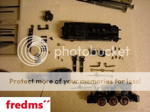

I got two TM800.
A very nice one, I placed a few pictures at https://www.marklin-user...ult.aspx?g=posts&t=13214
plus another one, without box and in very bad situation.
I'm trying to "recover" it and than I will try to put some pictures about it.

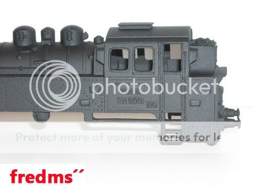

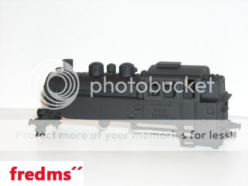

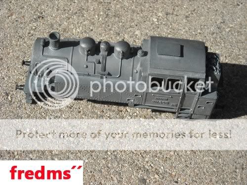

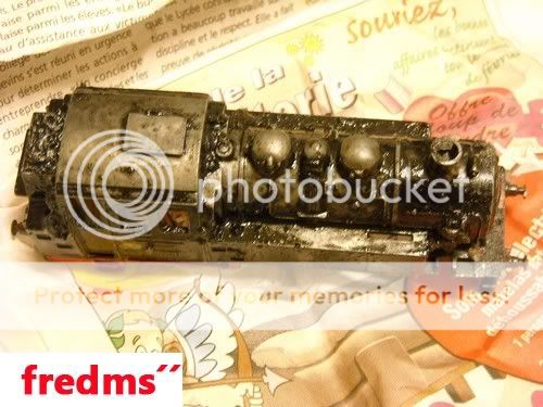

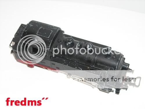

Here we go:
raw metal!!!
Primar!
Painted!
I'm thinking about buying a set of wheels for her. I still need to paint the red areas.
