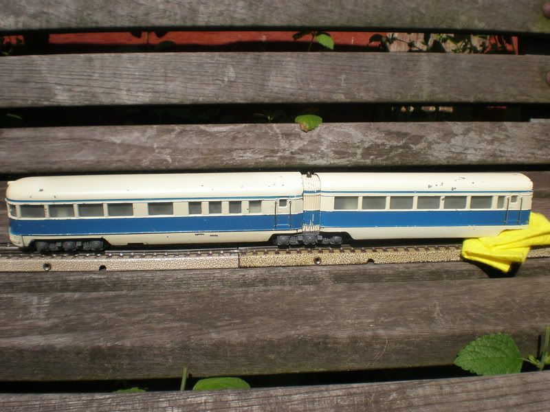

For about 4 years ago I bought a big lot of vintage Märklin from the beginning of the 50's on a market here in Denmark. It contained among other things the two passenger wagons for the big rail car ST 800 in blue. Unfortunately the motor car was missing[V], which, in my opinion, is the most important part. After a search of almost three years, I have given up finding only the motor car on eBay, so I have decided to build it myself of original parts and replica parts. Some days ago I won an auction including some very old parts for the motor car, the power boogies and some parts for the motor, so now I am a very little step closer to have the motor carCool. I am thinking of buying the frame and the body as replica parts from ritter in Germany, because the chances are almost equal to zero that an original body for the motor car in blue shows up on eBay. I think I am going to make a first or second version.
If anybody could provide me with some pictures of the inside of the motor car I would be very grateful. I need to know how all the wires are connected inside of it and also what colors they are.
I will keep you posted when get more parts and start to assemble it.

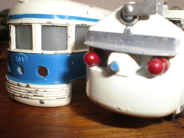

Here are two pictures of what I have right now at the moment:

As far as I know there is only one screw. The frame for the rear wagon is the same for the motor wagon. In the front of the wagon between the front lights there is a little dot, which holds the body in place. Maybe the body is stuck there?
A pic of the dot (don't know how to express this in another way):
Just take your time to take it apart.
Thor
