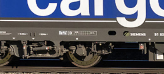

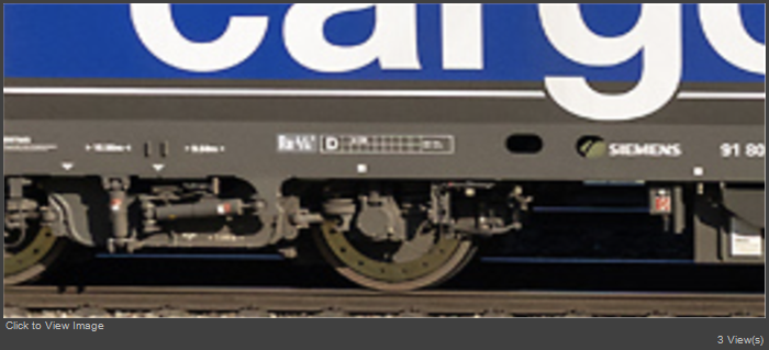

I noted that on the Märklin model (39337), there is a plaque labelled Re 4/4 to the left of the UIC Table. I did not know that these new locomotives had in any way been designated as Re 4/4. I did some searching online and found that this marking does exist in the photo linked above (railpictures.net).
I could not find this marking on any other photos of this series, nor does it appear on the Roco model. Perhaps one of our Swiss experts knows something about the meaning of this.
