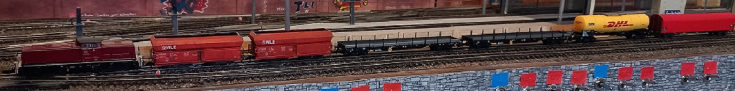

Following Chris' report, I decided to investigate the traction power for myself. My steepest grade is 2% and this is the longest train that the v90 could get up it (going at full power!):
Crying Blushing
Secondly, just to mention, out of the box the front coupler was drooping rather badly. But a quick twist and push got it to sit in its box properly. Otherwise its performance is excellent.
