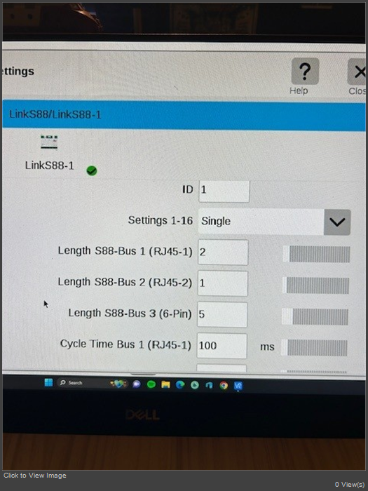

Hi team,
I have a cs3 , with a 60883 connected, which is working fine.
I am now adding a 60881 with cat5 (connected the cat5 to bus 1 on L88, and to the out arrow on the S88)
I have set the L88 settings in the CS 3 to 2 for bus1 0 for bus2 and 0 for bus3. Although when I restart the CS3 , it changes the L88 bus length to bus1: 2 , bus2: 1 and bus3: 5, which I m not sure why it does that.
Anyway my 60881 is not recognized , yes I am on the latest version of CS3.
My 60883 L88 is set to 12 V
Anything I can do to troubleshoot?
I guess one possibility is a faulty 60881 ????
Many thanks

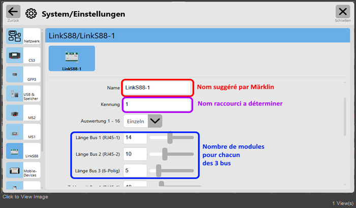

Only the LinkS88 (60883) is recognized by the CS3
Next you have to declare to the CS3 how many modules (60881, 60882, 6088, 60880 you connect to each bus of the LinkS88 (A, B, C) on a screen looking like this
The number of modules is to be inserted for each of the buses (A,B,C)
On the LinkS88 you have a little swich to decide if the entry modules are working with 5 V or with 12 V (5V is to provide compatibility with older modules)
There is no inconvenience to declare a number slightly above the real number of modules (usually, adding one to the number of modules is safe) but declaring a smaller value will result in the non accounted-for modules will be ignored (NOT scanned)

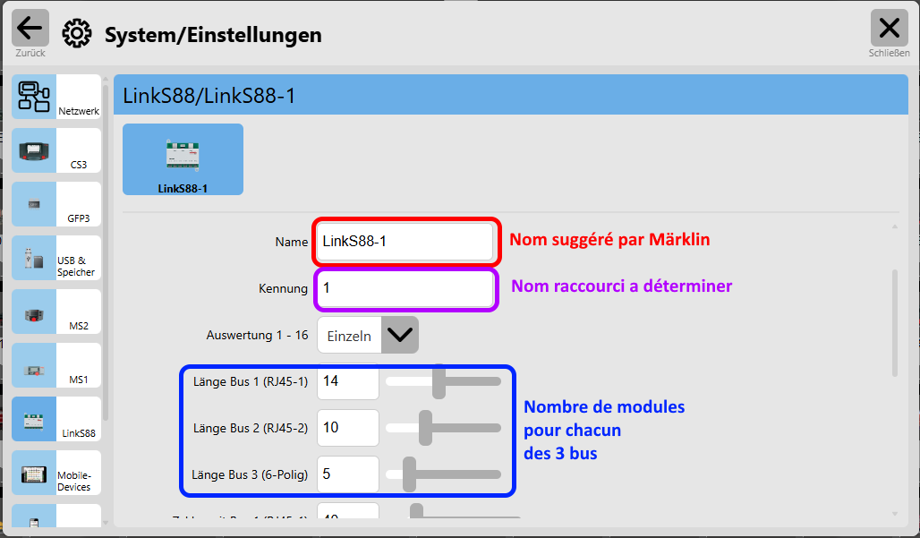

Hi Crikw

Thank you , I have it sorted , I changed to bus 2 and could configure them
First I still couldn't , but I have 3 different circuits (1 cs3 and 2 boosters that were completely separated , it was on 1 circuit that the 60881 was not responding , but I now have linked all 0-tracks together on all circuits and the 60881 has now been working ok.
Thanks you for responding .....
I still trying to figure out how to attach picture88.jpg , I did attach and upload it, but doesn't seem to work
Erik
It has attached fine, as you will see now. It does take a little while (something like 5 minutes IIRC) for the images to appear.
