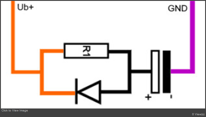

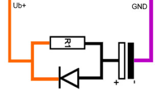

A simple solution should work fine. like a standard capacitor eg 35v 1200 to 2400 uf, and a resistor (100 ohm) and a diode (1a). (Some use 25v)
Use as large a capacity capacitor as you can comfortably fit. Some also use a Schottky diode.
Use MTC pin 16 Ub+ and pin 20 decoder GND (purple). Alternatively, you can also use the SUSI socket, pin 4 Ub+ and 1 GND. (they are connected to pin 16 and 20)
There are more posts on the forum on how to make one and some variations etc.
I used this diagram

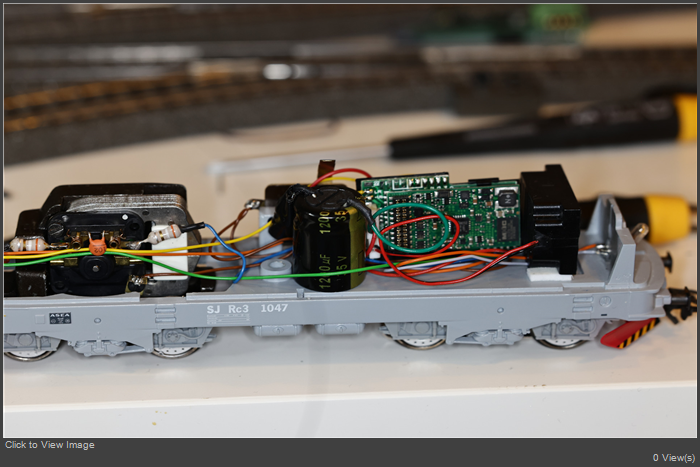

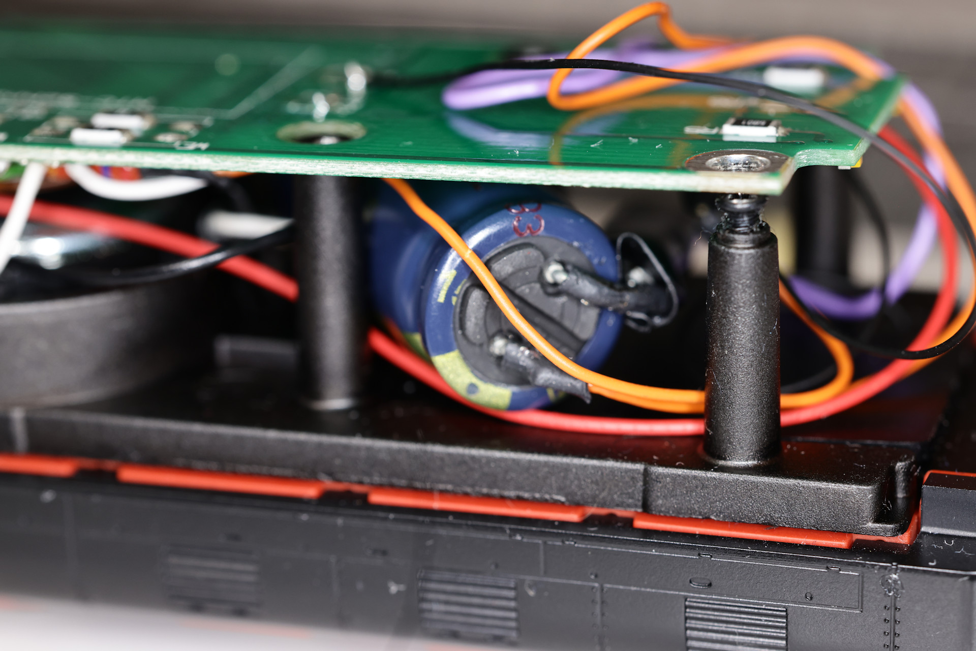

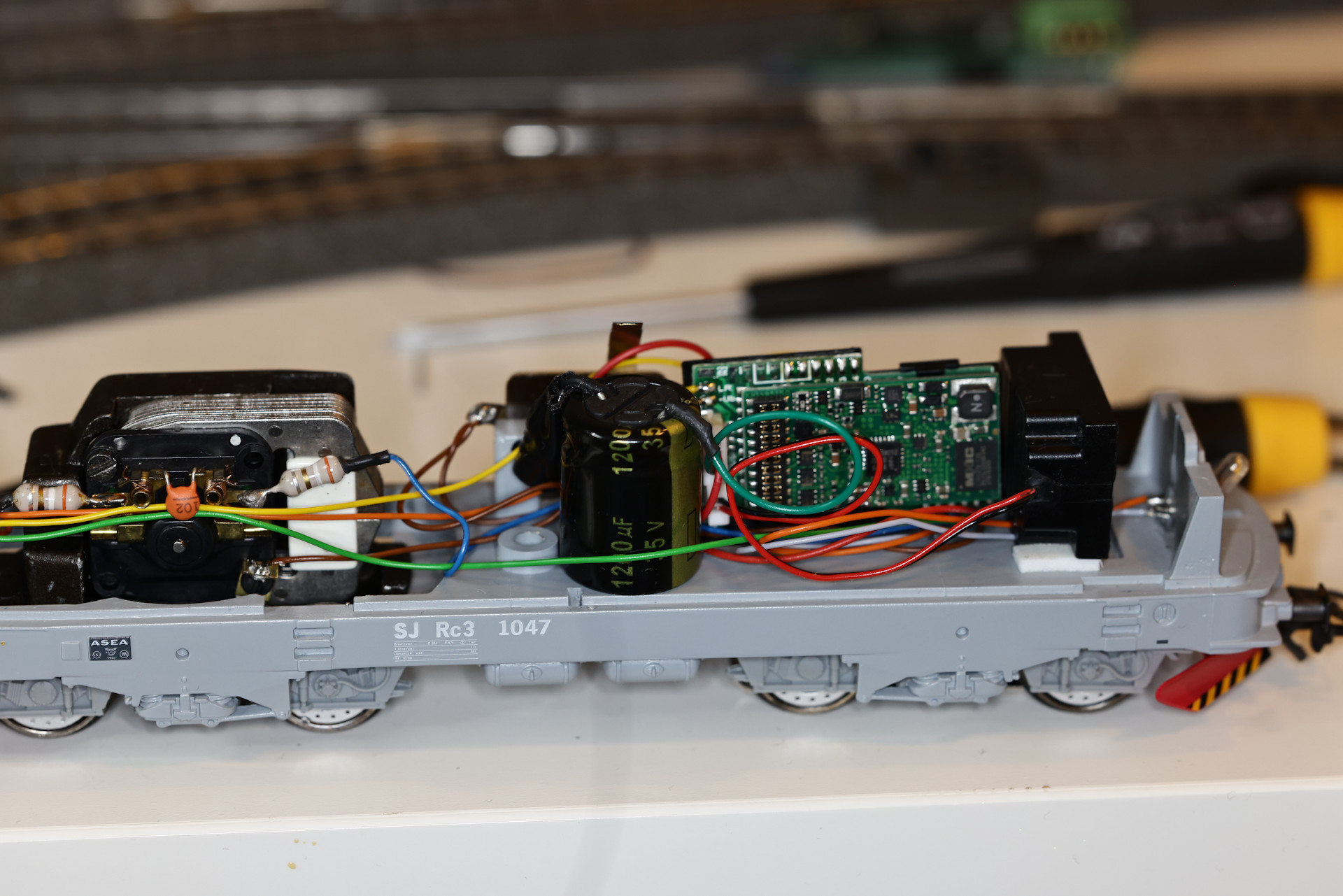

eg here are two different examples from a steamer and a RC3. (Most of my locomotives don't have capacitors; I just fit them when I do other work and if there is space available.)
Longer, "thin" capacitor, approx 1600uf if I remember correctly. it was unused solder pads on the pcb. (the extra wires are to a relay and a power conducting coupler)
And a short "fat" one, but only 1200uf (a little on the lower side). And here I'm using the Susi plug, I got extra plugs from eBay. (just removed the wires from pin 2 and 3 on the plug).
