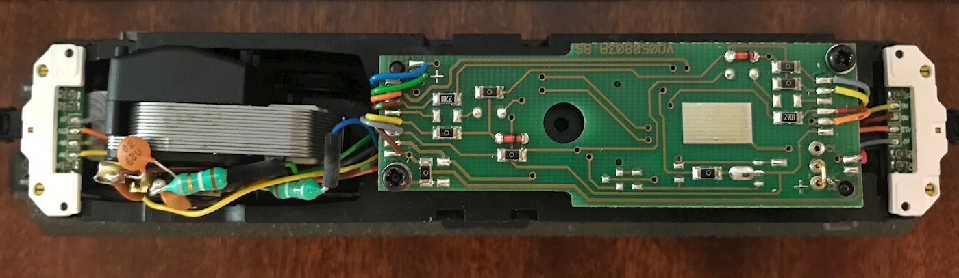

locolocoLoco
Hello:
Here are pics of the loco.
Thank you, Paul

Offline Dave Banks

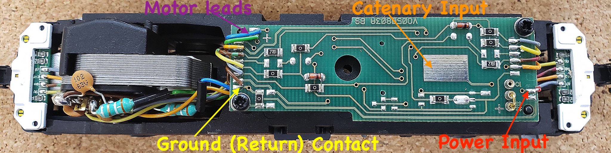

First thing to test would be to verify that there is contact/power from the slider to the PC board via the red cable (second pin on left on non-motor side). You can check this with an OHM metre between that contact and the centre rail when off and with the metre set to 25VAC (Analog/6021) or DC (MS2/CS) when powered.
As suggested, I would unscrew the PC board (2 screws) and carefully remove and reinsert the decoder. I had one incident where a similar decoder was fried because it was inserted inverted and then powered up. I have the ESU profile for the OEM decoder and if your's is not working, you can get a replacement Lokpilot and I can send you the file which you can load using an ESU lokprogrammer. If you order a replacement from Maerklin, it will be a non-ESU Maerklin decoder that may not have the same profile/settings. If possible, can you take a photo of the decoder (top side)?
You can check the slider by switching the jumper to catenary and then running power to the contact plate (large metal rectangle). If the loco works, it means that there is a problem between the board and the slider.
Here is a photo of my model: IMG_6620.jpeg

Thank you Mike for the info. You are correct the chip is dead. Contacts work from both track and overhead. Motor works fine. The chip gave a small plume of white smoke signaling its demise after cleaning the power contacts and applying a little power. I will order a new decoder chip. Very easy to replace.
