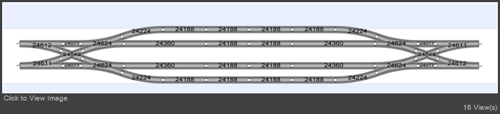

Hello everyone,
I am new on this forum and pick up modelbuilding near the end of my studies again.
Now I am trying to design place for trains to cross over to the other side of the station.
So I use switches into the crossing 24649 and back on the other side.
The issue I face is how to make it so that after they come out of this I can add switches togetter that I can make them switch tracks down the line for at this time due to the gap created by the 24649 is akward to fix and I cant find a way to do it in the designer I am using.
I tried to make the rails get back to a normal distance but didnt succeed in this quest neither in a straight section nor after a curve in the track using different curve sizes.
Who has the holy gail in saving my idea for my layout?

use 24207 - 24094 - 24207 on both sides to bring the tracks back together to the "standard" spacing
