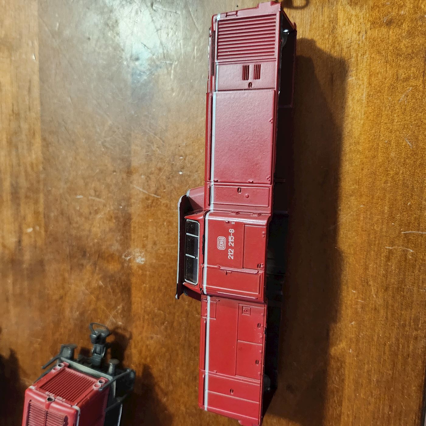

Hi I have 2 trains I have problems with them I can't find an address? I think one is mfx?20250320_105456.jpg20250320_105459.jpg20250320_123030.jpg20250320_123120.jpg20250320_105506.jpg i have a central station 3

The first one is analogue.
The second one is MM only, not mfx. Try MM address 24 if automatic detection does not work.
If that does not work, change the address and write it onto the loco. Loco lights should flash and afterwards loco should work with the new address.

Thanks for Info i will try on the second one the address ,The second one was like you said address 24 Thanks ! the analog one is brooke
is this Mfx cant get it working ?

Yes, the Siemens electronic revers unit/relay was never used for Marklin digital to my knowledge.

Marklin shows two different Railpool engines. One came with a starter set and is fx and the other is mfx. Can't read the running number of the one you posted. Probably fx.
