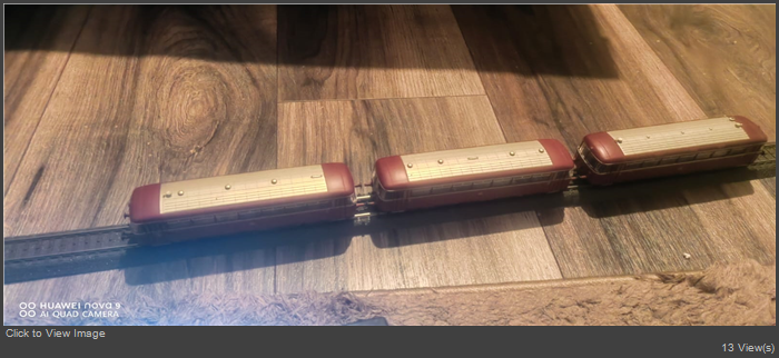

I have an update
1)for roco vt98 it doesn't run/ move either way on DCC or MM , I was using the test track( second option on the back of the cs3+) even if the message was that was able to read successfully
https://www.youtube.com/shorts/BlcSD9uUTdM
2)as for fleishcmann AC
it does work on MM but NOT on DCC . In MM when I input the 38 address manually it worked but before that it says that the reading was NOT successfully - weird
I have 2 questions: is it analog or digital? and can you tell me your opinion about the sound that's coming from the loco, it doesn't sounds good. it doesn't move at 1-2 km, needs more than that.
thanks 1 user liked this useful post by Adrian666
#9 Posted : 11 March 2025 15:10:20(UTC)
Posts: 4,162
Buzzing from a motor isn't good. Is it only upon start off, or constantly? I don't know what decoders Fleischman used, but I suspect it is MM. Remove the body. If it has no decoder it's analog. If it has one, if it's black without dip switches it is either early ESU or Uhlenbrock. ESU decoders today are blue.
