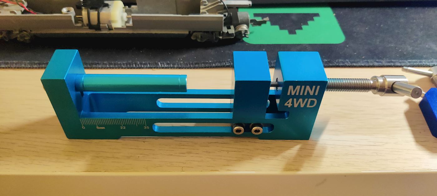

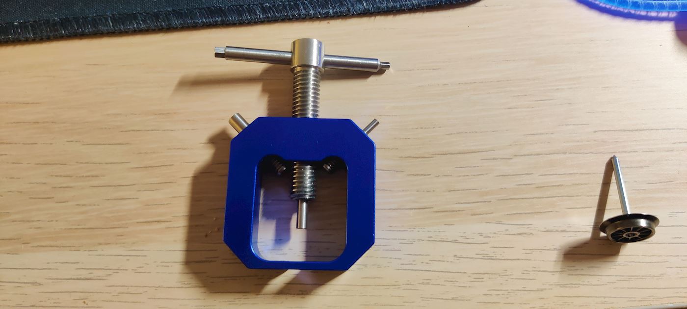

Today was my first attempt to insulate the wheels from this Märklin Loco 36872 Startup Set. I was able to 3D print with PLA some insulators and I was able to fix the wheel into a 2.00 mm axle.
1. First step was to pull out the old axle using this tool:
2. I've made a bushing in Freecad with inner diameter of 1.95 mm and the outer diameter of 2.55 mm.
3. The new axles are from Piko 2.00mm x 25mm which I will adjust to 20.50 mm as the original Märklin axle, when I will get the tool.
4. Using this tool I was able to pushback the axle inside the bushing:
And yes you can 3D print such small parts with one condition: 0.1mm nozzle! This test bushing I've 3D printed on 0.2mm nozzle and tomorrow I will test my 0.1mm nozzle. Also I will swap the printing position horizontal instead vertical because on 0.1mm nozzle the Z layers are 0.05mm which fits perfect the tolerance.
I will keep you update.
After insulating all wheels I will have the next challenge to build supports for wheels wipers / current collectors.

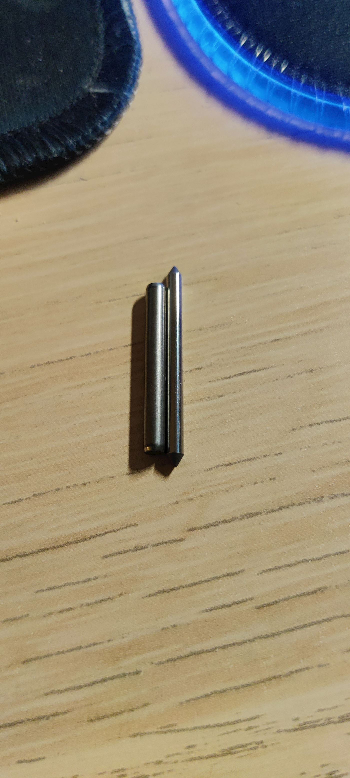

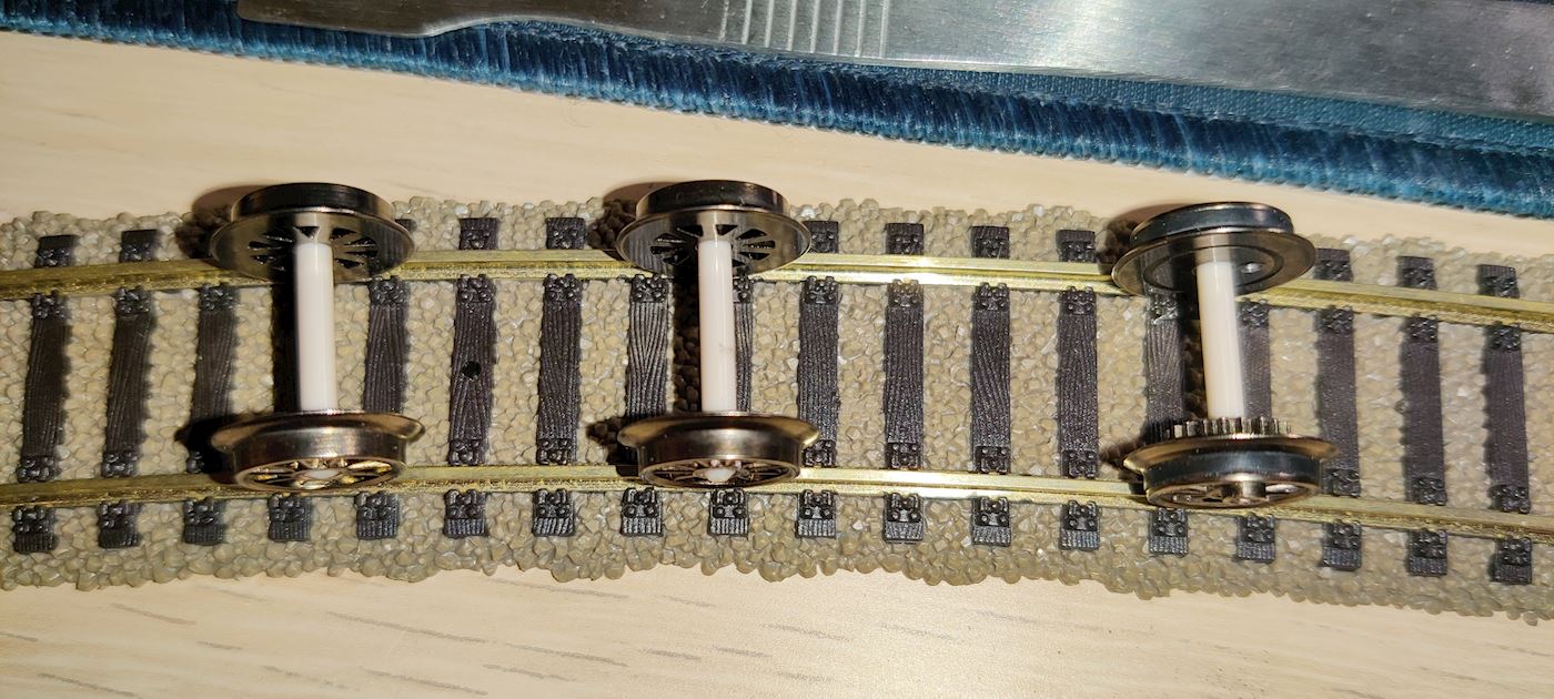

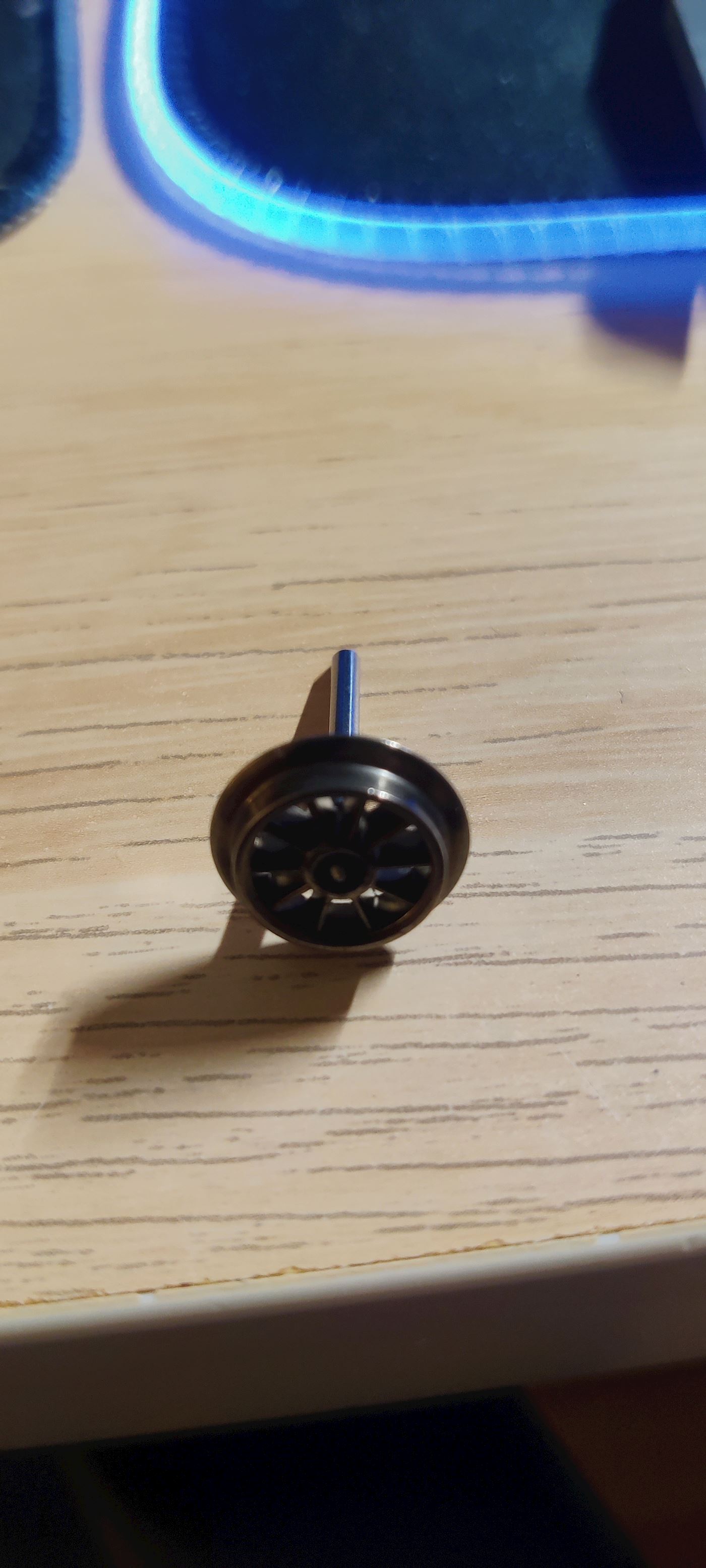

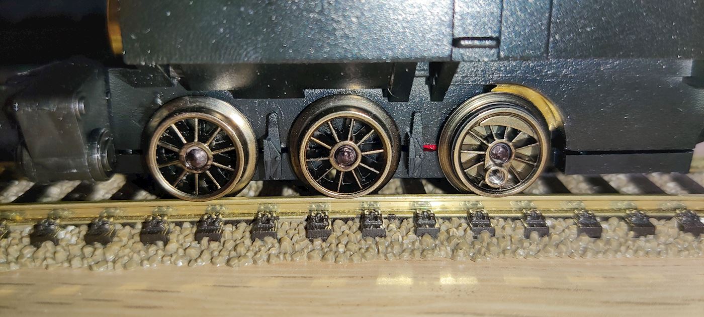

For those which are interested in this project, I just did the first stage of conversion. I was able to change the axles from the original set of wheels with a plastic ones made from PEEK 2.5mm rod.
After I researched a little bit which plastic can be used to replace the metal axles, PEEK was the best one. Is very strong and I had to use pretty high force with wheel assembly tool to insert the wheels into the axles.
Second stage is to install the pickup contacts. Seems the decoder on the loco knows also DCC. In the manual is mentioned Address set at factory: MM 78 (see page 4) / DCC 03.
I will connect on my ESU programmer to check it.
Here are some pictures with the modifications of the wheels:
