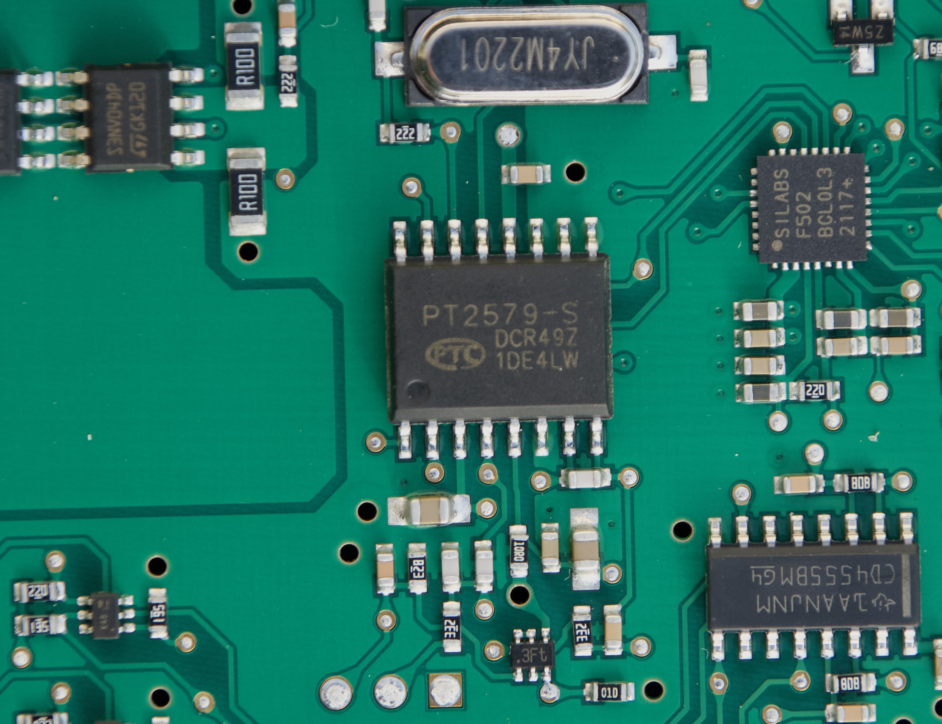

Thank you for your response and for pointing me to Stefan Krauss's documentation. I am indeed familiar with his work, which has been instrumental in developing my MFX command station. However, while the document mentions RDS and describes its theoretical operation, it does not provide detailed information about the electronic implementation.
Specifically, I am looking for a clear electronic schematic or practical guidance on how to connect an RDS feedback circuit to an ESP32. For instance:
How to handle the PT2579-S chip for RDS decoding?
How to process the returned signals to ensure compatibility with an ESP32 input pin?
If you or anyone in the community has more information or examples of such an implementation, it would be incredibly helpful.
Thank you again for your time and support!
Christophe

Note that Marklin use an RDS chip in the ms1 to receive the mfx feedback, but that is the only place I am aware that an actual chip is actually used. The clocking rate for the chip is NOT standard RDS clocking rate. On the ms1 the RDDA and RCCL signals are used to transfer the data to an SPI port on the microprocessor.
You should be able to work out how to emulate the PT2579 from its data sheet. I would expect most modern microprocessors would do that pretty easily, especially if one with DSP capability is used, such as a dsPIC33 family device from Microchip.

Hello and thank you for your reply.
First of all, it should be noted that Märklin still uses the PT2579 component in its command stations, including in more recent models like the MS2 (I opened an MS2 to confirm this).
When searching for a dedicated component, my goal was to avoid the need for software-based filtering. I am using an ESP32, which is not particularly optimized for complex DSP tasks. Indeed, for operations such as intensive real-time filtering or frequency analysis, its performance can be somewhat limited.
Additionally, the processor of the ESP32 in my command station is already heavily utilized by the track signal encoding, which relies on a 50 µs timer. This leaves little room to efficiently handle a fully software-based solution for processing feedback signals.
That being said, I appreciate your suggestion. Exploring a software approach remains an interesting option, and it could be feasible if I were to add a dedicated microcontroller, such as an ATmega or an ATTiny, to the command station to offload this task.
For now, however, I am prioritizing the use of a dedicated component, such as the PT2579, TDA7330, or TSA5511, which could greatly simplify the process.
Thank you in advance to anyone who can provide additional information or share their experiences.
Christophe

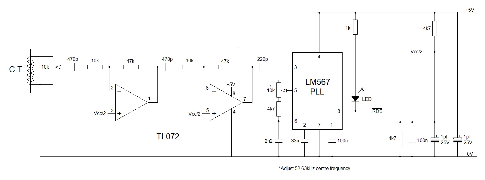

#15 Posted : 01 December 2024 23:58:28(UTC)
revmox
Joined: 26/05/2021(UTC)
Posts: 202
Here’s where I got to with RDS testing before stopping to think about a move to DCC. It’s an old school analogue approach to the problem.
MFX feedback frequency is 52.63kHz (4Mhz/57).
PLL components were selected for a capture BW of 12% for inputs >=200mV p-p at the PLL input pin, this is the nominal operating condition for the PLL. Measured BW in practice at roughly 7kHz. 10k trimpot is adjusted to centre the response – see below.
BW is narrower at lower levels with about 70mV p-p being the lower limit for locking for both sine and square waves, BW is a little over 2kHz at this level. The high pass preamplifiers give a lower lock limit of <5mV p-p at the reduced BW and the full 7kHz BW for inputs >10mV p-p.
High pass filtering is used to couple each stage with each set for an Fc of around 36kHz. Signal is not attenuated at 80kHz, about 2dB down at 52kHz, about 20dB at 10kHz. A much fancier filter could certainly be used but I find them unpredictable with transient waveforms. Pick up is by toroidal current transformer.
To align the detector circuit, if you don’t have a signal generator, you can use a UNO’s hardware timer 0 to generate a precise RDS carrier frequency. Use a couple of resistors to drop the signal to a useful level. Also, using a bridge, MOSFET and a resistor you can superimpose an RDS carrier signal on the Marklin track current for testing.
Chip datasheets and .ino here
https://mega.nz/folder/U...A#xyaaqkKX0ypSpaHtTKZENw
