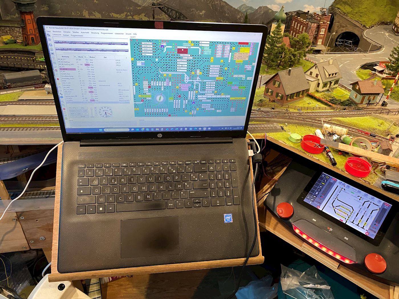

Here is my set-up (one PC with Rocrail, one CS3 and one RS232 Computer to drive the turntable.
