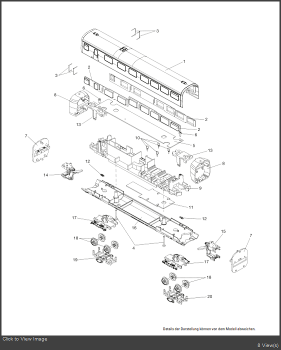

I have the 37604 and 43114 addon coaches. I would like to open the coaches to add people. I did remove 2 screws on the bottom side of the coaches but that did nothing, looks like the roof should come off but I am afraid to damage the coaches by prying to hard. Any suggestions would be appreciated!

Hi Bernd
My VT 11.5 is the Märklin 39605 (issued in 2002).
For sure the cars open by removing the 2 screws underneath between the 2 bogies and like the motor units separate in 2 parts BUT:
- often long sealed items remain glued because assembled while the pain was fresh
- be prepared to deal with the complex elongation mechanisms and fragile couplings
- have a camera ready to take detailed pictures so that if a part "flies" or if a wire breaks you will know how to repair it
- don't push too hard on the sides of the car as it will unglue the windows
Here is the exploded view diagram
