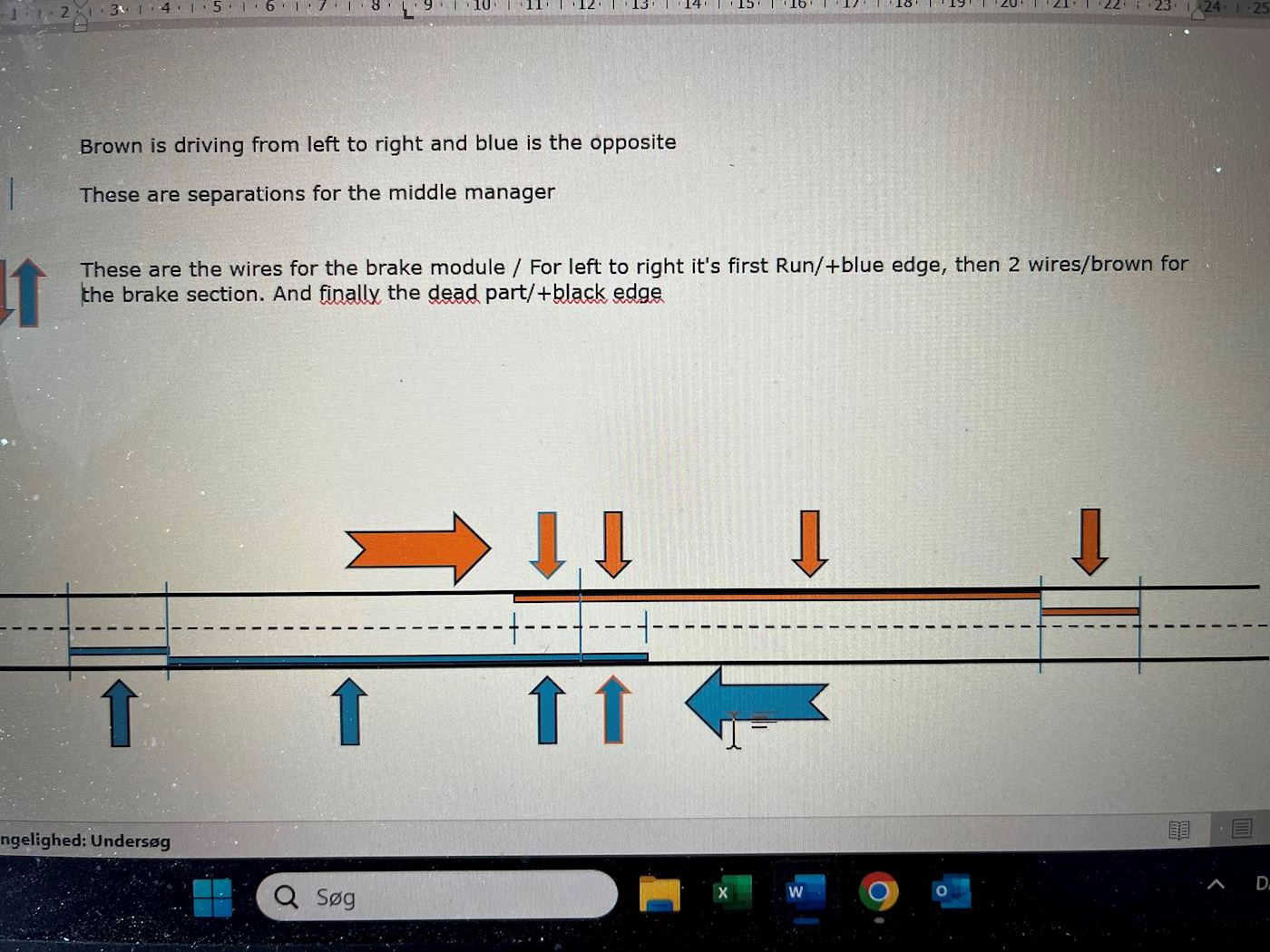

I am installing brake modules on 9 tracks distributed over 2 stations with a module at each end.
And here I am asking for "moral" support, as there are 2 tracks, that do not quite live up to an info. track (9cm) + the normal braking distance (90cm) + the dead rail (18cm) at both ends!
Then you see problems in me moving info. track forward in the direction of travel, the train group, which runs from left to right - and braking has been judged - saw that the locomotive first encounters info. the track, and afterwards runs over info. the track for the opposite direction (it is of course not activated), that track has instead become part of the deceleration. It is a Märklin AC, the locomotive is at the front with the drag shoe.
It will provide enough space for max. 90cm deceleration …..
There will be a drawing, that should show how.

I have promised drawing, but how to get a Word document in .....
So I had then a foto in stead, but now I have picture in my dashboard, but can't find the trick to post it.
Here is the picture, but it is for the Southern Hemisphere

#3 Posted : 22 May 2024 19:18:50(UTC)
Posts: 9,309
Is it 2 tracks you show up in the picture or just one with brake modules in both way?

Yes
It is just one track, with braking stop in both ends.
The whole story is for me to find a bit more length on a track, that isn't long enough for my regular setup where it's 90 / 900 / 180mm, and that's why I want to shift the registration track into the range for the opposite movement.
And basically the whole question, so I hope that someone will come with an input

#5 Posted : 02 June 2024 13:45:43(UTC)
Posts: 9,309
What i can see the rail does not work as brake module for the 3 rail locomotives.
It can only work via pick up shoes because it´s power feed that brake modules can work.
In the 2 rail system it is right or left rail (depends choice) as the power feed.

I assume that when a section with a brake module is not activated, it behaves like normal rails.
So when a locomotive runs from left to right (brown), part of the blue direction (which is not activated) is used, so that the short registration track for brown is an isolated part of blue's braking distance + brown's braking distance is also increased with blue's isolated recording track.
It's hard to explain, but it's even harder to do, as it turned out, that a platform is so stuck, that it will be destroyed, if I want to remove it!
So right now I am mostly inclined to reduce the braking distance from 900mm to approx. 800mm, and then when driving, find out if there are individual locomotives, that need to be reprogrammed.
Jørgen St. from Herning in DK
H0 / Märklin K track / CS3+ / full digital / Epoke III +/-
#7 Posted : 03 June 2024 09:26:50(UTC)
Right side up...

#8 Posted : 03 June 2024 09:44:56(UTC)
bygger01
Joined: 23/11/2008(UTC)
Posts: 230
Location: Herning in Denmark
Correct, but if you enlarged my picture is as your screen print.
So thank you for your help !
But how to get the drawing right from the beginning was beyond my abilities. I was just happy that something came in!!

#9 Posted : 03 June 2024 16:13:53(UTC)
bygger01
Posts: 230
There is also a 2nd option …..
Instead of having 1 registration rail for each direction, can I settle for 1 piece 90mm?
Again, the premise is that only one direction must be activated.
Or have I misunderstand something?

#10 Posted : 05 June 2024 17:13:46(UTC)
Posts: 9,309
I see a fault and you must feed power between two brake areas.

Thanks for your prompt reply.
A clear no sounds convincing, but I will still try to discuss a little for my last proposal!
My first assumption is that if the 3 section area is not affected then all 3 are normal rails.
If this is correct, then it is the brake module that is not involved in braking that will behave strangely when the common 90mm rail "sends" an impulse for braking in the opposite direction.
If it does, then you are definitely right.
Then you write that there must be "normal" digital power on the middle rail, and here you can say that that side has power from the other braking area, but it is not in operation.
I've just checked the rail that's in the middle, and it's a 900mm flex rail, so I can/will try the theory (here K rails are nice and easy to make isolated sections just by cutting the conductive part on the back), if it doesn't quite being punctured by You ….

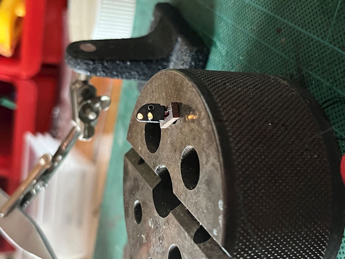

This is the home-made dwarf signal, that is supposed to be a track for freight trains.
It connects the brake modules and is illuminated with LED smd 0402, and they are inserted small pieces of 1.5mm brass tube.
The plate is laser cut 1 mm MDF plate
