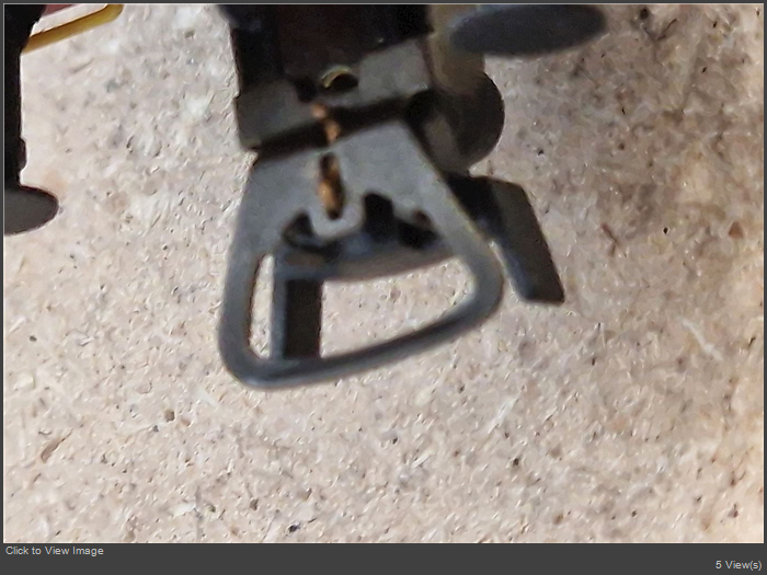

hi all,
i just got myself a piko 55913 loco, with automatic coupling functions. i have a marklin startup digital set, and as expected there is no couplers compatibility between the piko locomotive and the marklin loco & cars that came with the set. i have tried to read the forum about couplers, i got an idea but i greatly need advice here....what shoud i do ? probably it's best to change the marklin couplers, because i don't want to mess with the delicate automatic couplers of the piko loco... but what should i buy ? i have seen that the piko 56030 couplers "seem" to be the same as the ones in the piko 55913 loco, but i'm not sure, and i don't know if they can be mounted on a marklin digital startup set....
any hints ? thank you
Fab

they really don't seem to fit. i attach the pictures of the couplers, maybe that will help in understanding the matter and, moreover, what to do to solve it. the first 2 pics are the marklin car couplers, the other two are the piki loco electric couplers

I have no Piko loco but I know Märklin since the 60s.
From what I see your Piko loco is fitted with traditional Märklin coupling (the one used by Märklin from 1938 and 1988 and in this case with a solenoid-operated collapsing hook.
So all recent Märklin cars / Wagons made of plastic have 2 types:
- one with elongation mechanism and an NEM pocket --> replacement to old-style coupling is 72060 (an assortment of 10 couplings)
- the others with a fixed coupling vertical axle --> replacement to old-style coupling is 7205 (an assortment of 10 couplings for locos and 40 for cars)
Note: the KK coupling you show seems to have been modified
Here is a KK coupling (all identical but this one for old-style Märklin locos)
There is a little nose (circled in violett here) that you may bend a little to raise the buckle (one or 2 mm). Sometimes it helps getting a nice coupling with old-style Märklin couplers
After all the Marklin KK was designed to be compatible with the previous Märklin couplings (called Relex)
Relex coupling: here is one with a fitting for NEM 361 pockets

so, in the end, your suggestion is to get both the 72060 and the 7205, and see if they couple with the piko loco , keeping into account all the other considerations that you made ?
#6 Posted : 19 June 2024 13:30:27(UTC)
Posts: 3,627
Yes
