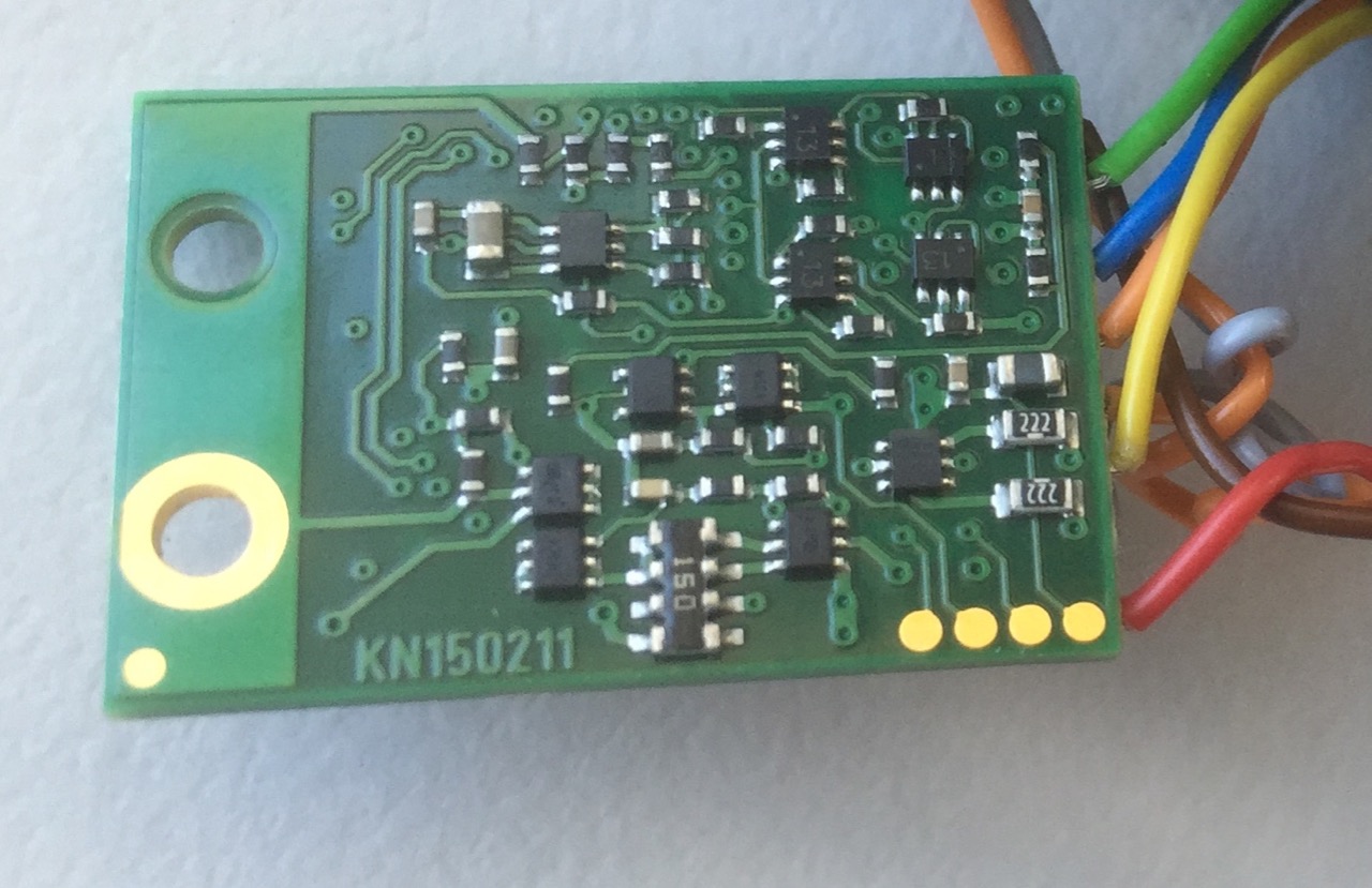

To wire this in I could connect it into the locomotive's existing fwd & reverse lamp circuits, or more ambitiously, consider adding it as a separate digitally controlled function. To achieve the latter I began investigating whether the digital control board provided with this simple engine may be capable of more than can be controlled using the very basic controller supplied with the set. I have an inkling it might and so may I ask my first request for assistance to those of you on the forum with considerably deeper knowledge of matters mfx/mm2. Could any of you identify the digital decoder board involved shown in the following images.
Top side, still mounted:
Bottom side, detached:
The board has the following code imprinted on the bottom surface: 'KN150211'. In particular I'm keen to obtain whatever technical information may be available regarding this decoder, and, in particular, what purpose the un-soldered connection pads might have. Are any of these pads related to functional control outputs and if so how are they configured - pull-up to supply voltage or pull down to Gnd?

Similar decoders from the TRAXX hobby locos have one function output with logic level (around 0 V when inactive, around 5 V when active, load should not exceed 2 mA, transistor needed to use it), one amplified output (open collector, pulling to ground, maximum load typically 250 mA, but since it is undocumented you cannot be too sure).
Here is a picture showing an older decoder:
http://www.web-hgh-moba....5-223-232-280_fx-txt.jpg
F3 is the amplified output (open collector), F1 is the logic level output. Maybe this helps to get you started in reverse engineering your decoder.
Maybe the starter set controller does not have access to F1 and F3.
#3 Posted : 07 February 2016 15:27:34(UTC)
Posts: 8,545
I would suggest the round pads on the bottom side are factory test points that get connected to by what are termed 'pogo pins' (spring loaded pins) to load software and configuration data into the microprocessor. The rectangular pads on the top side are the only ones I would consider connecting anything to, but I have no information on what the connections are.
I concur that the spot pads on the bottom are test points. Its the pads on the top surface that are of relevance as they all appear to be of the same dimensions as the ones wires are soldered to on the other edge.
Perhaps one approach may be to toggle the F1 through F4 functions on one of the more sophisticated Märklin or equivalent controllers while monitoring these pads with an oscilloscope, or even a basic multi-meter. I'm not yet in a position to do this but will try this approach when I get a DesktopStation system running.
